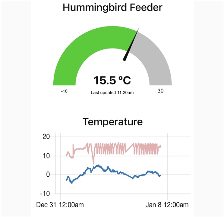

Most of the winter is mild, and by that I mean “cold but not freezing”; however, we do get snow and freezing temperatures, so it can be a challenge to keep the nectar from freezing at those times. I’ve been using USB-powered hand-warmers, controlled with bi-metal temperature switches, to automatically keep them warm. This generally works well, but the temperature can swing a fair bit.
As I didn’t fully trust the system, I’ve been using WiFi connected temperature sensors to track the feeder temperatures. To my happy surprise, the heating setup actually worked quite well, not only to keep the nectar from freezing, but also to not overheat the nectar.
feeder temperature chart
The blue line in the chart above is the outdoor temperature, and the pink line shows the nectar temperature - the nectar temperature varies a lot, but the thermostat is doing its job for the most part.
During our extreme cold snap last winter it also alerted me that the heater wouldn’t be able to keep up - something I was able to easily rectify by adding extra layers of bubblewrap insulation.

    I don’t think they are fussy about the temperature, as long as it’s not frozen (or weirdly too warm, I suppose?), but I was aiming for about 10 C, based mostly on spring and fall temperatures in my area. My goal was to keep it reasonably warm to avoid them having to deal with ice water shock in the mornings, and cool enough to avoid spoilage. The reason for the temperature range I’m getting is because the only real thermostat switches I could find anywhere close to my target temperature were the KSD9700 that are rated for 15 degrees C.
    In summer the nectar gets much warmer, so I imagine the precise temperature doesn’t matter too much. Most people around here seem to switch the feeders with ones kept in the house to keep them liquid, so that would be closer to 21 degrees, with much wilder temperature variations.
    Interesting that the article talks about potential shock for them drinking near-frozen nectar, so my current temperature range, even though not quite what I had planned, seems like a good safe way to avoid it.
    I’ve recently checked out a few other temperature switch ICs too, including TI’s TMP709, but a lot of these things are designed for automotive and computer temperatures, or for fridges and freezers, and are not great for my circa-10 range. I noticed a few other options recently that I could try, and in the last few days of research for this project I’ve seen some references to using a thermistor-based switch, so that might be a stretch goal for this challenge Slight smile
    For phasing back the temperature, do you mean for after-dark when the birds are sleeping, as a way to reduce energy use and avoid spoilage?

    Nice chart on the nectar temperature. For the most part the nectar stays in the 10C-15C range, is there a target nectar temperature the hummingbirds prefer ? I found this article on hummingbird nectar temperature https://birdgap.com/hummingbirds-drink-cold-nectar/   It might be helpful to keep the hummingbird nectar warm early in the morning and phase back the temperature setpoint a bit in the evening when they arent feeding.
