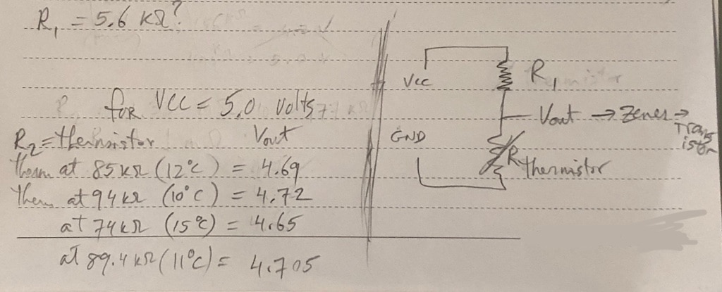

Here was the thought: I could use a voltage divider with the thermistor, just as we have done when using it as a temperature sensor for microcontrollers, but use the output to control a transistor. I could use the 5 volt input from a USB phone charger that runs the heater to also run the circuit that would control it.
The first tricky bit I ran into is that transistors don't seem to just turn on and off with a voltage threshold - they kind of fade on and off as the voltage goes up or down.
I thought I could solve that by using a zener diode.
By using a zener diode rated for 4.7 volts, I could choose my voltage divider bias resistor to match such that the Vout of the voltage divider would be under 4.7 volts (=OFF) for temperatures higher than, say, 15 degrees C, and over 4.7 volts (=ON) for lower temperatures - that could then be used to control the transistor to turn on and off the 5v USB-powered hand-warmer heater I'm using to keep my hummingbird feeder from freezing.
I used an online voltage divider calculator to figure out that I could use a roughly 5.6 kOhm resistor for the bias resistor, and it should work to get the correct voltages to control the transistor, and thus the heater. I'm using an LED as a simple test, and I realize that once I got it running I would likely need a second transistor to control the heater, rather than having this one power it directly.
Here is a picture of my notes... noticeably erased and rewritten several times over before I got it sort of right :D
It includes my theoretical circuit too.
my scribbles

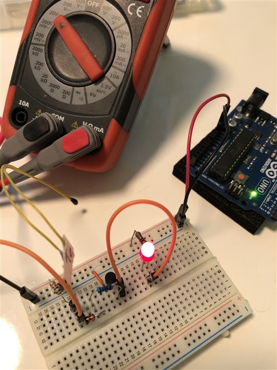

I then proceeded to build it on a little breadboard to try it out:
But when I turned it on...
Hmmm....
It's definitely not under 15 degrees in here :/
And touching the thermistor didn't turn it off either.
I then measured the input voltage going to the breadboard and I realized at least one of my assumptions was wrong: the input voltage is not exactly 5 volts. In fact, depending on which charger I use to power the board, it can vary from 5 volts to 5.2 volts. I think all of that is within the USB standard.
Checking the voltage divider calculator, I noticed that a small voltage change like that can have a huge impact on the trigger point of the circuit. Sigh.
It's very possible I messed up something in the way I built the circuit, but it does seem to be very sensitive to input voltage, regardless of whether that's an issue.
So then I guess I have a few options - I could possibly use a 3.3v regulator to power the voltage divider circuit, but then I'd have to use a different zener diode. I'm not sure if that would work, but it will definitely add more complexity to the circuit.
The other option is that I've noticed people using OpAmps for this kind of control circuit, which I think takes care of issues with voltage fluctuations, but I'm not sure.

  • scottiebabe
    scottiebabe over 4 years ago +1
    Using the thermistor in a bridge configuration make life easy! For some critical temperature you either look up or calculate the thermistors resistance. Then create a second voltage divider using that…

  • scottiebabe
    scottiebabe over 4 years ago in reply to ntewinkel
    That is exactly how it works! This is exciting news its fun to try new things. Just watch out for some of the old dinosaurs like the https://electronics.stackexchange.com/questions/304521/reasons-not-to-use-a-741-op-amp which wouldn't work on a 5V power supply.

    ntewinkel over 4 years ago in reply to scottiebabe
    Ooh! Thank you!
    So if I understand it correctly, that second voltage divider gives us a V-out to compare to, regardless of the input temperature.
    I'm absolutely totally new to op-amps and comparators. I've seen them before and I think I even have some op-amps in my set of chips here, so it might be time to learn more about them Slight smile

  • scottiebabe
    Using the thermistor in a bridge configuration make life easy! For some critical temperature you either look up or calculate the thermistors resistance. Then create a second voltage divider using that fixed value.
    The polarity of the bridge output will switch at the critical temperature regardless of the magnitude of the supply voltage.
    Then with an op-amp with a little positive feedback for hysteresis you have a solid-state thermal switch. Yay!
