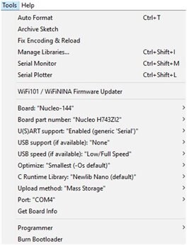

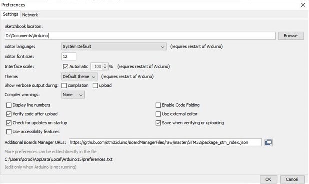

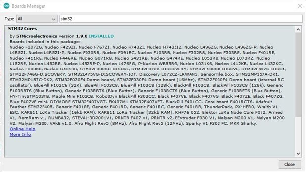

The first thing I had to do was update the board to handle the STM32 boards.
For doing this all I did was  I went to -->File--->Preferences-->Select Additional Board manager
Then entered the following into the Additional Boards Manager URLs:
https://github.com/stm32duino/BoardManagerFiles/raw/master/STM32/package_stm_index.json
Click OK and then go to Tools--->Board--->Board Manager
Search for STM32 Cores and install
Then you should be able to select your board I am using a NUCLEO-H743ZI2 So I selected NUCLEO-144 AND then my board Part number: NUCLEO H743ZI2

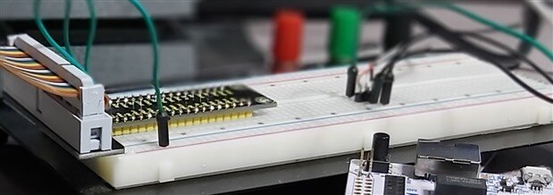

When it came to the wiring of the unit I just soldered it  onto a male header pin and put it into a breadboard so that I could just run my wires where I needed them to go without any issues just in case I wanted to move or adjust anything going forward.
Pin 1 connect to 5v
Pin 2 Connect to A0
Pin 3 connect to Ground
KEMET SENSOR
PIN 1 = VIN  = Power input        = Red
Pin 2 = Vout = Sensor Output   = White
Pin 3 = GND  = Ground             = Black

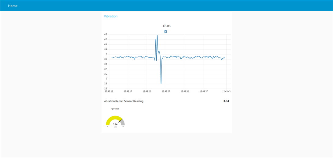

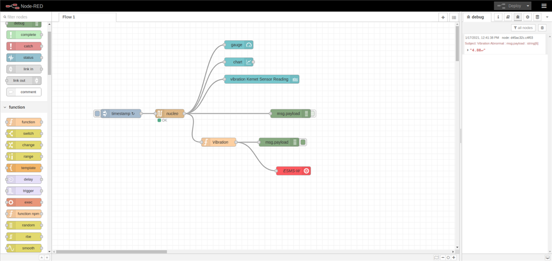

So now that I had it all working it was time to head over to the Raspberry Pi, to use another program I have not used for many things but thought I would give it a shot again due to the flexibility I would have in the long run and being able to share what I have done and so that others could use either other vibration sensors and even use a Arduino UNO and create their own unit at a fraction of the cost of using the ST board and Kemet sensor.
We are going to be using Node-Red which you can get from https://nodered.org/  I think its a pretty sweet setup and have come to really enjoy the program.   On the Raspberry Pi make sure to check your version I think I actually had to upgrade mine as the version in the raspberry pi repo was out of date.

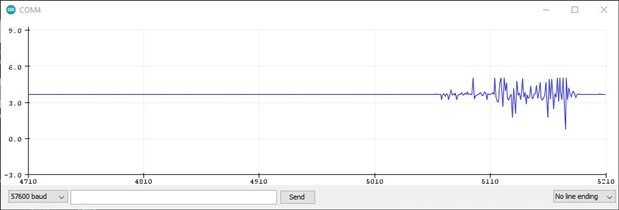

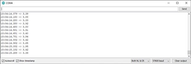

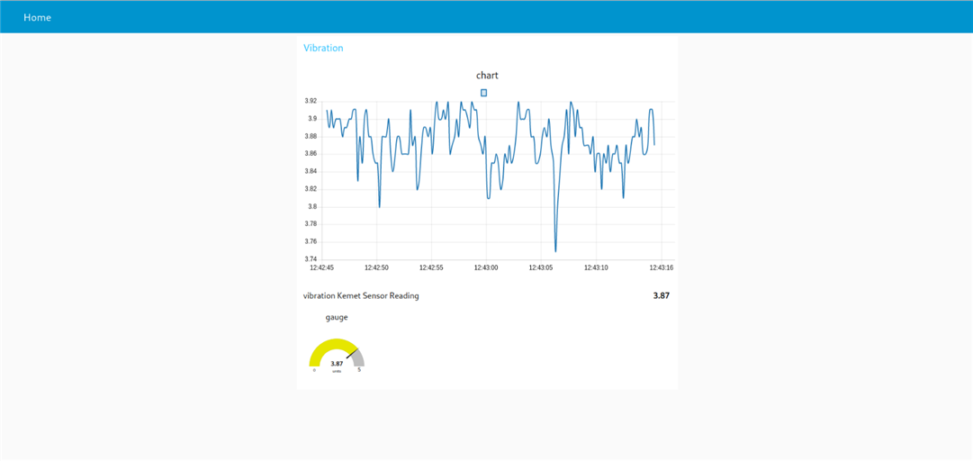

On the Raspberry Pi we needed to set a few things the timestamp was set to .20 Seconds   the Nucleo on the serial node was set to the settings we put in our arduino code which then we could output the data to a gauge, chart, or text reading perfect!
Output of the sensor when no vibration is detected....it may have been picking up noise from the multiple raspberry pi's I had on my desk at the time as well.  But this allowed us to keep track of the unit and find out a good base line roughly where the normal values would be.
As you can see here when the sensor is knocked or shaken it outputs a higher reading and even a lower....we want to try to use both of those upper and lower readings as triggers

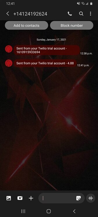

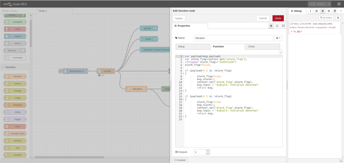

Now I am not so good at this but I just wanted to list the abnormal reading and set the alarm for it and test if it would work and yes it seems to be working posting a 4.88 reading which is above the abnormal reading.  Now I was having a issue as I set the reading for normal reading to be between the two reading so 3.6 to 4.1 and I was getting a constant output which then was putting too much data out into the part that I wanted to concentrate on and that was using Twilio as my method of notification.  You can sign up for a free account and get some credits which makes it nice and easy to get your projects going.  But when I did I had a mass amount of text messages coming in as I was sending all values to the output which, like I said I am not the greatest when it comes to any of this and have tons to learn.  After using node red on this project I certainly will be playing with it a lot more as I have found just how versatile and helpful it can be in quickly prototyping a device.  And your able to host your own dashboard which then in turn you can self host all your projects and still be able to access it anywhere.
If you would like to try Twilio out you can check it out here and its a referral link so you would be helping me get some extra credits as well.  www.twilio.com/referral/lYh8Bd
you can import the following into node red to get a more hands on view of everything (Twilio info was removed from code you will have to setup your own)

        "id": "2f5f4fea.f0b49",
        "type": "function",
        "z": "85973545.a09aa8",
        "name": "Vibration",
        "func": "var payload=msg.payload;\nvar alarm_flag=context.get(\"alarm_flag\");\nif(typeof alarm_flag==\"undefined\")\nalarm_flag=false;\n\nif (payload>4.2 && !alarm_flag)\n{\n        alarm_flag=true;\n        msg.alarm=1;\n        context.set(\"alarm_flag\",alarm_flag);\n        msg.topic = \"Subject: Vibration Abnormal\"\n        return msg;\n}\n\nif (payload<3.5 && !alarm_flag)\n{\n        alarm_flag=true;\n        msg.alarm=1;\n        context.set(\"alarm_flag\",alarm_flag);\n        msg.topic = \"Subject: Vibration Abnormal\"\n        return msg;\n}\n",
        "outputs": 1,
        "noerr": 0,
        "initialize": "",
        "finalize": "",
        "x": 580,
        "y": 420,
        "wires": [
                "d45ac32c.c4f03",
                "46cb34b6.99722c"

So when it comes down to it we need to finally see if it works well lets have a look at my phone capture and see what actually appeared.
I had to remove a few of the messages from before when there was a mass text to my phone from it but as you can see the 4.88 warning of vibration this is a quite aggressive measurement in my books which would be consistent with a convulsive seizure.  Now there is way more that I can do and will be playing around with as I am quite enjoying Node-Red.  I still need to have it take multiple high readings and make that the trigger and then a duration trigger as anything over 4 minutes one would probably want to have EMS on scene in my research that is which we can send another notification stating the duration time of each seizure.

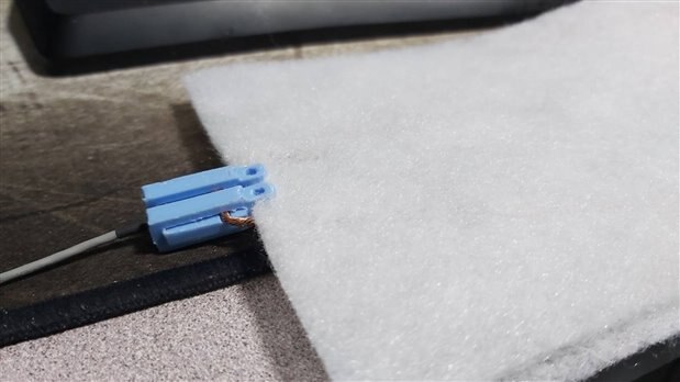

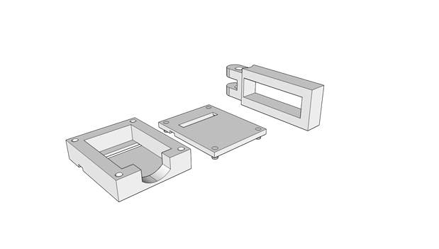

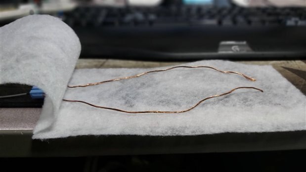

I also decide I would make a case which I could then attach some more wires to as a quick back yard approach at making my own sensor pad which would work on a recliner chair and on a hospital bed mattress.
Nobody said it had to be pretty.
So originally it was suppose to have a top case as well but found the brackets where enough to hold it in.
But I couldn't find thin enough wire and a chunk of foam that I was wanting to use as the base and thread it through multiple times.  This would just have to do which in the end it worked and I was happy with the result I was able to put it under a mattress and cause it to react and send a message.  Now depending on the mattress it might have to be placed on top on a chair it would be fun to make a thin cushion to house the unit.
