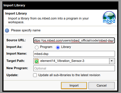

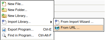

Right-click your project and import a library from a URL.
Enter the official mbed-dsp library:
https://os.mbed.com/users/mbed_official/code/mbed-dsp/

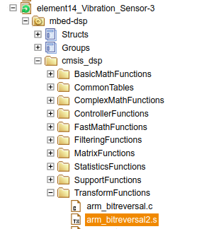

If you try to compile now, you will get an error because the online Mbed compiler does not support building of assembly files (files with the .S extension). Building assembly files are only supported if you compile locally on your PC.
For the sake of convenience (to keep the entire workflow on the cloud compiler), we will replace the assembly with C source codes. Take note that this results in some performance loss as ARM has created the assembly version to optimise for speed. But for our experiment the speed is not an issue.
Go to the directory mbed-dsp/cmsis_dsp/TransformFunctions/, and replace arm_bitreversal2.S (the assembly version) with arm_bitreversal2.c (the C version).
Delete arm_bitreversal2.S first. Then create a new file arm_bitreversal2.c and use the source code for arm_bitreversal2.c from here.
The project should be able to compile now

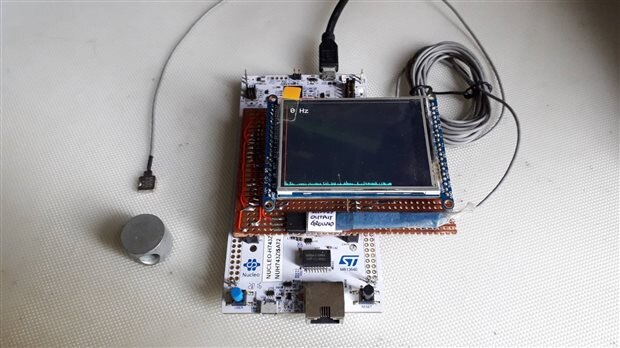

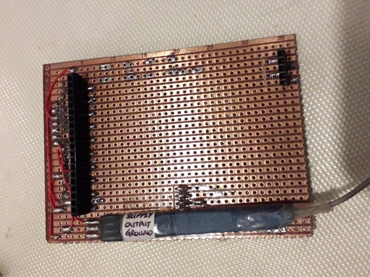

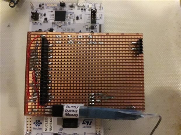

I went a step further by adding a TFT LCD display. I used the Adafruit 2.8" TFT LCD module. It essentially displays a live graph on the display.
I won’t be explaining in detail here, but I have published documentations and pinouts on my Github page as well.
  • https://github.com/zst123/Element14_Vibration-Sensor-Experiments/blob/master/Experiment4/Mbed-FFT-Dashboard/
{gallery} My Gallery Title
Final Setup: The LCD sheld with vibration sensor and a piece of metal to serve as a weight
Soldered on shield: The LCD shield I made myself with a stripboard

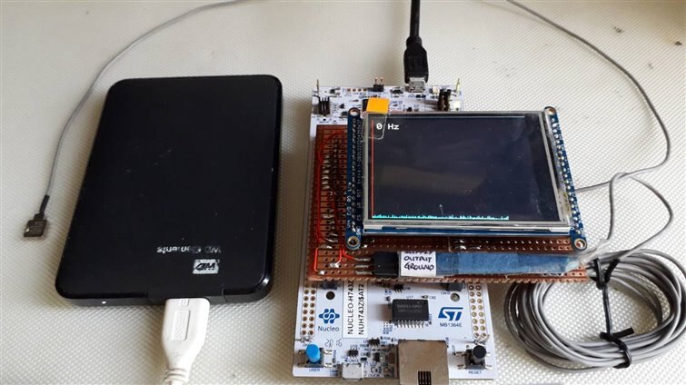

Hard disk test on my 5400rpm external hard disk.
A video showing different positions of the hard disk being sensed.
It is noted that the best results are to put the sensor off-center. At the center, the results are not as defined and in this case, there are harmonics being seen too. The wrong placement can distort your results, be very careful!

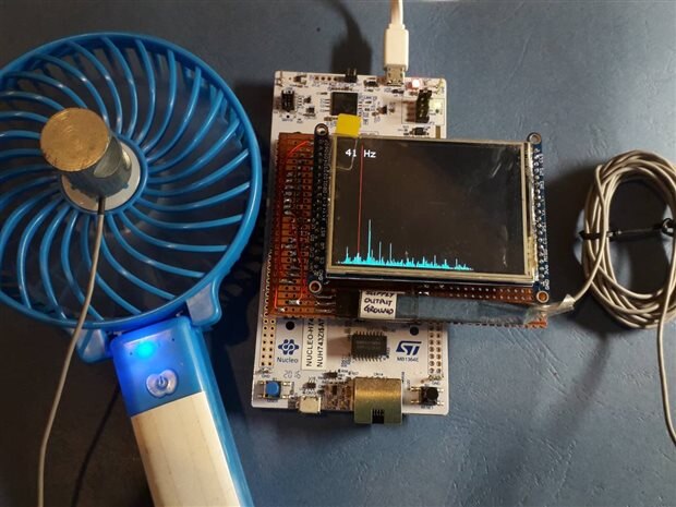

Handheld fan test which shows the result at 41 Hz (low speed setting)
