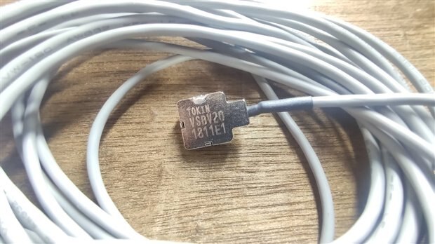

The Sensor

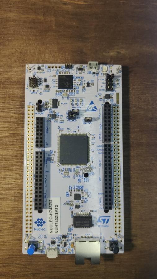

The Nucleo board

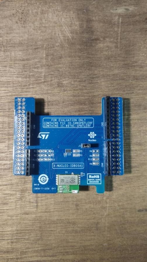

The Bluetooth Board

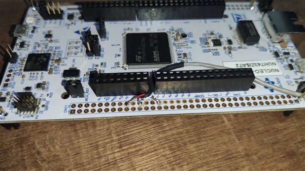

The first thing it was to remove the connector and solder the wires to the board, specifically in this way:
Black to Ground.
Red to 5V.
White to PA0.

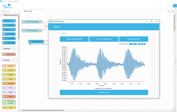

Then I installed the software SMT32CubeMonitor and STM32CubeIDE.
I flashed an example for ADC reading, also a minimal configuration for the STM32CubeMonitor.
Then I put the sensor in the top of my smartphone and using a vibration app I got his readings.

The sensor is small but robust, the Nucleo board was really helpful to did a quick test.
I have to work with the ADC reading to have the best performance with this specific sensor.
Also, I have to check if the flash memory could be enough for a full test or maybe I would have to add an external memory.
First impression, the sensor is expensive but it's small, robust and it has great specifications.
