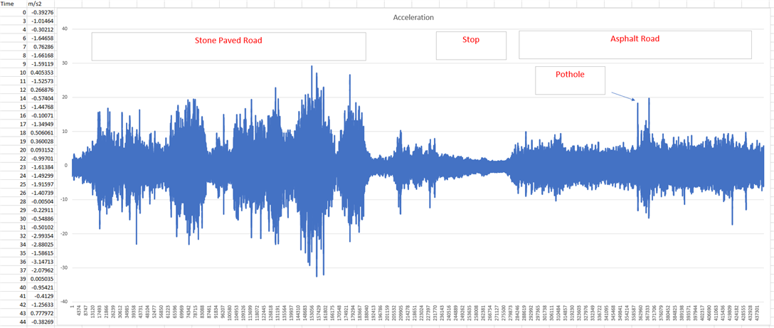

Car test
The first real test in the field it was in my personal car, I attached the sensor to and ECU that is under the steering wheel. The sensor Z axis was in alignment with the earth's gravity.
In the picture above we can see three sections, the first one is on a stone paved road, there's a lot of vibration with high acceleration, with a peak of   29.19ms2 and     −32.56ms2
Then I made an stop when the vehicle almost reached the noise floor of the sensor. After that, I was driving on an asphalt road, in this section we can see that there's less acceleration. But in certain moment, I hit a pothole and we can see it with a initial peak of     18.28ms2   and the another peak of     19.72ms2 , I guess the first peak was when the tire enter in the pothole and the second one when it leaves the pothole.

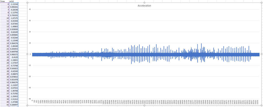

Autonomous vehicle test
Before the lab was closed due to covid, I was able to save a log. In the next picture we can see the results. The sensor was attached to one of the ECUs that I designed. In this case, the sensor Z axis was in alignment with the earth's gravity too, but the ECU components are in the X axis, so, is required to do more measurements in this axis. I adjusted the Y axis of the chart to have the same that the first chart, in this way we can see that in this test we have a much less acceleration, with similar values as the ones from the asphalt road, but with smaller frequency.
With this initial results, we can say that the vibration is less in the autonomous vehicle (smaller acceleration and smaller frequency). But this data is not enough to conclude that the ECUs will survive in this environment.

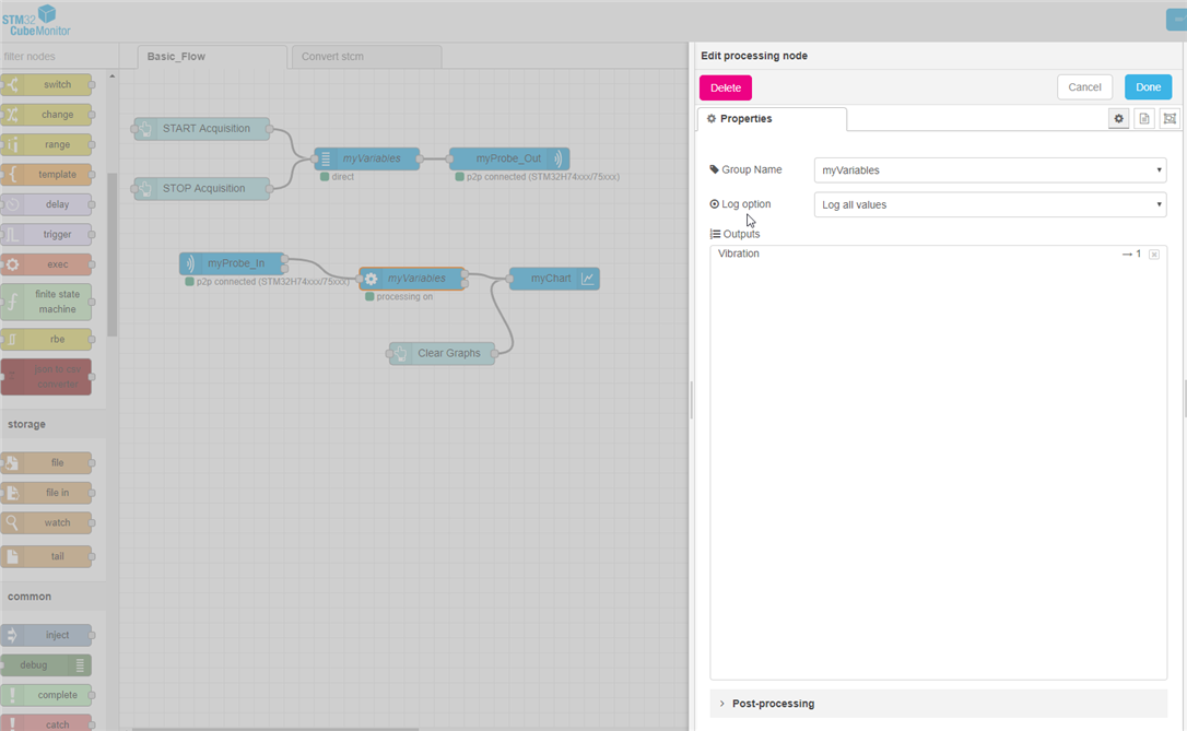

The log
STM32Cubemonitor can show us the variable result in a nice chart, but we can log this data in our computer, we only have to enable the log option

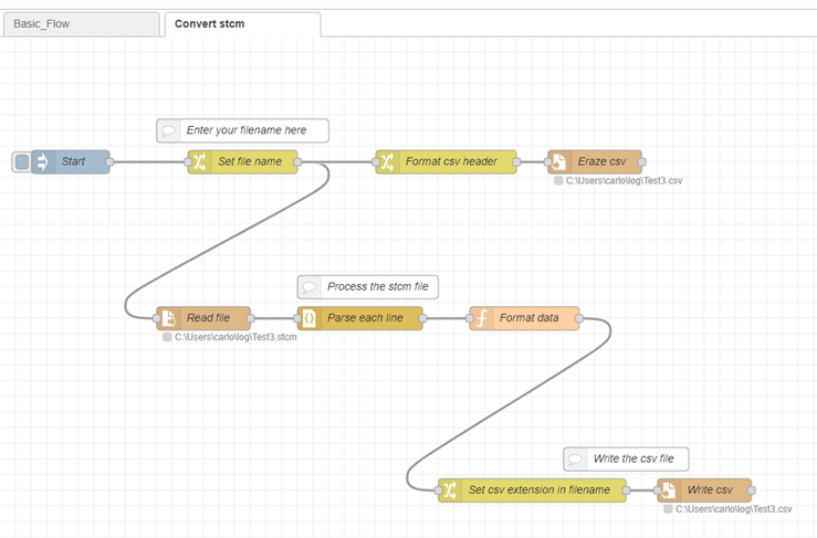

This will save the log in a weird file ".stcm", basically this is a json file. So to be able to see the data we have to convert it using this flow.
  1. [{"id":"cc0c8ae8.c69f98","type":"tab","label":"Convert stcm","disabled":false,"info":"This flow is used to convert stcm file in csv file\n\nThe file name must be entered in the \"set file name\" node\n\nThe csv output format is variable Name, x, y\nNote : the data may be processed by group, so the x value may not be in time order. The csv file may be sorted on the x value to ensure order coherency. "},{"id":"a9caceb2.eb94d","type":"file in","z":"cc0c8ae8.c69f98","name":"Read file","filename":"","format":"lines","chunk":false,"sendError":false,"encoding":"none","x":280,"y":360,"wires":[["99d027a1.b92d98"]]},{"id":"9350e2b8.9aa3e","type":"inject","z":"cc0c8ae8.c69f98","name":"Start","topic":"","payload":"","payloadType":"date","repeat":"","crontab":"","once":false,"onceDelay":0.1,"x":110,"y":160,"wires":[["3371f5e6.b3b50a"]]},{"id":"99d027a1.b92d98","type":"json","z":"cc0c8ae8.c69f98","name":"Parse each line","property":"payload","action":"","pretty":false,"x":480,"y":360,"wires":[["badf8efa.bacee"]]},{"id":"badf8efa.bacee","type":"function","z":"cc0c8ae8.c69f98","name":"Format data","func":"let output=\"\";\nmsg.payload.variabledata.forEach (data=>output=output+ msg.payload.variablename+ \",\"+ data.x + \",\"+ data.y+\"\\n\");\nmsg.payload= output;\nreturn msg;","outputs":1,"noerr":0,"x":690,"y":360,"wires":[["38fb106e.c00f"]]},{"id":"d2859af6.e93368","type":"file","z":"cc0c8ae8.c69f98","name":"Write csv","filename":"","appendNewline":false,"createDir":false,"overwriteFile":"false","encoding":"none","x":920,"y":580,"wires":[[]]},{"id":"3371f5e6.b3b50a","type":"change","z":"cc0c8ae8.c69f98","name":"Set file name","rules":[{"t":"set","p":"filename","pt":"msg","to":"C:\\GIT\\test\\test3.stcm","tot":"str"}],"action":"","property":"","from":"","to":"","reg":false,"x":330,"y":160,"wires":[["a9caceb2.eb94d","593d0b11.8d3654"]]},{"id":"f3d3a57a.c56e48","type":"comment","z":"cc0c8ae8.c69f98","name":"Enter your filename here","info":"","x":330,"y":120,"wires":[]},{"id":"38fb106e.c00f","type":"change","z":"cc0c8ae8.c69f98","name":"Set csv extension in filename","rules":[{"t":"change","p":"filename","pt":"msg","from":"stcm","fromt":"str","to":"csv","tot":"str"}],"action":"","property":"","from":"","to":"","reg":false,"x":700,"y":580,"wires":[["d2859af6.e93368"]]},{"id":"b1ba9fe.177b06","type":"file","z":"cc0c8ae8.c69f98","name":"Eraze csv","filename":"","appendNewline":true,"createDir":false,"overwriteFile":"true","encoding":"none","x":780,"y":160,"wires":[[]]},{"id":"593d0b11.8d3654","type":"change","z":"cc0c8ae8.c69f98","name":"Format csv header ","rules":[{"t":"change","p":"filename","pt":"msg","from":"stcm","fromt":"str","to":"csv","tot":"str"},{"t":"set","p":"payload","pt":"msg","to":"Variable, x, y","tot":"str"}],"action":"","property":"","from":"","to":"","reg":false,"x":590,"y":160,"wires":[["b1ba9fe.177b06"]]},{"id":"796c6b18.2aab34","type":"comment","z":"cc0c8ae8.c69f98","name":"Process the stcm file","info":"","x":490,"y":320,"wires":[]},{"id":"c2ec88a.7368678","type":"comment","z":"cc0c8ae8.c69f98","name":"Write the csv file","info":"","x":820,"y":540,"wires":[]}]
I took this from this site.
To use it, go to menu import , copy paste the text, and select "new flow".
Then for each conversion :
1) in the box "Set file name", enter the name of file to convert (absolute path + extension : "C:\log\test1.stcm")
2) press start. The file will be processed and stored with the csv extension.
