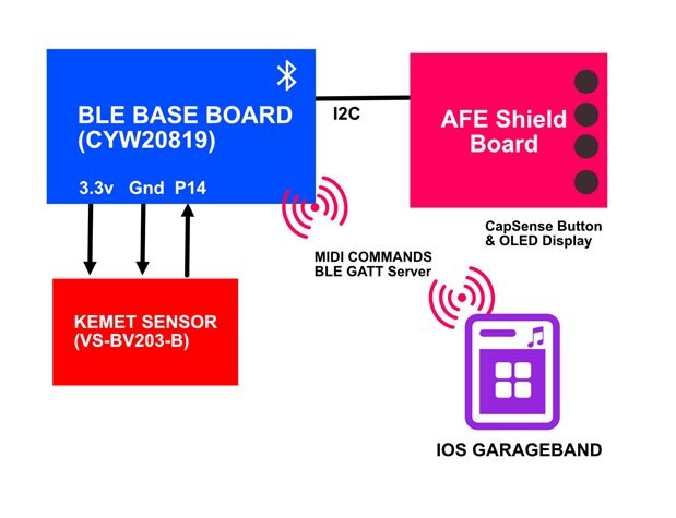

Blocks:
This blocks shows the overall concepts of this KEMET Music Pad,
Hardware:image

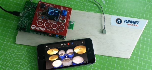

I have used two boards here,
1. CYW920819 EVB- 02 Kit
2. CY8CKIT 032 PSoC Analog Front End Shield

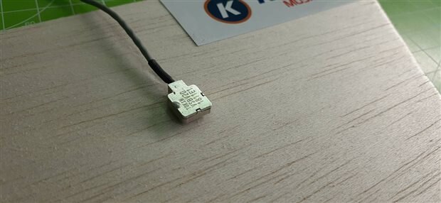

and the sensor from KEMET VS-BV203-B
The Sensor is interfaced to the CYW920819 Kit to Pin P14 with power supply 3.3v,  Also its attached to the wooden sheet/surface.
PSoC AFE board is fitted into the BLE base board's Arduino connector. The AFE process the CapSense sensing and proximity for
user interface. The OLED display displays the active instruments Group and selected hand key. The BLE base board communicate with
AFE through I2C interface.
Note1 : Hand key is something which holds the midi value of instruments. Two values we can store for users two hands.
Note2: Instruments Group is predefined midi value for capsense buttons. (4 values in group)
Software:
The BLE baseboard has the implementation of BLE GATT Server with custom service for sending MIDI data over Bluetooth. To know more details about
MIDI frame format check here. AFE data is read using periodic timer and Vibration sensor is captured with GPIO interrupt and converted into pulse count.
Based on the pulse count the velocity of the music is adjusted. Not used any FFT approach here to make it very simple.
Example: Simple MIDI Frame
[Header][Timestamp][status][midi data][midi velocity]
0x80,0x80,0x01,0x34,0x48

How it works:
There is two working mode, Mode 1 we can operate this without Vibration sensor , just tap on the CapSense button to product the music.
Another mode is with vibration sensor. In this mode2 we use CapSense proximity to detect the hands which is closer to the music kit.
As per the Note1 two hand keys are handled with two hands. The CapSense buttons is ask as music picker , we can pick any of two music for
two hands on the queue order. When user hits the surface, the baseboard sends the midi command over BLE. Thease midi commands are
captured by the Apple IOS Garageband app and its play it on the mobile. In order to keep the BLE connection active its mandatory to use
connection interval between 10 to 15ms.
The source code of this project will be found here
Checkout the working video demo here and leave your thoughts.
