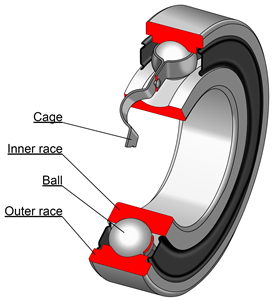

Machine vibration analysis is used in predictive maintenance to check machinery health and predict their failure. When performed regularly (or continuously) machine faults can be detected in their early stages and appropriate action can be taken to avoid machine failure or in the opposite end, replacing parts that are still in good condition (preventive maintenance).
Rotating machines generate vibration that can be analyzed to asses the general condition of machines and the remaining life of their parts. Vibration signature analysis can detect faults such as bearing faults, unbalance, misalignment and gear faults.
Bearings contain 4 elements that can deteriorate with the usage: the inner and outer race, the balls and the cage. Each of these elements generates a characteristic vibration frequency when faulty, making it in this way possible to identify the fault by just by analyzing the vibration signature.
[Derivative work of Wikipedia image by Silberwolf / BY-SA 3.0]
The 4 characteristic frequencies are:
  • BPFO (Ball Pass Frequency Outer): Number of balls or rollers that pass through a given point of the outer race each time the shaft makes a complete turn.
  • BPFI (Ball Pass Frequency Inner): Number of balls or rollers that pass through a given point of the inner race each time the shaft makes a complete turn.
  • BSF (Ball Spin Frequency): Number of turns that a bearing ball or roller makes each time the shaft makes a complete turn.
  • FTF (Fundamental Train Frequency): Number of turns that makes the bearing cage each time the shaft makes a complete turn.
The exact frequencies depend on the physical properties of the bearings, such as the dimensions and the number of balls or rollers.

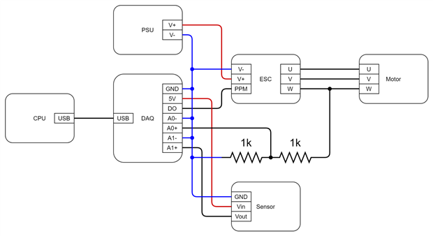

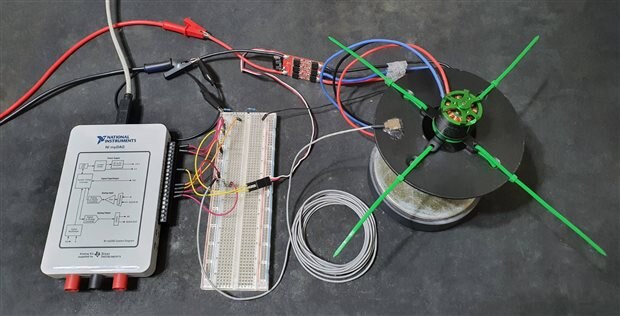

The setup was made of 5 components: A piezo-accelerometer/vibration sensor, a brushless DC motor (BLDC), an electronic speed control (ESC), a power supply (PSU), a data acquisition device (DAQ) and a computer.
The CPU controls the motor speed by setting the PSU voltage (from 6 to 16 V) and by controlling the ESC through a throttle PPM signal. The DAQ measures 2 signals, a vibration signal from the sensor and the voltage signal from a motor phase (which is used to compute the motor rotational frequency).
The physical setup was far from ideal, but good enough to experiment with, in a "real" setup much more care would have to be taken with the cabling and connections to avoid noise from leaking in. Due to the fast acceleration of the motor I had to attach it to a more rigid structure to avoid having it spin around the bench. The small size of the motor made it hard to attach the sensor directly to it, so I ended up attaching it to the structure to which the motor was tied to (this again was not ideal as the plastic cable ties dampen the motor vibration).
The DAQ (NI myDAQ) supports a max sampling frequency of 200 ksps @16 bit in the range of ±10 V, so I had to voltage divide the motor phase signal.

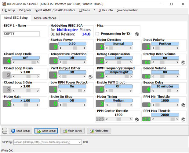

I reprogrammed the ESC with the BLHeli firmware and disabled its PID control loop and set the min and max PPM throttle values to 1000 and 2000 ms respectively (so that it would be easier to fine control its speed).
To test that all connections were properly set and that the motor was properly tightened, I performed a linear acceleration/deacceleration test:

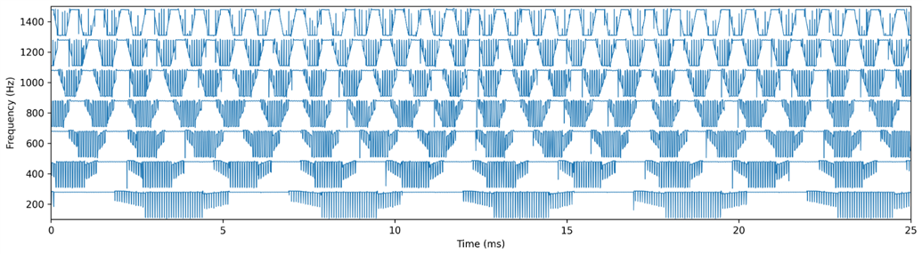

The motor rotations were tracked by measuring the divided voltage signal of a single motor phase. The brushless motor that I used rotates one time for every 7 electrical cycles (the number of electrical cycles/rotations equals the rotor pole pairs). The processing of the signal was not trivial as the "form" the cycles depend on the frequency.
Due to the irregularity of the signal, simple approaches to track rotations such as identifying blocks without voltage "spikes" did not work. I implemented the rotation tracking algorithm as a sequence of the following operations:
  1. A high time resolution, low frequency resolution spectrogram is computed from the original signal.
  2. The main frequency at each segment of the spectrogram is computed and then interpolated at every time unit of the original signal.
  3. A filter bank of 5 bands ([100; 312.5], [312.5; 625], [625; 1250], [1250; 2500] and  [2500; 5000] Hz) is created (the selected range includes up to the third harmonic of the signal).
  4. The filter bank is applied to the original signal to generate 5 filtered signals.
  5. The 5 filtered signals are linearly combined at each time unit based on the computed main frequency at each time unit.
  6. The linearly combined signal is used to detect all zero crossings with a negative derivative.
  7. Zero crossings were the signal amplitude is below a certain threshold are discarded.

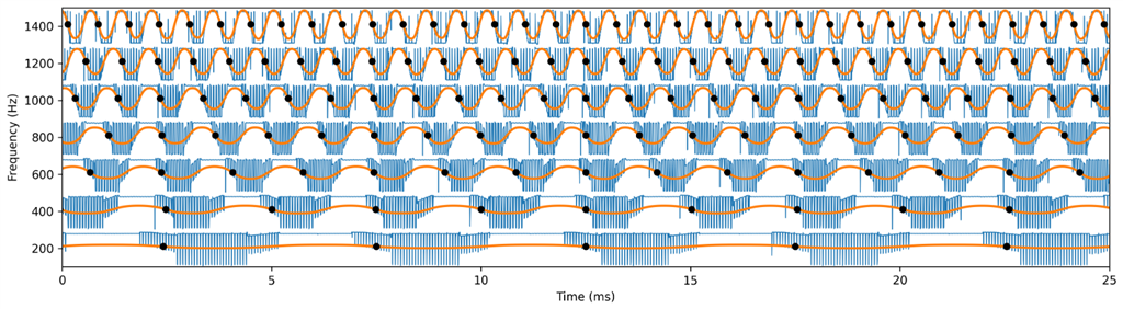

The next image shows the algorithm applied to the previous signal segments, the orange signal is the linearly combined signal and the dots are the negative derivative zero crossings:

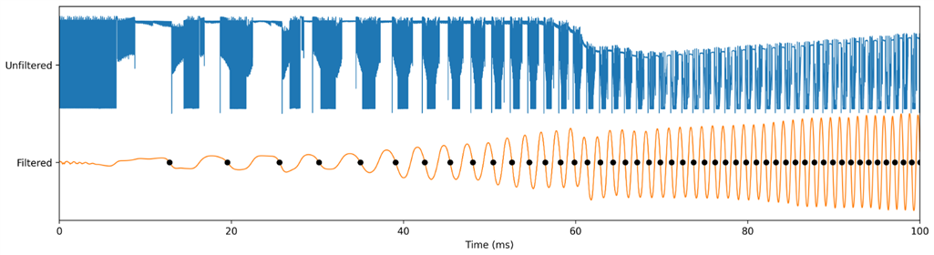

The filter operates as a variable frequency lowpass filter that adapts to the signal main oscillation frequency. The next image shows how it adapts to a fast accelerating signal.

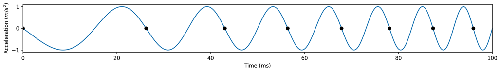

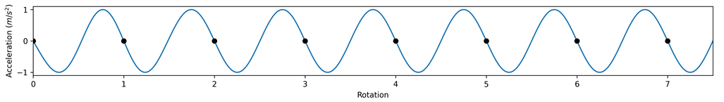

The next synthetic time series shows an acceleration from 25 to 175 Hz of an unbalanced system (black points are used as a visual aid to separate rotations):
Through order tracking, the previous time series gets converted from the time domain to the rotation domain:

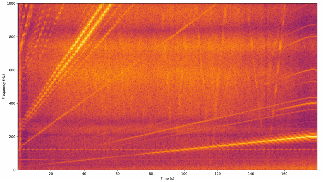

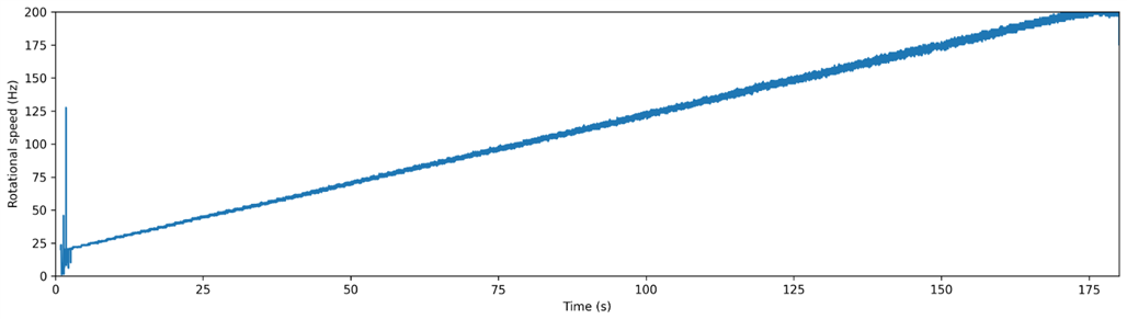

To identify which vibration components are asynchronous and which are synchronous I performed a relatively linear ~180 s sweep from ~20 Hz to ~200 Hz. The sweep highlights which spectrum components are affected by the shaft rotational frequency, and which are not, but it also helps with identifying synchronous components that could get damped at certain frequencies.
Through rotational tracking I measured the rotational frequency curve.
The sweep generated the next vibration frequency domain spectrogram.

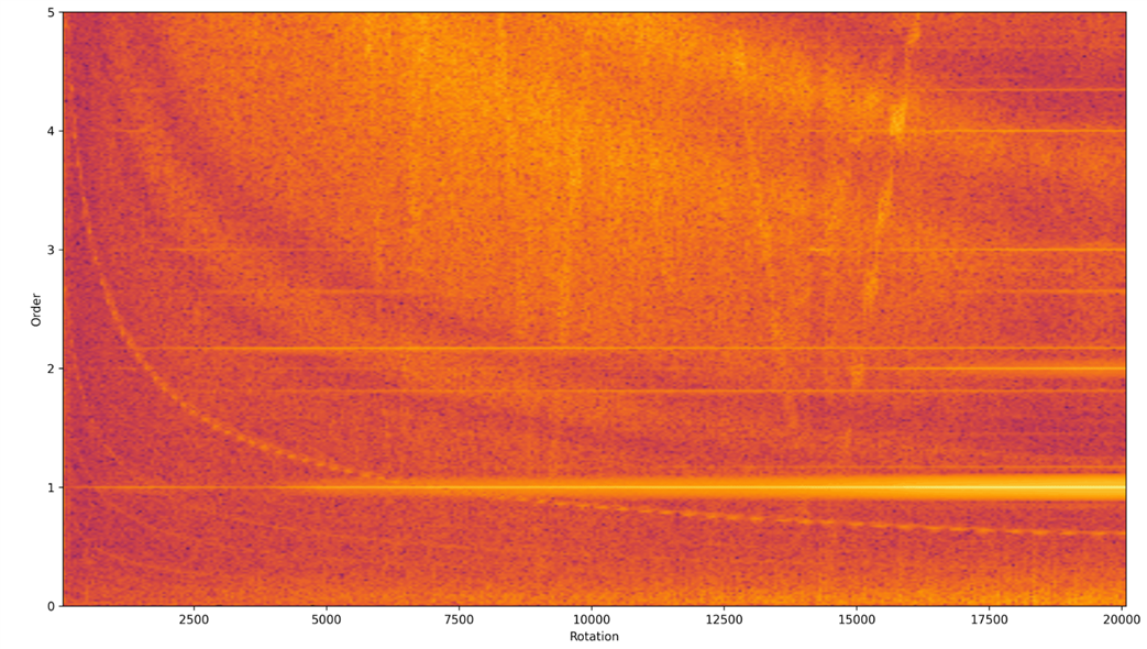

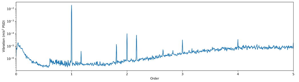

The spectrogram shows asynchronous components as horizontal lines, and synchronous components as diagonal lines that scale with the rotational frequency by a constant factor (order). By computing the spectrogram of the order tracked signal, the synchronous components order frequency can be easily identified.
In contrast to the vibration frequency domain spectrogram, in the vibration order frequency domain, the synchronous components are shown as horizontal lines and the asynchronous components as decreasing curves.

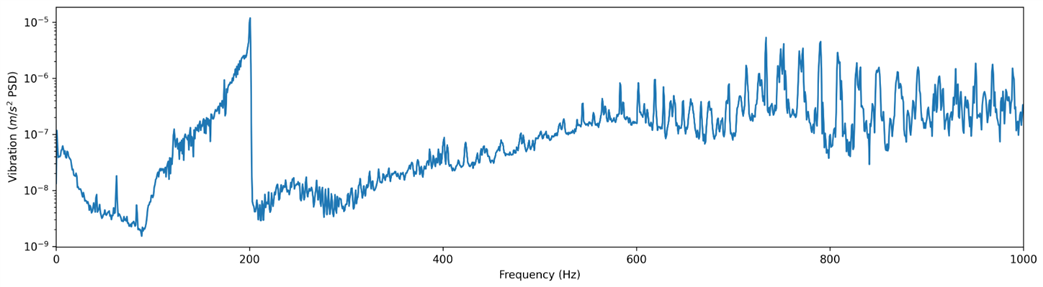

The computation of the spectrum of the complete sweep highlights the components that stay constant in each domain, asynchronous in the frequency domain, and synchronous  in the order domain.
Vibrations generated by bearings tend not to be in the frequency of the shaft rotation harmonics. The order spectrum shows a few frequency components that were likely generated by the bearings, but without the specification of the bearings I was not able to identify the bearing  element faults. The motor that I used was new and its bearings were supposed to be of good quality, so it appears that the system is capable of detecting faults in the very early stages.

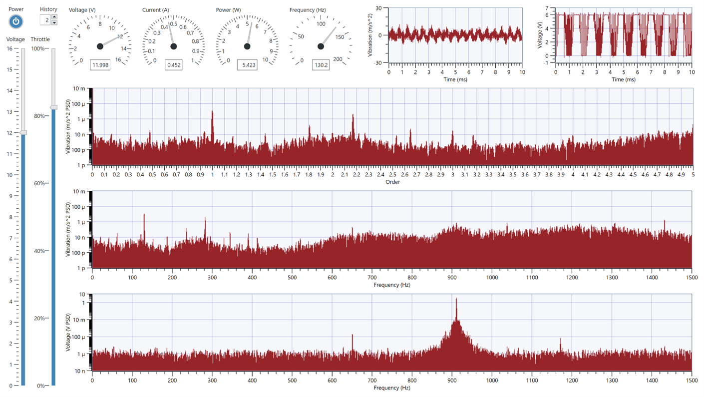

4.2 Real-time Dashboard

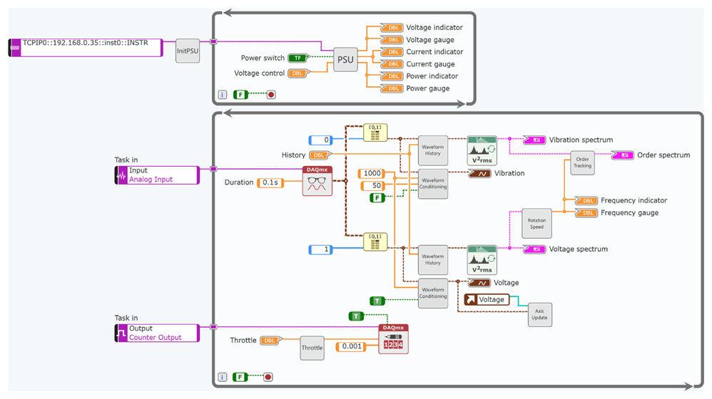

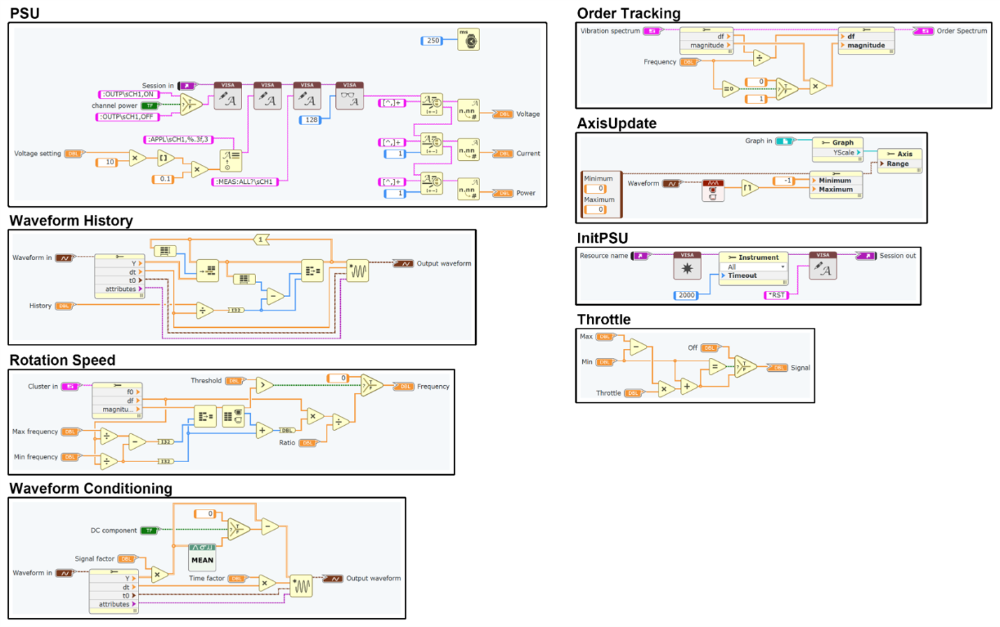

I chose LabVIEW to build a real-time vibration analysis system as it can easily integrate my NI DAQ and also supports Python. After integrating the Python rotation and order tracking functions into my LabVIEW program, I found that LabVIEW could not process the data fast enough. This was a bit surprising to me, as the Python functions could process the data in a fraction of the time of the recorded time span (they could easily keep up with the data flow). I ended up removing the Python code from the LabVIEW program and performed a simpler analysis that assumed constant rotational frequency during short time spans.
The dashboard contained 4 controls: A power button to turn on the PSU (accessed through VISA drivers), a voltage slide bar to set the PSU output voltage, a throttle slider that controls the ESC (through a PPM signal) and a history control, to set the size (in seconds) of the FFT window. The gauge indicators indicate the PSU readback voltage, current and power, and the motor oscillating frequency (the highest frequency component of phase signal spectrum). At the right there are two time domain plots to see the vibration and phase signal. And taking most of the dashboard space, the horizontal frequency domain plots show the order vibration spectrum, the frequency vibration spectrum and the phase voltage spectrum.
The next video shows how the system performs real-time analysis with constant and variable rotational frequency.
The next diagrams show the main module and submodules used to build the virtual instrument:
