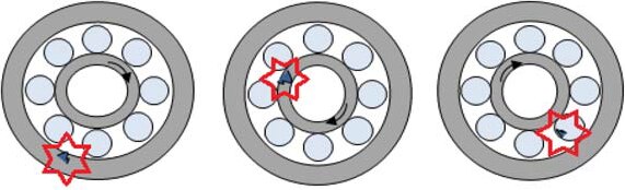

My plan is to use the vibration sensor to perform vibration analysis of a motor. Rotating machinery produces vibrations that depend on their structural properties. One important component of rotating machinery are the bearings. Ball bearings produce a vibration signature that depends on bearing properties (ie: number of balls, diameter of the balls, the inner and the outer race, etc). By analyzing the vibration signature it is possible to identify what exactly is damaged, and how damaged it is. To perform these analysis the time series have to be converted from time domain to angular domain (this conversion process is called order tracking). The spectrum in the in the angular domain then indicates the kind of damage (seen as a frequency component) and the amount of damage (seen as the amplitude of the peak).
The next image shows a damaged outer race, inner race and ball respectively:
[Source: Rolling bearing faults severity classification using a combined approach based on multi-scales principal component analysis and fuzzy technique]
