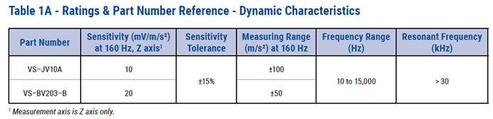

I'm not sure how different the Kemet VS vibration sensor performance is relative to the MEMs accelerometers that you find everywhere.  I assume with the large cost differential that the Kemet should have a lot higher performance.  A lot of my early experiments will be to characterize the sensor in my use case.  The Kemet sensor has an analog signal output so that will require using an ADC to sample the data and that whole process could cause performance degradation.

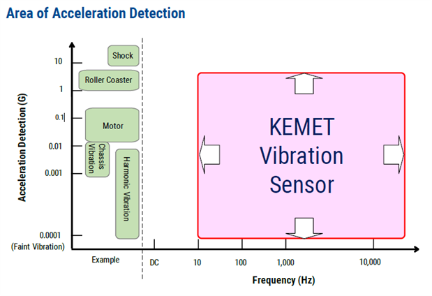

The Kemet spec illustrates the application range for the sensor.
We'll be using the VS-BV203-B so the measurement range is +/-50 m/s^2 or about +/-5G.  I'm not quite sure what vibration range that I'll see but I'm guessing that I may see less than 20mV of signal which probably means that I'll need to add some amplification before the ADC.

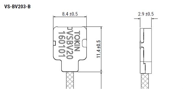

I was surprised at some omissions in the spec.  It is clear that the sensor needs to be oriented so its Z axis is in the direction of the vibration but I don't see in the spec where the Z axis is indicated.  I'm going to guess from the picture of the sensor housing that the axis is perpendicular to the flat side and that positive is toward the labeled side.  This should be easy enough to check once I get the sensor, hopefully tomorrow.
The other omission is that they don't specify the connector type on the end of the sensor cable.  Worst case, I'll just cut it off and add my own connector.
