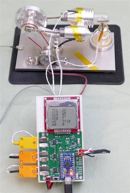

This section explores harnessing the power generated by the Stirling engine to run a sensor system that monitors the Stirling Engine, creating a self-contained system. The Senor system includes 6 sensors and an liquid crystal display:
  • a vibration sensor to monitor chassis vibrations with different mounting schemes
  • 3 thermocouples to monitor temperatures at both cylinders and the flame
  • a current sensor to measure the current supplied by the generator connected to the Stirling engine
  • a voltage sensor to measure the voltage being output by the same generator
This video shows how it all goes together and how it works:
The vibration sensor shows that a more massive base also reduces the vibration.
I think it is ultra cool that the Stirling engine can generate enough power to monitor itself despite all the inefficiencies in the system.
I did not have to use any low power tricks to get the system to run.
It even had enough power left over to run 4 backlight LEDs.

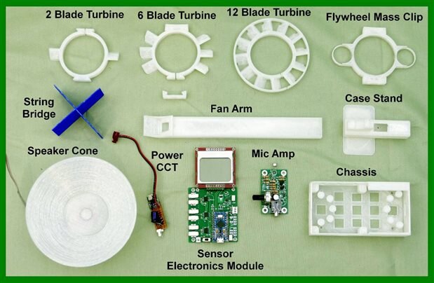

Project Design Elements
This is a design challenge so this section is a review of the design elements of the project.
The vibration sensor did not need any design, it worked very well as a complete sensor with appropriate output.
Many design disciplines were used in the completion of this project, the main categories include mechanical design, electronic design and firmware design.
Design challenges also require planning, fabrication, assembling, programming, testing and blogging, but this section just highlights some of the custom design elements.
This picture shows most of the custom designed subsystems:
The following video discusses each of the main design elements in a bit more detail:
This project ended up involving at least twelve 3D printed parts and a couple of printed circuit board designs.
Of course some of them were necessitated by requirements for design improvements and the experimental nature of the project.
But I love designing, so that was a fun aspect of the project.

  • testing a 3D printed speaker cone on a surface audio driver and using the vibration sensor to troubleshoot amplifier clipping
  • testing a speaker case vibration versus the corresponding acoustic speaker waveforms
  • testing sensitivity of the vibration sensor to small vibrations, small direct impacts and small external impacts, including a pin drop
  • testing vibration of wine glasses clinking
  • testing vibration of a steel ruler cantilever
  • testing vibration of a single string, emulating a stringed instrument in potential tuning applications
  • testing the resonance of a bottle with air blowing across its mouth
  • testing Stirling engine vibration in multiple axes sitting on various surfaces, including foam rubber
  • testing how Stirling engine vibration changes based on flywheel mass
  • testing how Stirling engine vibration changes based on chassis mass
  • testing a microcontroller reading and displaying the vibration sensor monitoring a Stirling engine subjected to various mounting arrangements

A self-contained system running a monitoring microcontroller powered from a small generator driven by the Stirling engine was designed and built.
