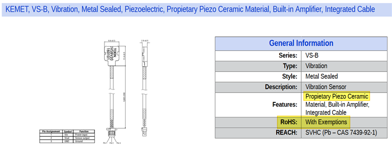

To be clear, I do not have any inside knowledge of what material is in the VS-Series vibration sensors. Their development happened after my time. The VS-VB203 datasheet says "proprietary Piezo Ceramic Material." But I suspect is some form of PZT since they do continue to carry one of the remaining RoHS exemptions for lead(Pb). (The lead-free alternatives to this material simply do not perform as well!)

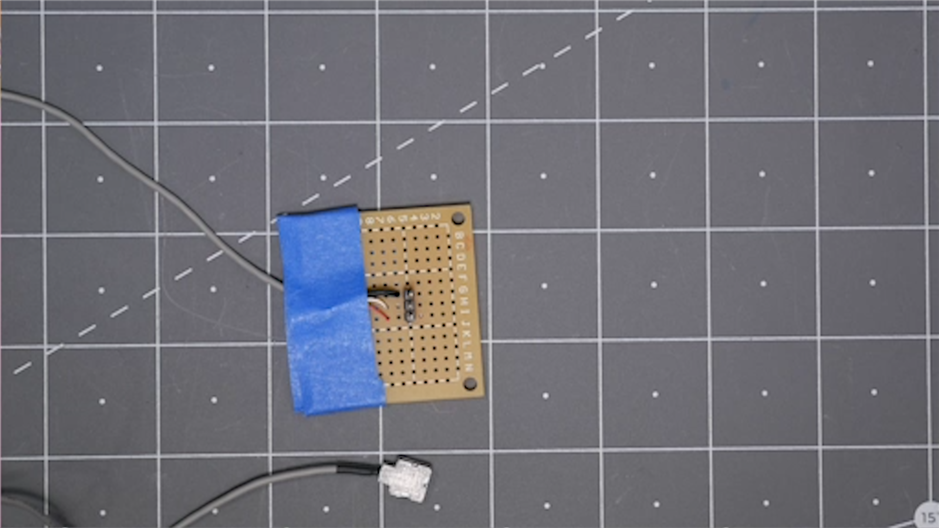

The VS-series has two different connector styles available. These both appear to be industry-standard connectors, though not types popular in the hobby community. The included instructions show a clear pinout, with wire colors. That inclusion made swapping in my own 0.1-inch (or 2.54mm) header a piece of cake. Also, imagine receiving a sensor that comes with a paper-instruction sent in multiple colors. How often does that happen today?
The sensor's pins are straightforward: Vin, Vout, and GND. Even though there are four pins, the sensor only uses 3 wires. when working with sensors there fundamentally two different types: analog and digital. Analog sensors output a voltage relative to some physical quantity. Digital sensors provide an interface, like I2C or SPI, to read the sensor's value. KEMET TOKIN's VS-Series outputs an analog voltage, generated by an internal amplifier.

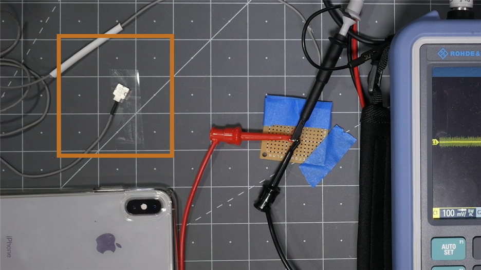

For the purpose of this hands-on, I used the STM32 Nucleo that the element14 Community provided. Even though the processor runs at 3.3v (I think), the ADC input is internally scaled such that it can handle the sensor's 5 volt output.
Measuring the TOKIN Vibration Sensor's Output

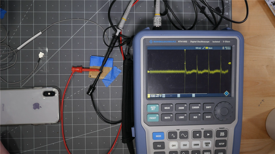

Measuring the sensor with a multimeter does not make much sense. At first, it seemed like the sensor did nothing when looking at the sensor's output with my Multicomp Pro MP73006 meter. The DMM samples data way too slow for a good measurement. You might even think the sensor isn't very good. (I mean, I certainly did NOT think that for a few seconds! Nope. Nu-huh.)
Since the sensor responds so quickly to vibration, I switched over to viewing signals on a scope. The result was a very distinctive and lively waveform. The sensor was so sensitive, I could use it to visualize sound. In the measurement shown here, the sensor is taped to a table. I placed my phone relatively close. The phone vibrates the table and the vibration sensor picks up that table vibration.

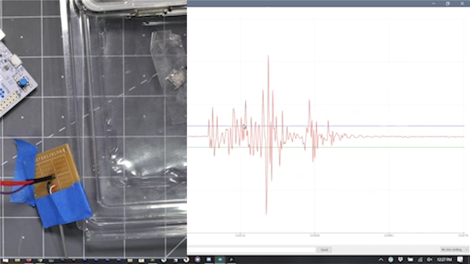

Visualizing Sensor's output with Arduino IDE's Serial Plotter.

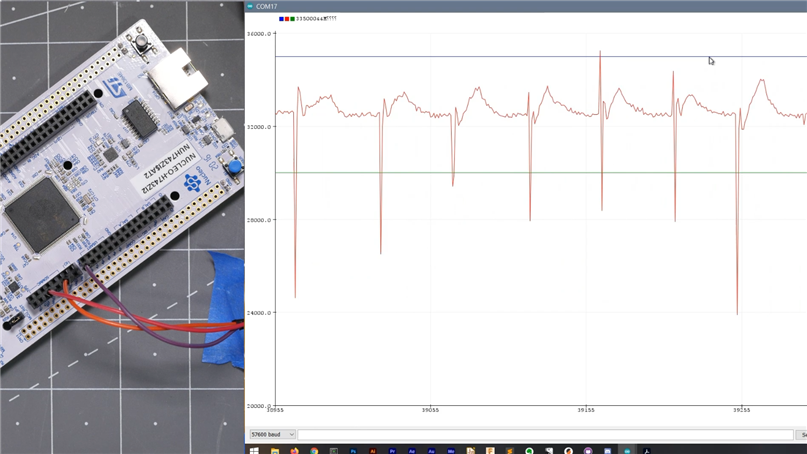

I'm going to bypass any discussion around the STM32. I made the mistake of trying to install the STMicro tools and wasted significant amounts of time. If you'd like to see me struggle, check out this clip. [Link to STcube Clip]. Since I don't have a couple of weeks to invest in a completely new toolchain, I decided to use the Arduino IDE to stay productive.
With a little bit of Arduino code, I was able to see my tapping affect the Arduino IDE's Serial Plotter. After that, I tried the same trick we did with the oscilloscope. The serial plotter shows audio waveforms. Even after enabling more bits on the STM32's ADC, I noticed that there was some noise. So I tried a few averaging techniques to clean it up.
Using a modified moving average, I was able to get a real-time boxcar that resulted in a decent looking audio waveform. At THIS point, I would like to go back a step and try the same task with STMicro's tools. I think their dedicated toolchain and ADC-specific information could result in a more efficient averaging algorithm. (I think there is some dedicated DSP hardware that could do the averaging.)
