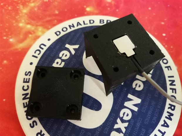

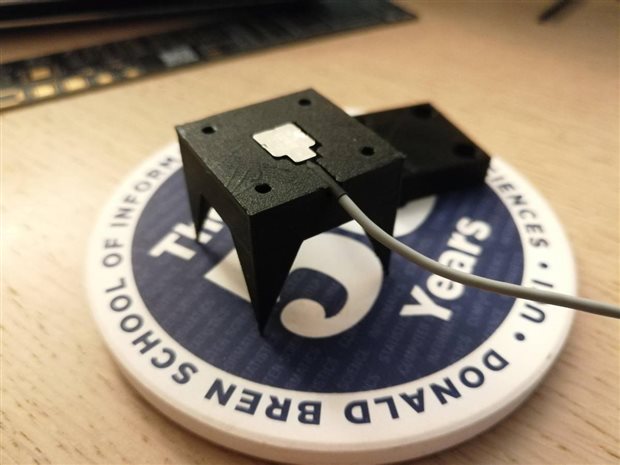

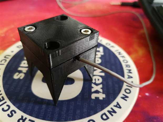

3D Printed Mount
As the title of my project describes, I would like to measure the vibrations of our apartment or its floor that is caused by our indoor exercise.
For this purpose I need to mount the sensor on the ground but unfortunately our apartment has a very thick carpet that is not allowing me to
mount the sensor properly on the ground. So I had an idea to design a legged 3d printed part for mounting the sensor. You can find the 3D
file here. And some images:
{gallery:autoplay=false,width=800,height=600} 3d Printed Mount
Sensor Mount: 3D printed and 4-legged mount.
This is not perfect. The legs are not sharp enough to go 100% through the carpet and also they are not strong enough.
Some sort of sharp steel leg would be perfect. I chose the distance between legs too short I believe. Because I need to
put some weight on it to push it to the ground but the mount is so small that the weight is sliding and sometimes causing the vibration.
