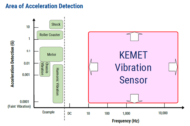

Is it through voltage fluctuations?
I can see that there is only one wire as the signal. Is it modulated somehow, or is there a carrier wave?
I wasn't able to find the information in the datasheet linked to the article, but maybe someone can point me in the right direction?
    genebren over 6 years ago in reply to genebren +4 verified
    This is from the KEMET catalog and shows the frequency and amplitude range (along side a range of example applications). Ideally, you would sample the sensor at a high rate and perform a FFT to identify…
    genebren over 6 years ago +3 suggested
    It functions similarly to a microphone. The amplitude of the signal is proportional to the strength (or force) of the vibration. The frequency of the signal matches the frequency of the vibration.

    0 genebren over 6 years ago in reply to genebren
    This is from the KEMET catalog and shows the frequency and amplitude range (along side a range of example applications).  Ideally, you would sample the sensor at a high rate and perform a FFT to identify the amplitude at different frequencies.
    I hope that this helps.
