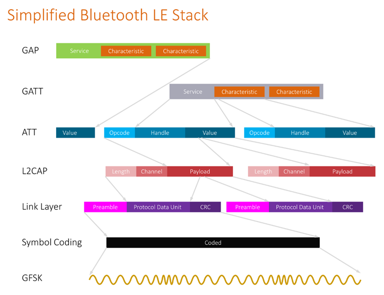

Hi
It has been few weeks that I am trying to learn about Bluetooth low energy (BLE). This is the first time I code for bluetooth and I spent a lot on learning the basics. I managed to get my python script to communicate with the Nucleo board via the BLE expansion board. It seems the BLE is not designed for relatively large data. Every packet is like around 20 bytes of data. I read about L2CAP which seems it can increase the throughput. But I do not find an example or any code to use the BLE and L2CAP. L2CAP is marked as supported in the BLE exansion board but I do not know how to activate it and how it works.
My purpose is to be able to send the ADC measurements over BLE to the PC and do the rest of calculation on PC. It has been impossible to have a good speed of data transfer for this purpose. For example when I send 250 bytes from nucleo board to PC without L2CAP, it takes more than 1 seconds. The alternative is to do calculations on the nucleo board and use the BLE just as a notification.
If you know about the L2CAP and BLE please help me. I do not find anyway to send data using L2CAP with the bluenrg library as a server. bluenrg library has few functions to receive L2CAP stuff or sending as a client, but I could not find anything to initiate the communication over the L2CAP as server.

    0 shabaz over 5 years ago
    By the way, here is a very simplistic diagram.
    If you're experiencing 1-second delays to send information, it could be that the higher-level API calls you're using, are causing advertisements and characteristics discovery procedures each time (which all filter down the stack from the location where they are initiated in each state machine in the stack), prior to sending your desired application data. All of those procedures take the times specified in the BLE spec.
    You may need to change what API calls you are using, or pass particular handles for subsequent requests to send your application data, or some other parameter. But you'll still have to work at the high level API, it's normally not possible to take a short-cut and try to send function calls mid-way in the stack directly to the L2CAP layer, that will break things.

    0 yosoufe over 5 years ago in reply to shabaz
    As I understood, the BLE sends in packets of 20 bytes, So the 250 bytes will be sent in 13 packets.
    Do you think I have something wrong or inefficient that takes so much ling? I will double check that then, Thanks.
