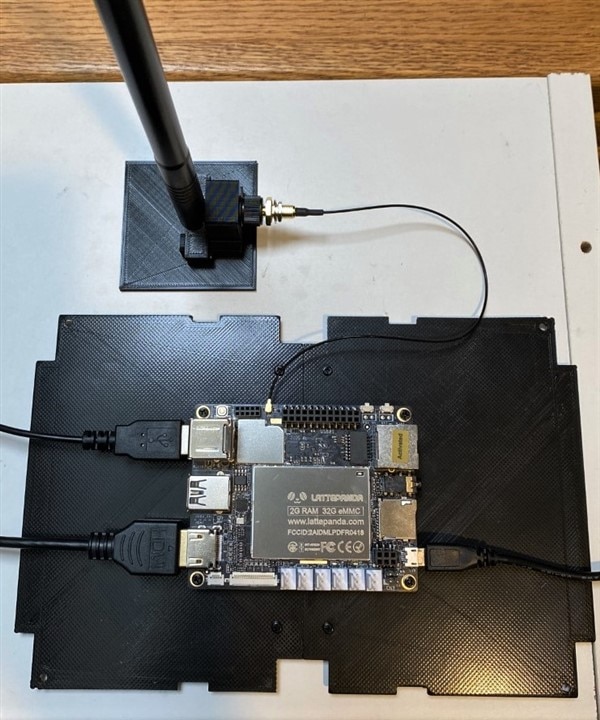

My test setup for getting started is shown below.
  1. Raspberry Pi  5V, 2.5A microUSB power adapter
  2. SMA WiFi antenna (connected using the SMA adapter in the kit)
  3. HDMI cable to USB 3.0 Video Capture device
  4. USB Keyboard/touch pad
  5. lattePanda mounted on enclosure adapter plate
Windows is already activated, so boot up was straightforward.
  1. Apply power and wait for the red LED on the underside of the board to turn off
  2. Push the power button for 1 second
  3. Initial boot to stable desktop took just under 2 minutes (see video)
  4. Connected to WiFi router
  5. Verified WiFi connection using ipconfig and ping
  6. Started Edge Browser (it connected but crashed during configuration) - I am going to switch to Chrome
The video below shows the first boot.  The mouse is a little jumpy, but that might be due to the interface settings for the touchpad (I am going to switch to a remote desktop).  The WiFi verification is at the end if you want to skip the prolonged Edge browser crash...  You'll note the incorrect system time until WiFi connects.
