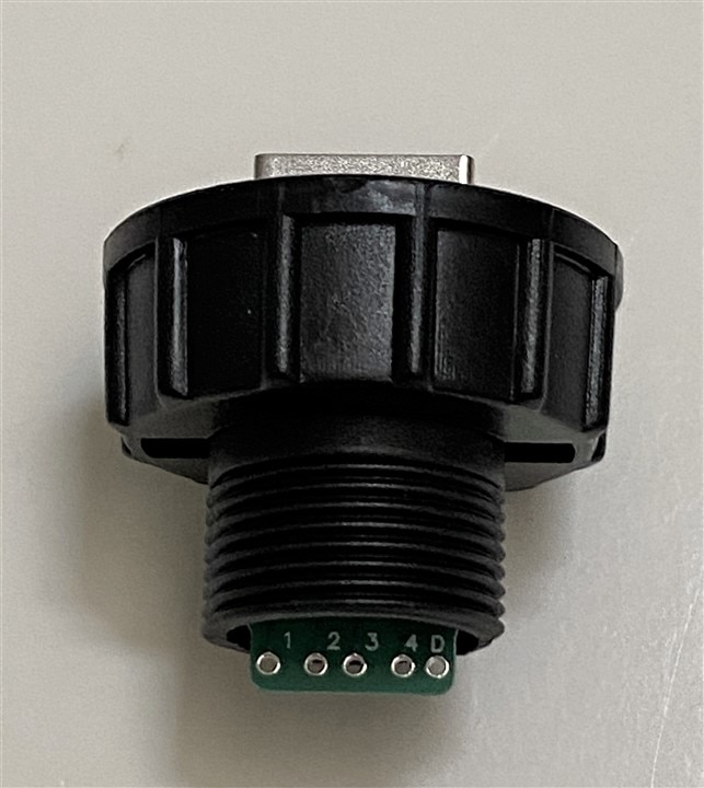

I found it interesting that these industrial connectors are fairly Spartan in terms of labeling.  In the case of the RJ45 interface board there were no pin numbers associated with the terminal blocks, so I needed to do a continuity check before I connected the cable pigtail.  For the USB-A  plug board, the pins were labeled 1-4 and D, so again a continuity check was required.  I'm used to consumer products that are more obviously labeled, so I created my own connection tables.

USB-A Jack
USB
  1
 Red      +5V
  2
 White  Data+
  3
 Green  Data-
  4
 Black    Gnd
  D
 Shield

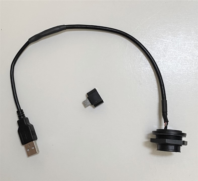

The USB panel connector with its pigtail and mating connector attached.
The mating connector PCB connections.
Cable grommet is for 3.5mm to 6.8mm cable.  I am using an external USB 3.0, 5.5mm diameter cable
The completed internal cable assembly.  I also have a USB-A to microUSB adapter, so that I can use the USB as a standard port or to provide power to the lattePanda.  I've used shielded cable internally and externally, so it should work for USB 3.0.
