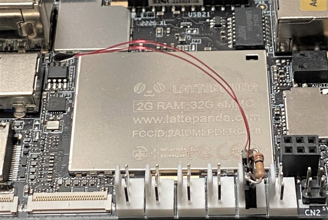

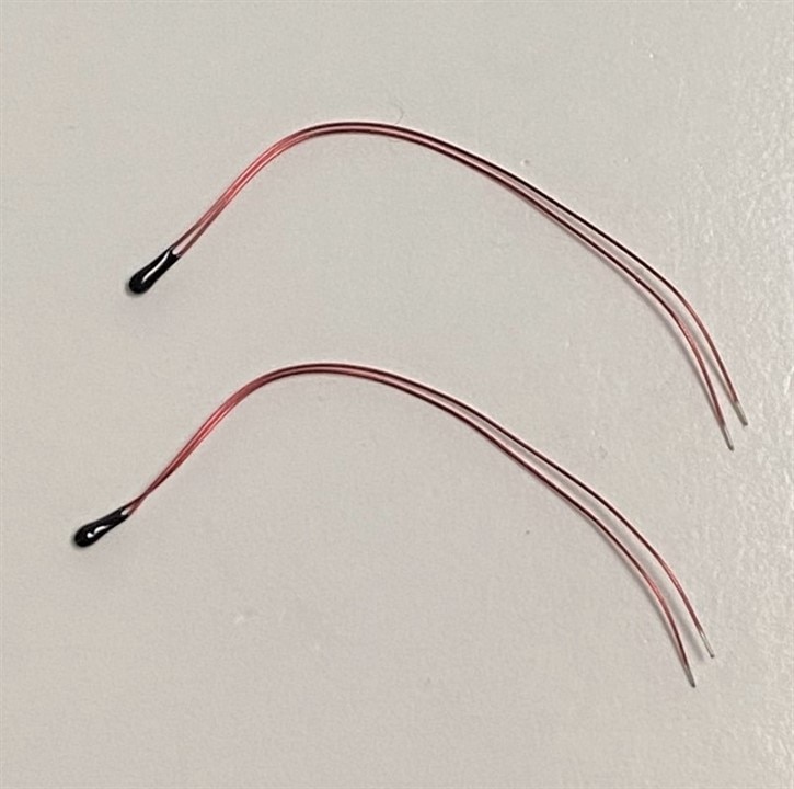

Shown below are the 100K NTC (negative temperature coefficient) thermistors that I am using.
The internal thermistor will be connected between the A1 pin and +5V with a 100K pulldown between A1 and ground as shown below.  I haven't decided which point on the lattePanda board that I will monitor with it.  I'll try getting a thermal image of the board to see if there are any points of interest.  The external thermistor will have the same attachment to A2.
Doing an analogRead(A1) at 1 second intervals produces a fairly noisy plot.  I'll probably need to add a capacitor across the pulldown resistor.
A quick try using a 30 point moving average does a good job of smoothing.  The peak is caused by holding the thermistor between my fingers.  I'll need to take some data to get an analog value to temperature correlation.
