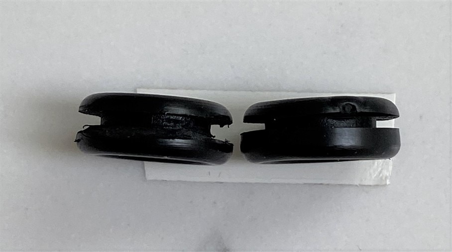

Plug unused connector holes
The larger two holes below are for connectors that I am not using.  The largest one is for the N to TNC adapter and the other one is for a TNC connector.  I had difficulty finding suitable plugs for the holes and I considered just mounting the unused connectors, but I don't have mating connectors or caps for them.  The difficulty in finding plugs was caused by two things - the connector mounting holes are orientation keyed (not round) and the enclosure thickness is 3.3mm which is too thick for common grommets.  I finally settled on 15 mm and 12 mm closed rubber cable grommets that I surgically modified with a Xacto knife.  The fit is pretty good, but only testing will tell...

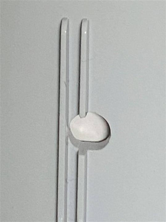

Remove ribbing material from inside the enclosure around the SMA connector
The hole for the SMA connector that I am using for a WiFi antenna was drilled through internal ribbing that I would guess is used to insert partitions into the enclosure.  I had concerns about whether the external gasket would seat properly with uneven pressure from the internal nut, so I cut the ribbing out around the connector using a Dremel tool.  The gasket now seats well.  I am not going to submerge the antenna, but will use a plastic dust cap that I hope will protect the SMA contact.
