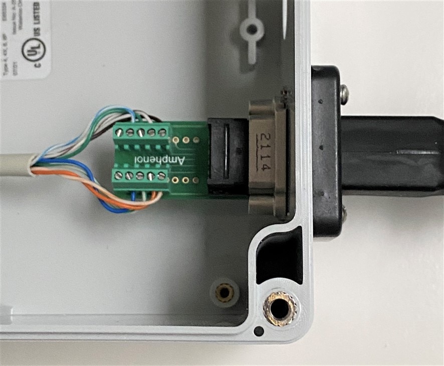

Add threaded inserts for RJ45 backshell
Using the rubber boot for a template, I marked the hole positions and drilled the two pilot holes.
Then gradually used increasing drill sizes until I had the 5/32" holes needed for the inserts.  Because I don't have the proper fixturing, I chose to hammer the inserts in from the backside.  Not perfect, but a reasonable job that works well.
A picture showing the connectors mated with the backshell installed.

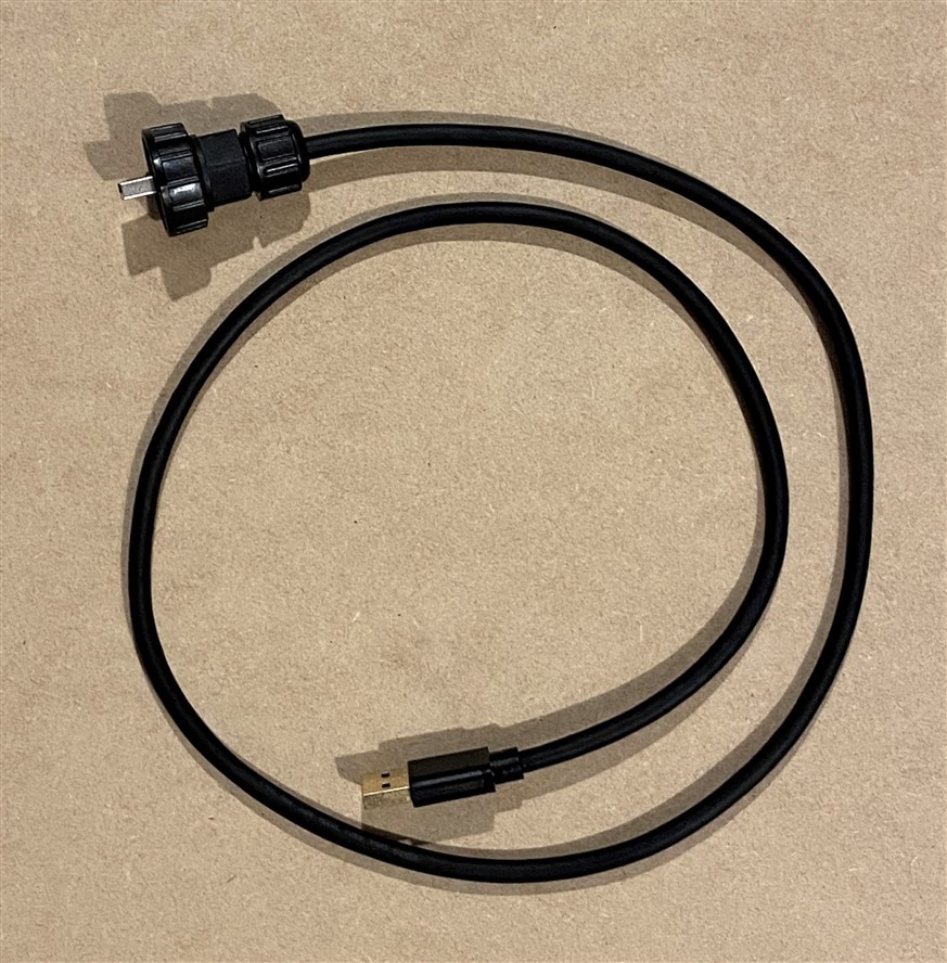

Finish wiring external ethernet and USB cables
These cables are being used specifically for the submersion test fixture, so I built them just long enough to keep the non-submerged ends clear of the water.  I will use the appropriate extender cable lengths to get to the monitoring equipment.
Ethernet cable
USB cable
