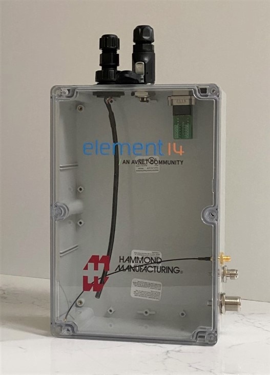

I've deployed a few outdoor projects in the past with moderate success using IP65 enclosures.  In the Pacific Northwest we have quite a bit of rain during the year, so I have an interest in waterproof enclosures and connectors.  My previous outdoor projects did not use connectors but instead used IP68 cable glands and jacketed cable.  I don't really do many submersible projects - my my primary requirements are tolerance to heavy rain and hose spray.
The challenge kit includes a Hammond IP68 rated enclosure and an assortment of Amphenol IP67 rated connectors, so it will be a good opportunity to test how well waterproof connectors perform in my types of applications.
There are 7 bulkhead connectors in the kit
  1. USB Type A with mating connector
  2. RJ45
  3. 4 pin Circular with mating connector
  4. Type N to SMA coaxial adapter
  5. SMA to MCS coaxial adapter
  6. TNC coaxial
  7. SMA to AMC coaxial cable assembly
There are 6 cutouts provided on the enclosure
  1. USB Type A
  2. RJ45
  3. 4 pin Circular
  4. Type N
  5. SMA (for either of the 2 types)
  6. TNC
The picture below shows the connectors mounted on the enclosure:

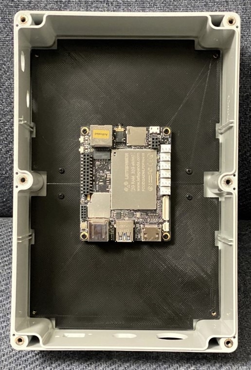

I printed an adapter plate to mount the lattePanda and other components in the enclosure.  The size of the plate exceeded the maximum build size of my printer (210 mm), so I had to print it in 2 halves.
For this challenge I have the following objectives:
  1. Implement an environmental sensor system to monitor the temperature, humidity, pressure and gas inside the sealed enclosure using a BME680 sensor and internal & external thermistors with the lattePanda.
  2. Determine whether the sensor system can reliably detect water ingress into enclosure before failure is catastrophic (is humidity sufficient or is liquid sensor required).
  3. Characterize environmental effect of operating a moderate power (5-10W) SBC (lattePanda) in a sealed enclosure. Can it operate reliably over an extended period or are there thermal issues.
  4. Determine whether the enclosure and connector system can withstand submersion in water without leaking.
I plan to use the SMA (WiFi/BLE), RJ45 (Ethernet), 4 pin circular (power/external thermistor) and USB-A (debug) connectors with the enclosure.  This will be subject to further research.  Not sure if it will be practical to operate using connectors other than the 4 pin circular and USB-A when the enclosure is submerged (waterproof mating connectors for those two are supplied in the kit).  In the deployed normal operating configuration, I plan to only use the WiFi antenna and power connectors.
