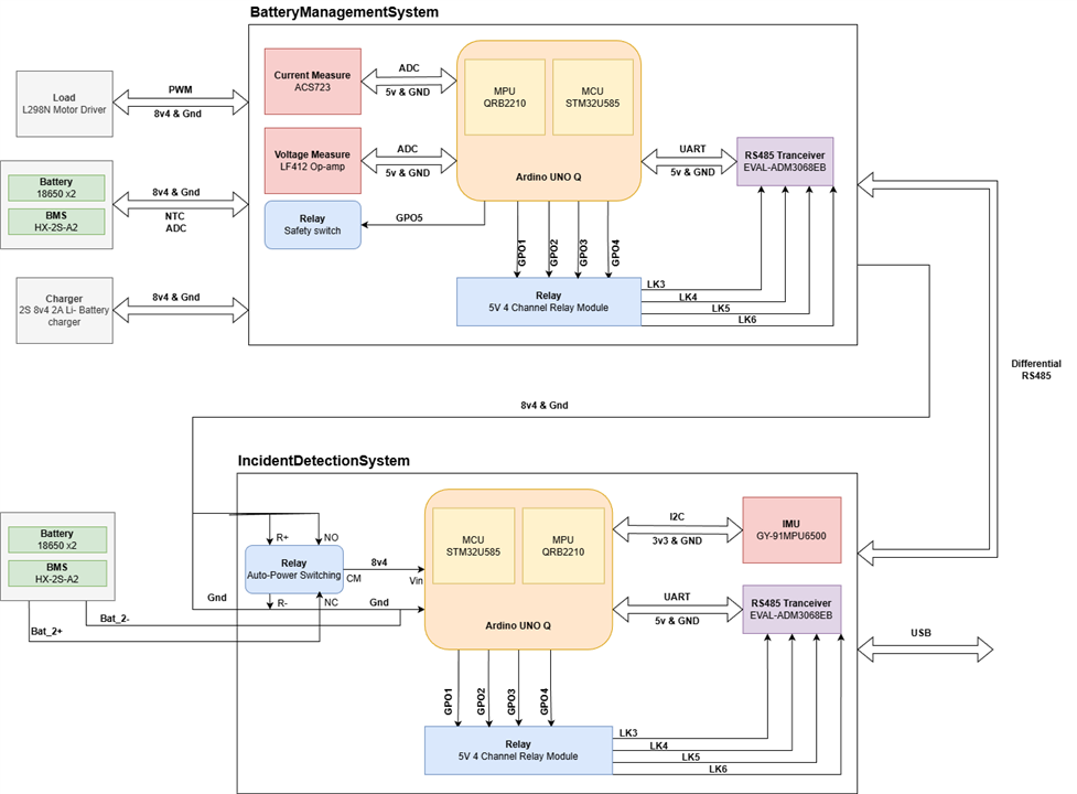

Building the Technical Architecture: From EV Battery Intelligence to Emergency Safety
In my previous post: Part EV Guardian - Part 1,
I introduced EVA Guardian and the motivation behind the project — an intelligent EV platform designed not just to monitor a vehicle, but to help understand its battery condition, detect abnormal vehicle behaviour, and provide assistance during an emergency.
In this post, I want to move one step deeper.
After defining the problem and the overall vision, the next question is:
How can I actually build this system using the hardware available to me?
For this challenge, I decided to divide EVA Guardian into two interconnected systems:
  • Battery Management System (BMS) & Battery Profiling Node
  • Incident Detection & Safety Node
The two systems have different responsibilities, but they work together through an RS485 communication link.
Figure 1: High level block diagram
1. Battery Management & Profiling Node
The first part of EVA Guardian is responsible for understanding what is happening inside the battery system.The prototype uses a 2S 18650 Li-ion battery configuration, together with an HX-2S-A2 battery protection board.The HX-2S-A2 provides the basic battery protection layer, while the Arduino UNO Q sits above it as the intelligent monitoring and analytics layer.This distinction is important.The protection hardware is responsible for fundamental battery safety, while my software will focus on understanding the battery's behaviour.
The battery node therefore brings together:
  • 2S 18650 battery pack
  • HX-2S-A2 BMS
  • ACS723 current sensor
  • LF412-based voltage measurement circuit
  • NTC temperature sensing
  • 2S Li-ion charger
  • L298N-controlled load
  • Relay-based switching
  • Arduino UNO Q
  • ADM3068E RS485 interface
Each component has a specific role in creating the battery intelligence system.

6. Incident Detection & Safety Node
The second half of EVA Guardian focuses on something equally important:
What happens when the vehicle itself behaves unexpectedly?
For this, I am using a second Arduino UNO Q together with the GY-91 sensor module.The GY-91 provides an MPU6500 accelerometer and gyroscope, along with the BMP280 pressure and temperature sensor.For the initial implementation, the MPU6500 is the primary sensor for vehicle motion analysis.

10. Communication Between the Two Nodes
The two systems need to communicate because battery condition and vehicle safety cannot always be considered independently.For this purpose, I am using Analog Devices ADM3068E RS485 transceiver evaluation boards.

12. Bringing Everything Together
Figure 2: Technical Architecture
This is where the two nodes become a single system.During normal operation, the Battery Management Node continuously monitors the battery.The voltage, current and temperature sensors provide the raw information required to understand the battery's electrical and thermal behaviour.The Arduino UNO Q processes this information and gradually builds a battery profile.At the same time, the Safety Node continuously monitors vehicle movement through the GY-91.The two systems communicate over RS485, allowing the master node to maintain an overall view of the vehicle.The master node can therefore receive information about:

Github Repo: https://github.com/ForgedCircuits/EVA-Guardian.git
Youtube: The Technical Architecture of EV Guardian
  • navadeepganeshu
    navadeepganeshu 3 months ago
    Well thought architecture with nodes. Good progress!
    DAB 4 months ago
    Nice plan, I look forward to seeing your build.
