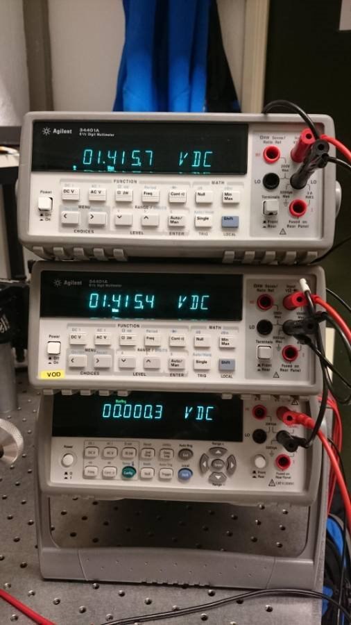

Hi all,
I have - what I think is - a grounding problem, or a noise problem generated somewhere in a two-stage Transimpedance amplifier circuit, I am attaching the schematic of the circuit, however, please note the following:
+ The two diodes you see "D1" and "D2" are only for the sake of graphical representation, in the circuit there are two Lateral-effect Photodiodes (or PSD) reversely biased.
+ What you do not see in the schematic are the four 20 kOhm potentiometers used for input bias voltage balancing of the 4 op-amps, if at all relevant.

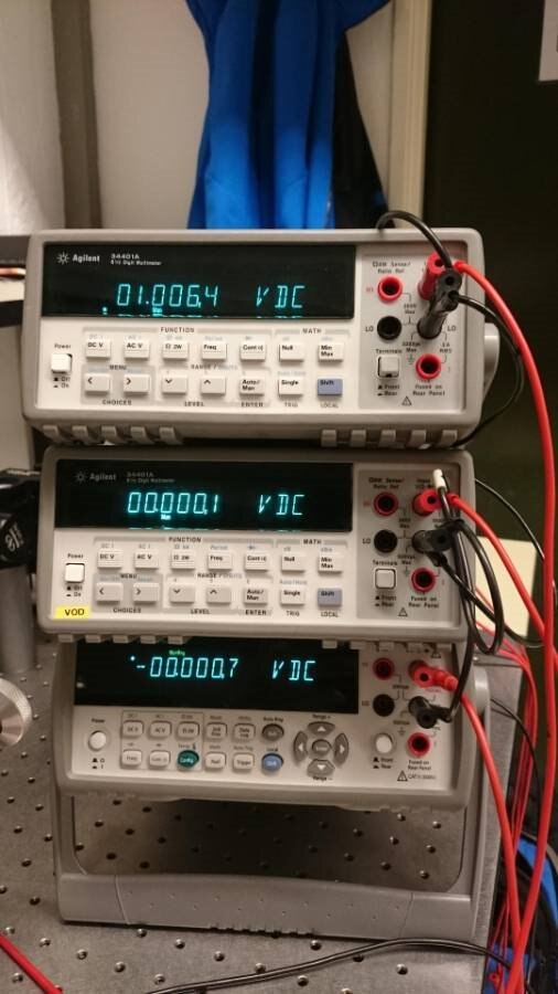

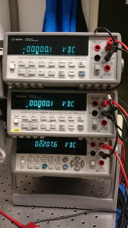

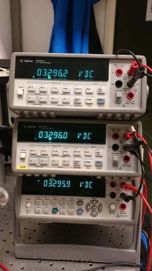

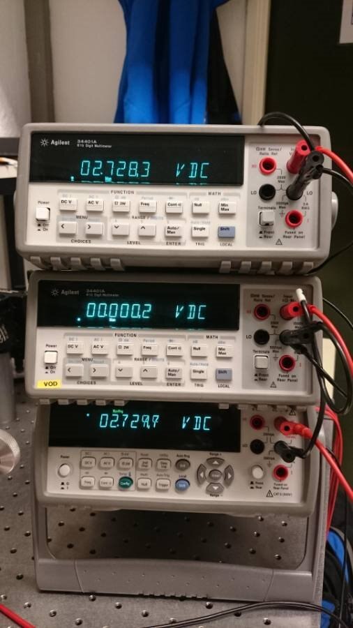

I am also attaching the voltage measurements at some nodes in the circuit, sometimes under different connection conditions for reference.
The problem is also quite obvious when measurements are taken between different ground nodes (or what I am calling Common GND) where I get a kinda sinusoidal signal with Vp-p ranging from a 100 to 200 mV with frequency of about 30 MHz (an example is attached).
Note that the C_GND is not actually grounded externally, so it is relative, which might be the main problem. If it is indeed the problem, could someone point me to the relative best practice.
The result of what you see is the fluctuating output signals of the pair of op-amps at the second stage (also 1st stage has something similar) with frequencies of around 4 and 8 MHz -even with the 100 pF on the feedback of the op-amps- which should ideally be a DC signal. Therefore I would very much appreciate any comments or critics of the situation you see here to get me that sort of stable behavior.
Many thanks in advance.
  • motmot
    0 motmot over 10 years ago
    Hey all, been busy with exams for a while, thanks so much for your comments on this, just seen them all, a bit overwhelming to say the truth, I will consider them all as much as possible, and hopefully have a positive feedback.
    I just want to add one thing, actually the first sign of trouble I saw in the circuit was while I was taking measurements, I noticed that the voltage reading of the ouputs of the summing and subtracting amps (the second stage) was changing with the multimeter I was using, and changing with the number of multimeters, the more hooked to the same node at the same time the higher the potential reading was, which meant the introduction of a multimeter itself was influencing the circuit, so none of those measurements are true. In these pictures all measurements are made on the same node (output of the subtracting amp, if I am not mistaken) under the same conditions, later when I used the oscilloscope it had the same effect but it showed the significant oscillations as well. If that gives you a hint, that's great. That was on another breadboard, the connections of which (grounding especially) were triple-checked carefully, to no use, I reconstructed it on another, seemingly better, breadboard, got the same results, that's when I came to consult you guys.

    I think John is on to it here - Vbias is meant to be 5V DC (there should be no AC here at all and it should be the same at any physical point on the node.).
    Check your ground connections (and all other connections).
    Try just shorting Vbias to ground.
    Try simulating the circuit in LTSpice (its free and will be illuminating).
    Ceramic capacitors (100nF - 1uF) from the op amp supplies to ground for every chip are essential with high speed parts.
    A few of good rules of thumb are:
    • Simulate first
    • The effective operating frequency of anything with op amps is the gain bandwidth product of the op amp.
    • The chances of a breadboard lash-up working are inversely proportional to the effective operating frequency.
    • Plug in prototype boards don't work above 1MHz
    • If the position of the scope probe (a capacitance to earth)  on a node affects what happens then either you don't have the circuit you thought or the inductance of the wires is significant.
    • If attaching the scope probe to a node anywhere affects the circuit then think why a 10 - 100pF cap is doing this (check cap figures for your scope probes on x1 or x10)
    • For frequencies above 1MHz and more than 10 parts go straight to pcb
    • For switch mode PSUs go straight to pcb
    Like all such rules they are very far from absolute and if your prototype and analogue skills are good you may be able to break many or all of them - but you should know why you are breaking them.
    MK
