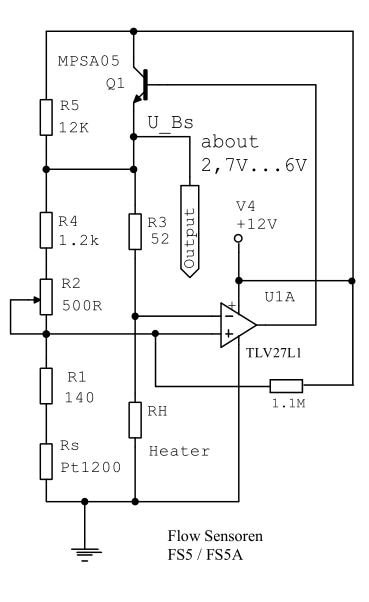

Hi,
I am Anthony working as an Embedded system engineer for an electronic design house.
Currently, I need to do hardware design for an application in which we use IST FS1 sensor for measuring air flow rate from cypress ble microcontroller.
I just googled about this sensor and I got some application bridge circuit for this sensor but they are for Arduino (for 5V range).
But what I need to interface is with ble microcontroller which can measure only 0 to 3.3V range.
Can I get application circuit for that sensor for cypress ble microcontroller?
I really need your help. Thanks.

  • anthonythet
    anthonythet over 9 years ago in reply to michaelkellett
    Hello Michael,
    Thanks for your reply and advices.
    Actually, in the sensor application note, they give the bridge circuit to read analog data but the output range is 2 to 6V and the supply voltage is 12V.
    I want to know is there anyway to scale down the range to 0 3.3V and reduce the supply voltage?Thanks.image

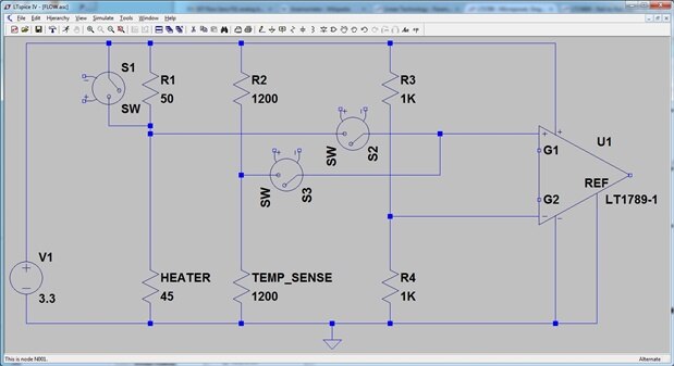

  • michaelkellett
    michaelkellett over 9 years ago in reply to jc2048
    Yes  - that's the basis of my optimized 300mW wild guess.
    Driving the heater with PWM is possibly helpful at low flow rates (and actually all the OP's flow rates are low for this sensor) - but I think he needs to do some testing.
    The circuit must measure the resistance of the heater (accurately) while also being able to adjust the current. At the same time it must measure the ambient temperature accurately.
    The temperature measurement is simple enough - a half bridge with a fixed 1200 low tc resistor and a diff amp, the other port of the diff amp can use a half bridge made with two equal value low tc resistors or a ready made matched pair.
    Then to measure the temperature of the heater switch the heater current off, the same diff amp can be shared so that one port is switched between the heater bridge and the temperature bridge.
    It might be possible to use a precision low tc resistor in series with the heater of about 50R and shunt it with a MOSFET which is pulsed by the micro. The least power in the heater will be set by the 50R reistor and the IST data sheet does not make it clear what this would be.
    I've used the LT1789 diff amp for convenience rather than cost - it might need a gain setting resistor.
    S1 would be a low threshold P MOSFET, S2 and S3 are solid state switches and will need to be carefully selected for low offset.
    It would be nice to put a switch in series with R1 but it will totally screw up the performance unless a lot of care is taken - another PMOS would probably do best but the drift of on resistance against temperature needs to be less than 150uR/K.
    it may be necessary to use  ahigher than 30C temperature difference at low flow rates because of the  non zero minimum power we can put into the heater.
    Now Jon, I blame you for having spent nearly an hour on this rather than doing the software I was meant to be doing (but I was falling asleep over that image).
    @ Anthony, I've done nearly all your work for you (imageimageimage) - please ask your boss to send me a percentage of the fee he charges your customer.
    This circuit will use about 100mW minimum, 220mW max, with a switch in series with R1 it can do better.
    MK
