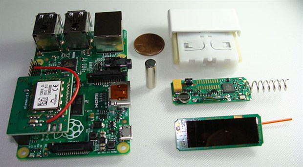

Last night, 8/4/14, a box arrived from Element 14, it contained the following items:
  • Raspberry Pi B+ (no microSD card)
  • EnOcean Pi
  • FTM210U Rocker Switch
  • STM332U Temperature Sensor/Monitor
  • STM320U Magnetic Contact Switch
Needless to say I was excited to get to doing something real rather than just conjuring up visions in my head while working on parts order lists and continuing researching the project. I now have the first pieces of hardware to work with and it must be working NOW. Unfortunately, now was more like several hours of wrestling around with things, but in the end it worked out OK.

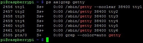

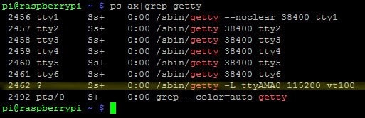

Once I had cleared out all references to /dev/ttyAMA0 from those two locations I restarted the system.  If you've already cleaned up the /boot/cmdline.txt file and restarted then made changed to /etc/inittab, you can just run 'sudo init q' to reload the inittab without rebooting. I ran 'ps ax|grep getty' to make sure that no getty terminals were running with that port. The first screenshot shows it running.
This next screenshot shows that it is not running any longer

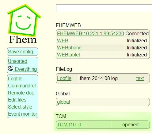

Next I needed to find out the ID for the sensors. The push-button switch had it's ID marked on the back, but the temperature sensor and magnetic contact switch sensor did not.  I originally set up openHAB but it doesn't tell you about communications from unregistered devices. I realized I needed to go back and install FHEM to do this, but the site was down for a couple of hours. It finally came back though and I installed FHEM following the instructions written by malakai "How to setup a home automation server with EnOcean Pi" to get the IDs for the 2 other sensors.image
Once FHEM is running, to to http://<pi_ip_address>:8083/fhem  and you should see a screen like this, notice the section called TCM, that shows that the EnOcean Pi TCM310_0 has been detected, if you don't see this, double check that you edited the /etc/cmdline.txt and /etc/inittab properly and then rebooted the system.

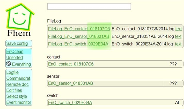

Once some information is received from the EnOcean devices, the left side menu will change and provide you with an EnOceon option, click on that and you should get a result like this, the IDs are highlighted in green.image
I took all of those ID numbers and put them into a spreadsheet. Once your devices communicate a couple of times, the ???s will fill in with valid information from the sensor. With that done I went ahead and disable Fhem, by default it's set to auto-start and I don't want it competing for the serial port with openHAB.
