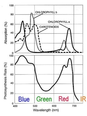

Vegetation is green because plant leaves reflect green light -- they don't use much of it for photosynthesis (see Figure 1).
Instead they use lots of the blue and red wavelengths in sunlight. The pigments in leaves absorb this light to power photosynthesis which converts CO2, water, and nutrients into carbohydrates (food). In general, you can estimate the productivity or vigor of vegetation by how much blue and red light it is absorbing. Photosynthetic pigments do not use the longer, invisible wavelengths of near infrared light and reflect almost all of it away (this helps prevent the leaves from overheating).

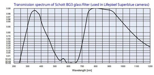

It is possible to capture all the information needed to compute NDVI in just one camera using a so-called "superblue" filter. Spectral transmission of a "superblue" filter is shown in the image below. Most red light (600 to 700 nm) is blocked, but other visible light and most near infrared light (> 700 nm) passes through. This type of filter can replace the IR block filter to allow NDVI to be produced from a single camera. The red channel in the image file will record mostly infrared light, and the blue channel will record light that plants use for photosynthesis.
