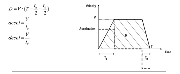

Trapezoidal speed profile
One of the most famous speed profile is the trapezoid. The profile is made up of three phases: acceleration, constant speed and deceleration

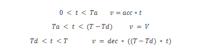

So the function that describe speed in terms of time is

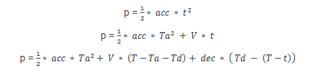

The position in the three phases can then be calculated as
