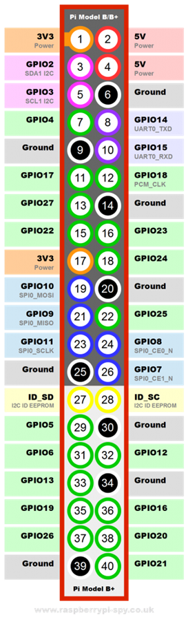

All GPIOs are identified by their Broadcom number. Details about the pinout of the Raspberry Pi B+ board can be found here
http://www.raspberrypi-spy.co.uk/2014/07/raspberry-pi-b-gpio-header-details-and-pinout/
The Broadcom number is the number written in the cyan label. For example if you connect a LED to the pin 40 of the connector, you can see in the diagram below that the cyan label says "GPIO21". So you should invoke PIGPIO function passing 21 for the "gpio" parameter.

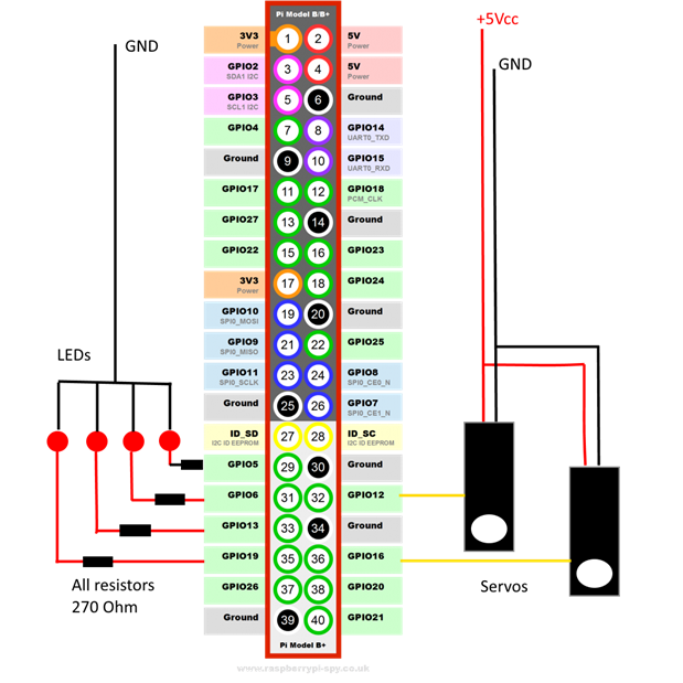

Hardware connections
Sample application
Attached to this post is a sample application that drives two servos and 4 LED. Application is self-explicatory: using 'a' and 'z' keys you can drive first servo and with 's' and 'z' keys
