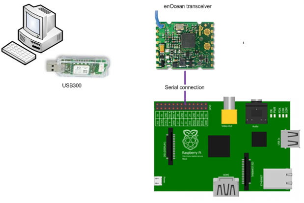

This post probably starts the most interesting part of the project: interfacing the sensor with
OpenHAB through enOcean radio protocol
Hardware setup
The hardware setup is shown in picture below
The PC runs OpenHAB and sends command to the enOcean transceiver to the Raspberry Pi board using the USB300 USB dongle. The Raspberry Pi board, in turn, sends notifications to the OpenHAB.

    Hi,
    thank you for the quick reply.
    With FHEM I can manage to send On/Off queries (at least with the USB Dongle). With OpenHab this does not work so far, which is annoying as there are lots of actuators available on the market.
    I am trying to use the TCM320 transceiver as a sender - I this not working?
    Thank you for your help
    Kind regards
    Marc
