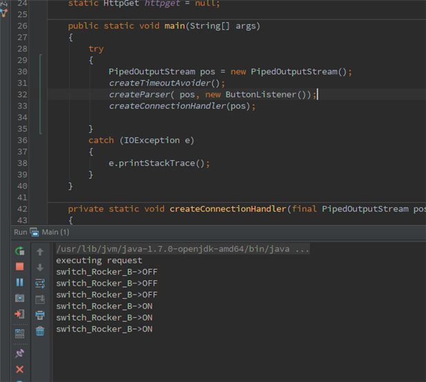

OK, so I spend the last two days communicating with the OpenHAB REST API in much more depth than I wanted to. But at last I can report success. For now I'm able to have a test client listening to ther rocker switch button, without dropping any events or losing the connection.
Next step is extending this test client into a small library being able to handle all sensor types and the sitemap / home page.
Using the Apache HttpCore library means that my code can run on Android too since its part of the platform.image
The bug with OpenHAB sending each message three times still persists. May it gets better when I query the home page instead...

    hlipka over 12 years ago in reply to mcb1
    I guess I would need to run OpenHAB under a Java debugger to find out whats happening there. Is this of interest to somebody here (running the debugger)?
    mcb1 over 12 years ago in reply to hlipka
    rocker switch sends its state two times      yet OpenHAB sends it out three times...
    That is strange indeed.
    The solution will be a eureka moment .... good luck.
  • hlipka
    Thats only half of the solution. According to events.log, the rocker switch sends its state two times (probably to ensure delivery), yet OpenHAB sends it out three times...
    But OTOH, I don't really need to care. As long as I don't miss any events, getting them multiple times does no damage.
