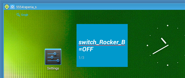

Together with Google I also found the missing pieces of my program configuration (e.g. where to configure the permissions to allow network access) and so I got my first result back from the OpenHAB server (running in the emulator):
(I'm using the rocker switches for my experiments because they are much easier to handle)
