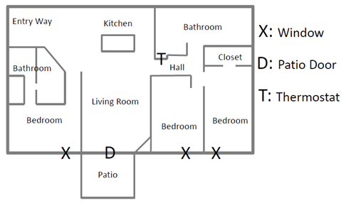

Figure 1 is a rough floor plan of my apartment and I’ve indicated where the windows, patio door, and thermostat are located. The basic idea is to monitor the status of the windows and patio door (open or closed) so one can appropriately operate the AC. Also, the system will determine when I should open the windows and turn off the AC. I.e. when the outside temperature has dropped below a preset value. It should also be possible to control the AC unit remotely with a cellular phone, but I will need to determine a way to do this without modifying the thermostat since I live in an apartment.
Figure 1: Rough floor plan of apartment. The windows, patio door, and thermostat are labeled.

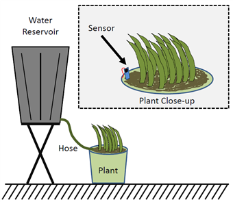

Proposal – Plant Watering
Figure 2 shows the proposed plant watering system. It is a gravity fed watering system that will encompass some form of electronic valve. I have not indicated which valve or sensor will be used because I have not decided which ones to use yet. The sensor will likely be a soil moisture sensor. I would like to incorporate the HSM 100 humidity sensor from EnOcean for this if possible.
Figure 2: Automated plant watering. The mechanism and type of sensor are left unindicated.

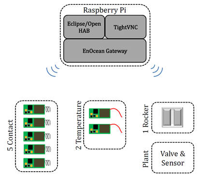

System
The system is quite simple from a functional point of view, which is shown in figure 2. The complexity will likely be in the implementation.
Figure 2: The proposed system; five contact switches, two temperature sensors, one rocker switch, a valve, and a soil moisture sensor.
