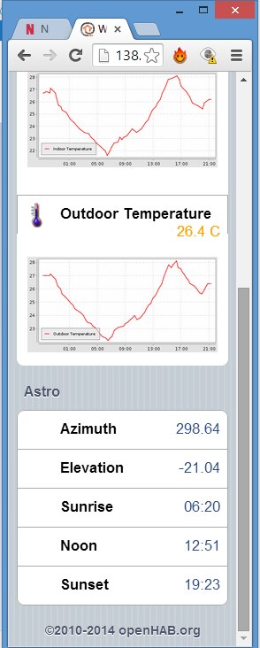

Results
After all is said and done, here is the result:
