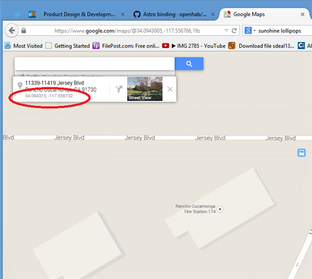

astro:interval is the number of seconds between updating the values. Also, you may be wondering what your position's latitude and longitude are. Load up Google Maps. Type in your address and let Google find your house. You can either stay in map view or switch to Earth view, which ever you prefer. Simply click anywhere on the map, and you will see the latitude and longitude in a small box such as below:
Hopefully you have been able to set your latitude and longitude correctly. Now restart OpenHAB (I.e. exit and run start.sh again)

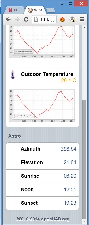

Results
After all is said and done, here is the result:
Almost forgot! Wondering what the heck Azimuth and Elevation are anyway? Azimuth is the angle from NORTH to the sun's position moving clockwise and Elevation is the angle from the horizon to the sun. Elevation is simple, but to understand azimuth picture a clock face where 12 o'clock is NORTH. This position corresponds to an azimuth of 0 degrees. Three o'clock would be an azimuth of 90 degrees, six o'clock would be 180 degrees, and so on.
