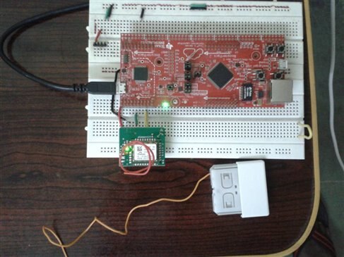

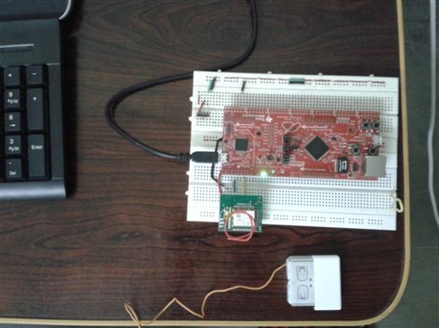

This is quick post on how to interface enocean Pi to your laptop and use it with openHAB running from your laptop. In this post, I'm using Ubuntu 14.04 as my OS with openHAB 1.5 installed.

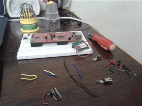

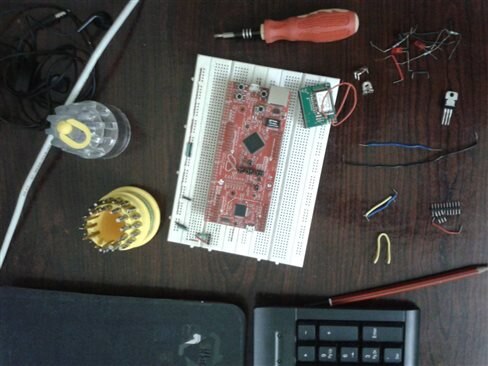

As my raspberry pi will be arriving a little late, I set out to find out whether it's possible to interface enocean pi to my laptop. Searching on google I found that Enocean Pi module uses only four pins from raspberry pi - VCC 3.3V, TXD, RXD, and GND. It immediately came to me that with an USB to TTL serial converter it is possible to interface the enocean module to my laptop. But there is a small problem -- I need a 3.3V USB to TTL serial converter and what I have is a 5V converter. Either I had to buy new converter or make a simple level shifter circuit. It's sunday so no shops will be open. I thought of postponing my plan to next weekend ( or dump the plan in case I receive my rPi this week ). When I'm about to stop the tinkering for the day, my eyes fell on "Ti Connected Launchpad" which I got as a part of my past roadtest. It is USB programmable and has a debugger too. Can I use it as my USB to TTL serial converter. I rushed to TI connected launchpad site and checked the specifications. PERFECT!!! This guy operates at 3.3V and perfectly fits my puzzle.
What all I need to do is to write a small code on Code Composer Studio, compile it and upload it to launchpad. The code will just set up two serial ports in my launchpad -- one I connects to my laptop and other to my enocean pi -- and acts as a serial repeater. And it worked perfectly well. Only problem I faced was I initially set baudrate as 115200 and tried to connect via my serial monitor. Nothing happened. After a few minutes I was able to debug the problem and fix it. image
These are a few pics while I was setting up the circuit :
The last two above are fully assembled circuit along with rocker switch.
With my serial monitor(moserial for ubuntu) I am able to see the hexdump of the communication happening. Only rocker switch is working at this moment, may be others are out of charge.
