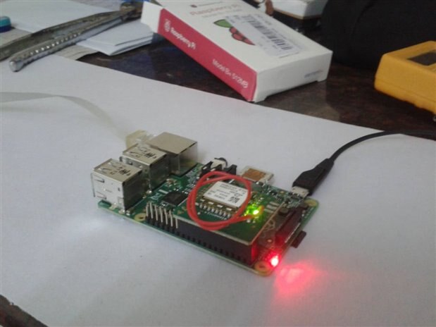

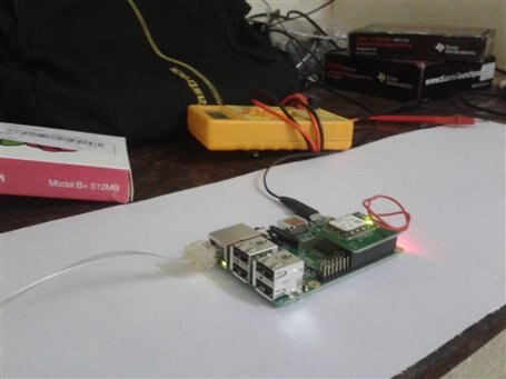

Happy news this week is I received raspberry Pi, EOP 350 programmer and the extra serving of Pi image. I have already tested openHAB and enocean Pi with my PC, so now it's time to move everything to raspberry Pi. These are some pics of my Pi mounted with enocean Pi, running openHAB.

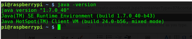

This tutorial assumes that you already have a working Pi installed with latest version of raspbian operating system with a working internet connection. The standard raspbian 7.0(Wheezy) also includes java components required to run openHAB. You can check whether java is installed  by executing in your raspberry pi command line.
java -version
and you should be able to see some thing similar to this :

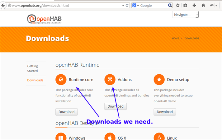

2. Download and install openHAB
Once your rPi is restarted, we can go ahead with openHAB installation. OpenHAB downloads section offers a variety of downloads. From that we need openhab-runtime and openhab-addons to be installed in our rPi.
I would recommend you to install openHAB in '/opt/openHAB/' folder, even though it will work even if you set it up under '/home/opehHAB' or anywhere for that matter. I go ahead with installing it under '/opt/openHAB/1_5' folder. First we have to make the directories :

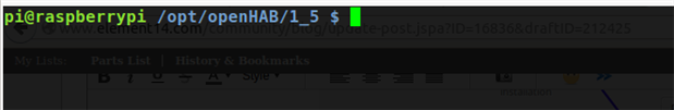

cd /opt
sudo mkdir openHAB
sudo chown -R pi:pi /opt/openHAB
mkdir 1_5/runtime
Now your pi terminal should look like this :
If you have already downloaded runtime and addons zip-packs in your PC, you can possibly copy this to rPi either using a pendrive or using your network( details under the section ***** ). If you haven't, then you can execute the following commands in rPi's terminal :
wget https://github.com/openhab/openhab/releases/download/v1.5.0/distribution-1.5.0-runtime.zip -O /home/pi
wget https://github.com/openhab/openhab/releases/download/v1.5.0/distribution-1.5.0-addons.zip  -O /home/pi
unzip /home/pi/distribution-1.5.0-runtime.zip -d /opt/openHAB/1_5/runtime
unzip /home/pi/distribution-1.5.0-addons.zip -d /opt/openHAB/1_5/runtime/addons
Now you have successfully installed openHAB in your raspberry Pi.

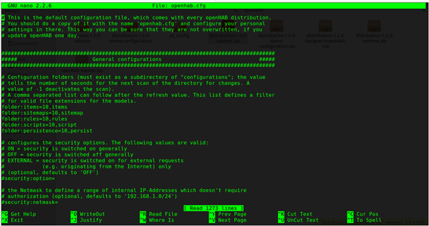

3. Configure openHAB
After you install openHAB, now we have to configure openHAB. First we have to create a configuration file. There is already a configuration file present in the standard runtime download. We'll rename and use it as our config file.
cp /opt/openHAB/1_5/runtime/configurations/openhab_default.cfg /opt/openHAB/1_5/runtime/configurations/openhab.cfg

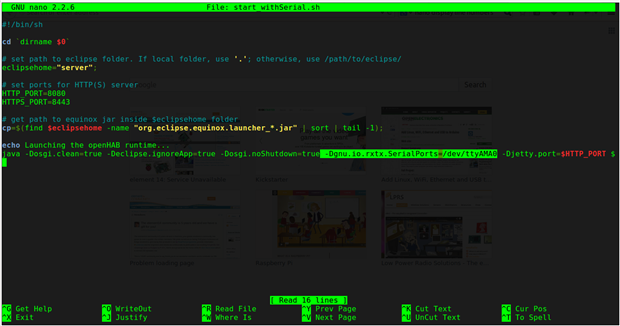

We need to edit a few things before getting started. If you are using rPi with a monitor or through a VNV viewer, you can use any text editor of your choice to make the changes. If you are using rPi headless, you can use nano to edit the config file. To start nano, use
nano -c /opt/openHAB/1_5/runtime/configurations/openhab.cfg
Nano window will look some thing like this :
We have to configure enocean sensors in this file.  Approximately at line 956, you have to make this edit.
enocean:serialPort=/dev/ttyAMA0
Press Ctrl+X to exit nano and while asking for saving the changes, give 'y'.
Now edit start.sh script and add the following at the last line of it :
-Dgnu.io.rxtx.SerialPorts=/dev/ttyAMA0
Save your change and close nano.

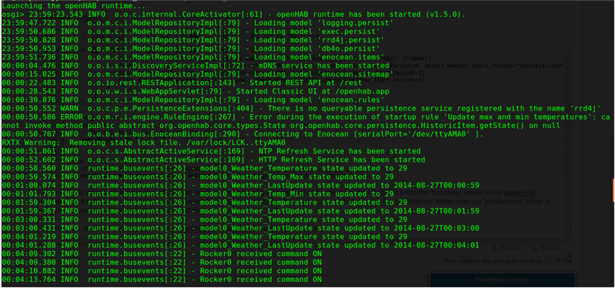

Now its time to start openHAB. Navigate to '/opt/opanHAB/1_5' and issue these commands :
chmod +x start.sh
./start.sh
Now you should be able to see some thing like this :
At this point, openHAB just sits there and blinks. We didn't configured any 'sites' for openHAB.

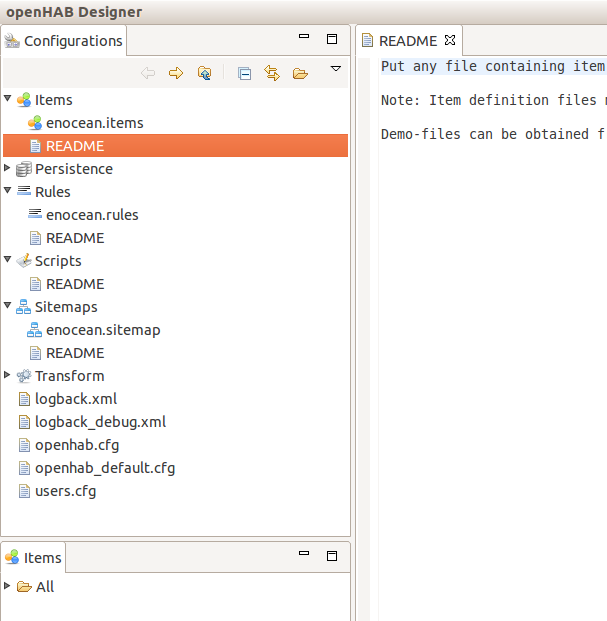

We will go ahead and create a openHAB site for enocean devices. For this you need openHAB designer. You can install designer in your PC and connect to rPi to create/edit sites. First we will create some files for this pupose. Execute these commands in your rPi terminal :
touch /opt/openHAB/1_5/runtime/configurations/items/enocean.items
touch /opt/openHAB/1_5/runtime/configurations/rules/enocean.rules
touch /opt/openHAB/1_5/runtime/configurations/sitemaps/enocean.sitemaps
touch /opt/openHAB/1_5/runtime/configurations/persistence/rrd4j.persist

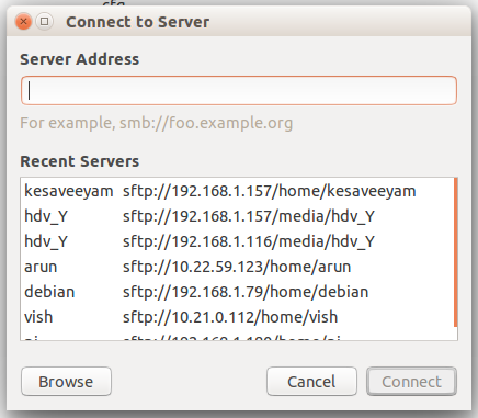

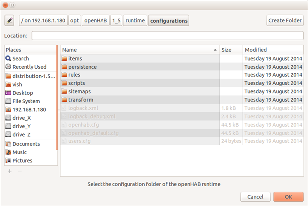

Opening rPi in openHAB designer( in a linux PC )
If you are in a linux system, you can follow these steps.

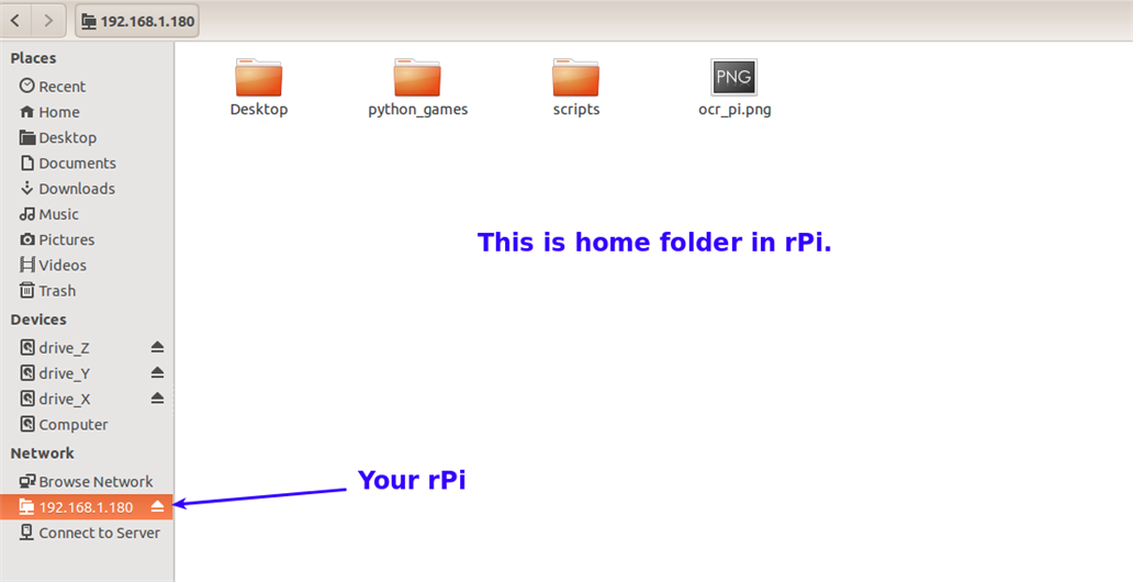

First you have to connect to raspberry pi from your PC's filemanager. I'm using nautilus( in Ubuntu ) and it have an option 'Connect to server' under 'File' menu. It will show a window similar to this.
1. In the 'Server Address' space type 'sftp://<raspberryPi_IP>
2. Give username and password when promted.
Now you will be able to view your home folder in Pi. Also you can notice in your file manager that under 'Network' section, your Pi had appeared.
Press Ctrl+L. Now your file manager will allow you to edit the location address. Give '<rPi_IP_address>/opt/openHAB/1_5/' and you will land on our openHAB installation.
Now open openHAB designer from your PC and select the configurations folder in your raspberry pi.
Now your openHAB designer will look like this :image
Now add the following contents to each of the files

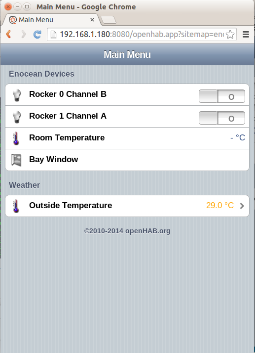

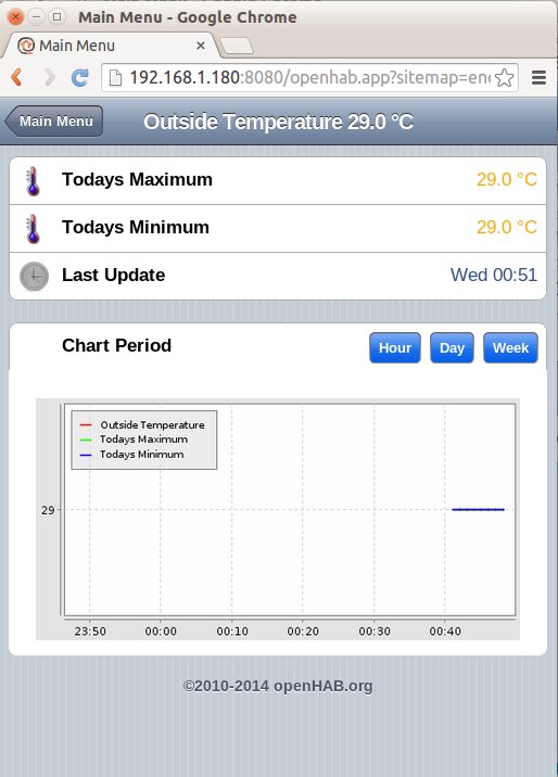

Now you can download the demo configuration available in openHAB website and unzip the 'transform' folder in it into the 'transform' folder of out openHAB installation. It will place a few yahoo weather related XSL files in that folder. If you want, you can also unzip the 'persistence' folder over our 'persistence' folder in rPi. But remember not to replace 'rrd4j.persist' file.
Now we are all set!! If you are not running openHAB, start openHAB by typing './start.sh'.
Now open Chrome and type in the address : http://<raspberry_pi>:8080/openhab.app?sitemap=enocean
and ........
openHAB home pageimage
weather chart
Hopefully you can tinker around the files I provided and add a few more visualizations and additional devices.
