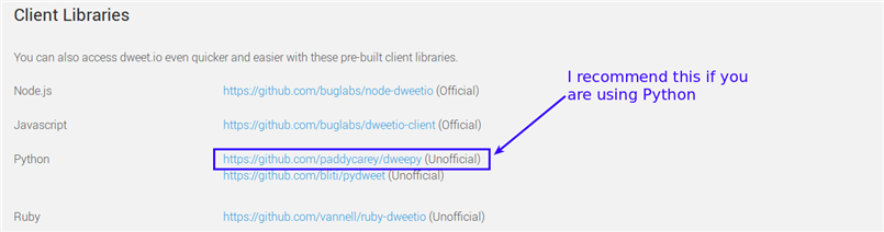

Cool, but are there any clients?
What is a great engine without a chasis? And what about a great solution with out any client libraries? But my question is do we really need one? Bug Labs have released two official clients in Node.js and Javascript. And they also lists unofficial python and ruby clients. I chose to walk the python way and tested both the clients : dweepy and pydweet. I liked dweepy more - it has support for real time streams which is very useful( or a must? ) when you are working in  project like this.

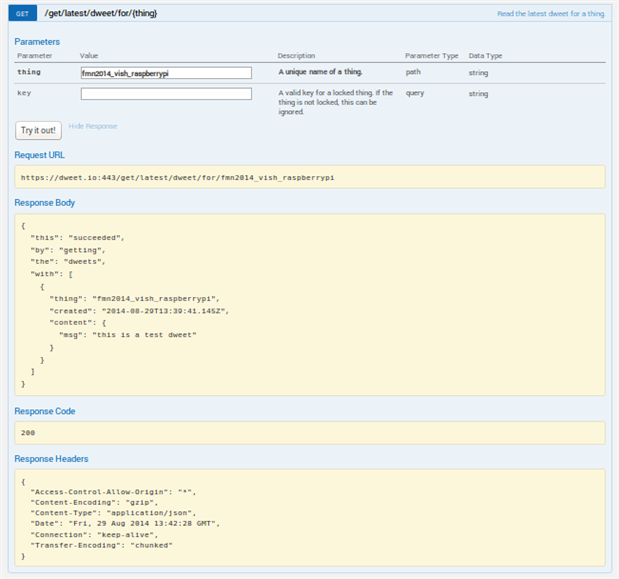

imageIf you go to https://dweet.io/play/ and check for your  dweet, you can see like this :
That means you have successfully posted a dweet.

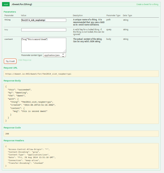

Now let's play with receiving dweets. Go to Dweet Play page and create a new dweet( like the one in the screenshot below ).

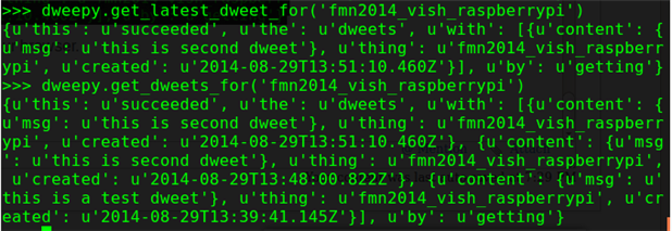

Now back in your python terminal, type :
>>> dweepy.get_latest_dweet_for('fmn2014_vish_raspberrypi')
and you will be able to see some thing similar to this :
Formatting is a little for the moment, but you can see that we got what we sent from our browser.
To get all the dweets from last 24 hours,
>>> dweepy.get_dweets_for('fmn2014_vish_raspberrypi')
and you will be able to get :
I'm having a few more dweets in this screenshot than I mentioned in this post.( I played a little more dweeting image )
