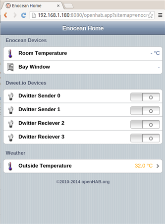

and my sitemap now looks like
// enocean.sitemap
sitemap model0 label="Enocean Home" {
    Frame label="Enocean Devices" {
        // Switch item=Rocker0 label="Rocker 0 Channel B"
        // Switch item=Rocker1 label="Rocker 1 Channel A"
        Text   item=TempEnocean valuecolor=[>25="orange",>15="green",>5="orange",<=5="blue"]
        Text item=myWindow
    Frame label="Dweet.io Devices" {
        Switch item=Dwitter0 label="Dwitter Sender   0"
        Switch item=Dwitter1 label="Dwitter Sender   1"
        Switch item=Dwitter2 label="Dwitter Reciever 2"
        Switch item=Dwitter3 label="Dwitter Reciever 3"
    Frame label="Weather" {
        Text item=model0_Weather_Temperature valuecolor=[model0_Weather_LastUpdate=="Uninitialized"="lightgray",model0_Weather_LastUpdate>90="lightgray",>25="orange",>15="green",>5="orange",<=5="blue"] {
            Frame {
                Text item=model0_Weather_Temp_Max valuecolor=[>25="orange",>15="green",>5="orange",<=5="blue"]
                Text item=model0_Weather_Temp_Min valuecolor=[>25="orange",>15="green",>5="orange",<=5="blue"]
                Text item=model0_Weather_LastUpdate valuecolor=[model0_Weather_LastUpdate>120="orange", model0_Weather_LastUpdate>300="red"]
            Frame {
                Switch item=model0_Weather_Chart_Period label="Chart Period" mappings=[0="Hour", 1="Day", 2="Week"]
                Chart item=model0_Weather_Chart period=h refresh=600 visibility=[model0_Weather_Chart_Period==0, model0_Weather_Chart_Period=="Uninitialized"]
                Chart item=model0_Weather_Chart period=D refresh=3600 visibility=[model0_Weather_Chart_Period==1]
                Chart item=model0_Weather_Chart period=W refresh=3600 visibility=[model0_Weather_Chart_Period==2]
I've added four new switches to items and wired them as mentioned above.
If you want to check your openHAB site now, it should look like this :
