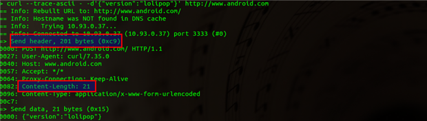

IoT is the place of billions of devices and most of them are power constrained. When they communicate, the network load is definitely going to shoot up. We have been using HTTP for these device to device communications for a while. But let's check what happens when I want to update some status to a remote server using HTTP. I fired my terminal and send a simple message to some server and this is the result :
Can you see that?? To send just 21 bytes of payload, I ended up sending 201 bytes of header data. Let's calculate efficiency( I'm not sure whether I can call this efficiency, but for now please bare with me ).
21 / (21+201) = 9.5%
That clearly means we are in trouble if we want to sens some sensor readings to a remote server via HTTP image. Let's check what happens when you send same data through MQTT to a broker. MQTT has thing thing called "Fixed Header" of 2 bytes. And if your payload is less than 128 bytes, then this will be the only additional information in the packet you send. And for every additional 127 bytes of payload, you need to add 1 byte of variable header to the packet, uptill a payload of 256MB. So now the efficiency is
21 + (21+2) = 91.3%
That's almost 10 times increase. image. Let's do one more experiment. This time, send 127 bytes and calculate efficiency :
HTTP :     127 / (127+201) = 38.6%
MQTT :       127 / (127+2) = 98.4%
It's clear, MQTT rocks!! This because HTTP is a (basically)document centric protocol while MQTT is agnostic of data content and transfers simple byte arrays, making drip-feeds of updating information trivial. Also if you want to send data to multiple clients with HTTP, you will end up sending it to every subscriber individually. With MQTT, send it once to broker and broker takes care of rest. Again thumps up MQTT!

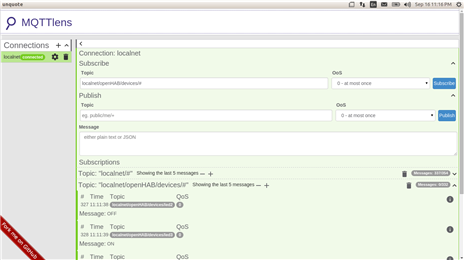

1. MQTT Lens( Chrome App ) : I'm a fan of this, for it's simplicity.I will be using this in my demo. This is quite intuitive to use and opensource tooimage. You can add it to your chrome from chrome store.

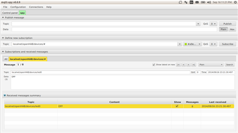

4. mqtt-spy( Linux/Mac/Win ) : An open source GUI desktop client for Linux/Mac/Windowsimage.

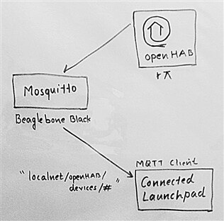

Step 1 : Setup local broker( skip this step if are using a public broker )
     I chose to setup a local broker because I don't want all the ON/OFF, OPEN/CLOSE this/that information to be sent through internet. I could have setup my local broker in my raspberry pi, but I chose to do it on my beaglebone black running latest version of debian build. After checking through Eclipse Paho project, I decided to install Mosquitto as my broker. You can install it by typing ( works with rPi raspbian and BBB debian )
sudo apt-get install mosquitto mosquitto-clients python-mosquitto
Once installed, mosquitto will automatically start at port 1883 and will add itself to startup so that you don't have to add it everytime you turn on your rPi/BBB. If you want to stop mosquitto, just execute :
sudo pkill mosquitto
Mosquitto( I think all MQTT brokers ) by default runs at port 1883. If for some reason want to change this, you can start mosquitto with this command :
mosquitto  -p 1729
where 1729 is the port number I want mosquitto to listen to.
Also if you want to have more tighter control over your mosquitto broker, you can make your own configuration file and specify it while starting mosquitto like :
mosquitto -c myconfig.conf -p 1729
Using configuration files, you can set additional security options like TLS/SSL encryption, username/password protection etc. A detailed explanation on how to do this is available at mosquitto.conf
Testing broker : To test the broker, I chose to use MQTT Lens from my PC and MyMQTT from my smartphone. I made both my clients to subscribe to topic "localnet/device/intro". Then from my smartphone, using MyMQTT, I send a plain text message "Hello MQTT, this is MyMQTT" to the same topic which I expected to be received by both MQTT Lens and MyMQTT.
I also send a JSON object from my smart phone on same topic, which also MQTT Lens displayed nicely. Test pass!! image
Step 2 : Setup your arduino/Lauchpad client
If you are using arduino, this part is quite easy. PubSubClient is a library enables arduino to talk MQTT. It works with arduino Ethernet board and with most of the ethernet sheilds. Lots of people are using it and it works quite well for them, but I failed miserably when I tried to use it with Adruino Galileo.
If you are using TI Launchpad MSP430F5529, then you can follow this blog where Adrian uses a modified version of PubSubClient library to run with energia IDE.
But what I have is a EK-TM4C1294XL Launchpad and his modified library gracefully crashed on my launchpad. So I ended up debugging the library whole weekend( it was fun image) and modified it to work with my launchpad.( If any one wants modified code, send me a message. I'll happy to share it with you. )
Testing launchpad MQTT client : I want my launchpad to listen to rocker switch related messages from openHAB and toggle my bed lamp accordingly. Also I want my node to identify itself when it connects to broker. So when connected, this node should send a hello message on the topic "localnet\device\intro" with message "Hello, I'm Launchpad". I should be able to see this message on MQTT Lens. This is my entire code( I hope it's self explanatory ). It will subscribe to particular messages from openHAB and switch leds accordingly. This code is supposed to work with arduino too.
