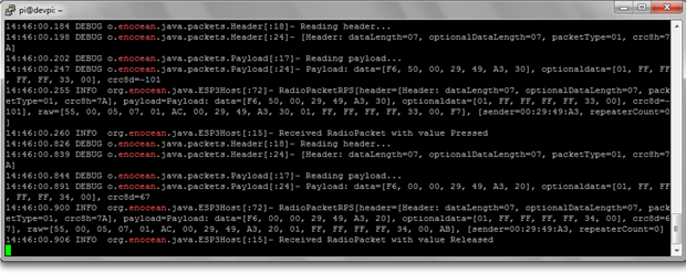

  • I now ran ./start_debug.sh as I want as much data as I can get my hands on and let the script do its thing. If nothing went wrong after a while in the terminal running tail you should see:-
    INFO  o.o.b.e.i.bus.EnoceanBinding[:290]- Connecting to Enocean [serialPort='/dev/ttyAMA0' ].
    Nice, openHAB is doing its thing and once we have hit this line the webserver should be running and the EnOcean items should of also been loaded. We should now be able to navigate to http://<ADDRESS OF PI>:8080/openhab.app?sitemap=<SITEMAP NAME> for me using the name "home" for my items and sitemap this will be:-
    http://192.168.1.248:8080/openhab.app?sitemap=home and we should be presented with the default webpage style with two switches (one for each channel on the one switch)
    Well the items I defined in home.sitemap are being displayed, its a good start now lets see what happens if I press a button on the switch.
    Woo Hoo... The page auto updated and changed to reflect the button press. The tails|grep logging also showed data

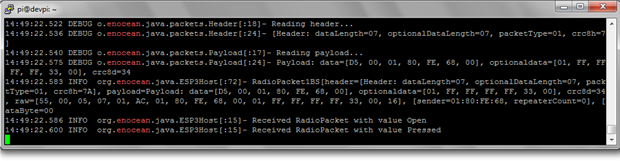

    openHAB is receiving data from the sensors. So now lets press the buttons on the other two sensors I have. First the contact sensor (note: I cleared the terminal screen between these screenshots)
    Where we can see "sender=01:80:FE:68" that is the ID for the sensor, bingo. note that down and push the button on the temp sensor

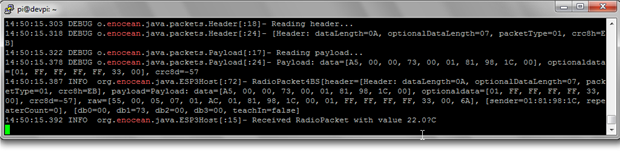

    And there we have the id for the temp sensor too.imageimageimageimageimage

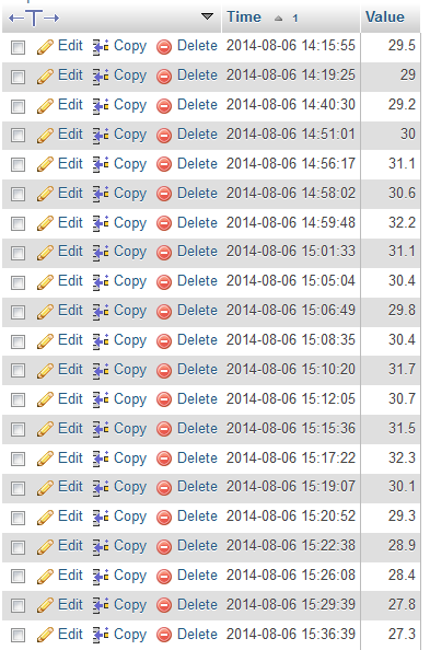

  • For logging the data I decided to use MySQL as its something I have experience in using and there is a simple to install package for it. Calling "sudo apt-get install mysql-server mysql-common -y' was all is needed to install the mysql server on the Raspberry Pi. I also installed lighttpd and php5-cgi because a) I'm feeling lazy and wanted to use phpMyAdmin to help manage MySQL and b) I will be using some simple php scripts for displaying my logged data. I won't go into details about setting up lighttpd in this blog post, if people ask for those details I will happily right them up in another post. Once I had MySQL/PHP/lighttpd/phpMyAdmin setup I created a user for openHAB which a matching database and created a created another user for reading the database and linked it to the same database.

    I connected to the database using phpMyAdmin and I could start seeing data being inserted.
    From this point I can create PHP report pages however I like to display the data. This is also away from the openHAB server so I can publicly link to it and it doesn't create a bridge back to the openHAB server. I created a very simple PHP page to just print out this data https://pi.fmkapp.uk/temp.php This page is hosted on the Raspberry Pi using lighttpd and PHP and is pulling data from the MySQL DB running on the Pi which openHAB is injecting data into. The temperature drop from 1:20 AM to Midday was because I wanted to see if I could log the data from the temperature sensor whist it was sitting in my fridge, it turns out that a) I can :-) b) I need to adjust the temp in my fridge a little, its a little bit too warm in there.image
