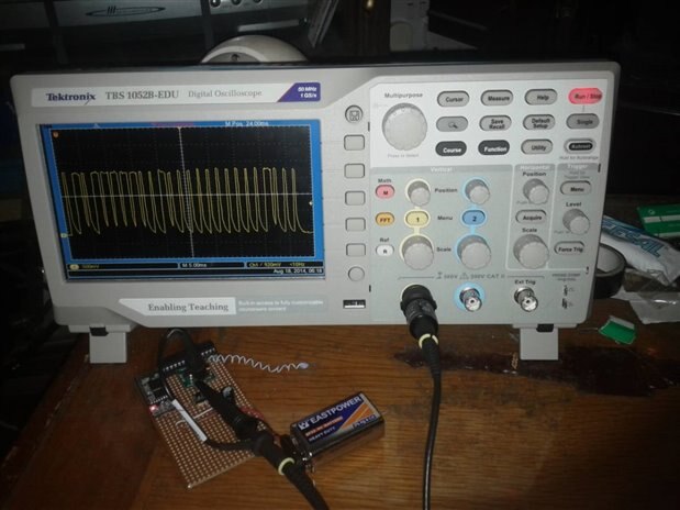

A brief note on the Oscilloscope, due to a miscommunication we got the TBS1052B-EDU which is the 50Mhz little brother to the TBS1202B-EDU. No big deal the TBS1052B-EDU is still more than suitable for my needs. Its the first scope I've had any I'm more than pleased with it. My plan for the scope is to help me build this energy monitor and to help reverse engineering some other off the shelf projects to add them to my project.

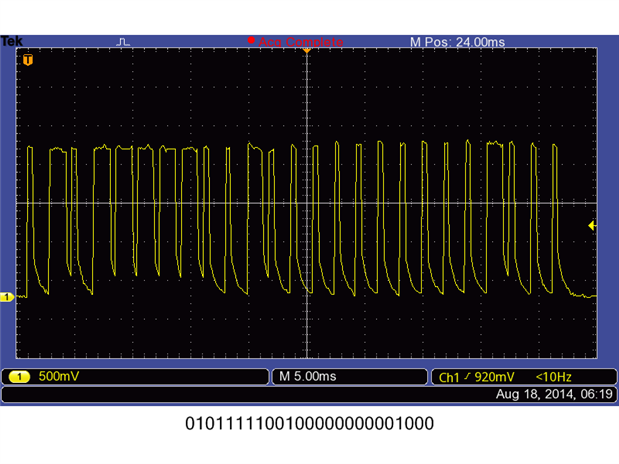

One of the products I want to reverse is some off the shelf Power Switches. These normally work off a 433Mhz signal, Using the scope I can quickly sample this signal and figure out the bit's and timing of the signal. I'm still waiting to get some of these sockets but while I wait I've been getting to grips with using the scope I've been using it to analyse some past projects. In the past I've had to use my computers sound card to capture this data, which isn't ideal but I've always just used the tools to hand and hack them when they weren't really designed for the task at hand. So instead of having to mess around with using a sound card I was able to just grab one of my older project and connect to the data line and quickly signal shot the data.
Having the scope connected to a computer I can quickly capture the waveform data and screenshot of the scope to the computer.
As this is a past project I can quickly decode the captured data. So using the same technique I should be able to quickly sample the signal for these switches and add them to my project.

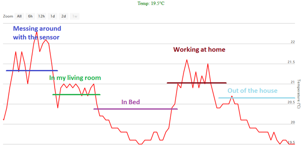

This brings me onto the issue of privacy. After I started logging the temp data from the EnOcean sensor I decided to plot that data on a graph. It was pretty cool, I could see how the temp of my office changed over the day even to the point where I could pick out when I was asleep, when I was working in my office, when I was in other rooms of the house and when I wasn't in the house. Woah... Hold up a min. A temp sensor in my office can tell when I'm not at home. With just 0.1 degree of actuary I started picking out patterns in the data that followed my activities in my home. Here let me show you.
(This is just a small sample of the data) I was sitting at the pub with some friends and one of them asked me how the project was going, so being the geek I am I pulled out my tablet and pulled up the graph. While talking about the project it hits me like a ton of bricks, this publicly accessible website is broadcasting to the world my household pattern. If you had access to this data for a good period of time you would be able to start picking out the patterns us humans love so much. A Temp drop during the night, most likely they household is in bed, a temp drop during day time, probably no one is at home.
While this data would be great for some machine learning applications (such as automatically figuring out the best time to heat/cool your home) my black hat insistently started thinking of the security implications, what is the best time to go and do something naughty at someone's house? When they are not at home. Sure this data and pattern's can also be learnt by following that person but that involves you staking out their home or actually following the person in question. If their home is willing to just tell you this data it lowers the risk.

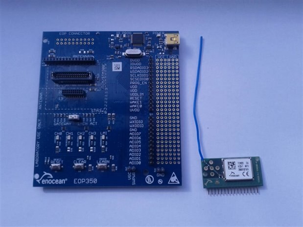

I've also received an EnOcean EOP350 programmer kit.
This was something I wasn't expecting. Basically it upgrades the starter kit to a developer kit, It will allow me to experiment with creating actuators and sensors based on the EnOcean platform. This was something I was going to attempt to do anyway but the inclusion of this kit will greatly help, it was just unexpected. So I'll be also be reading up on this too. People in my local do tend to read books, thanks to e-readers I tend to read data-sheet's in the pub, thanks EnOcean and Farnell you are not helping my geek reputation image

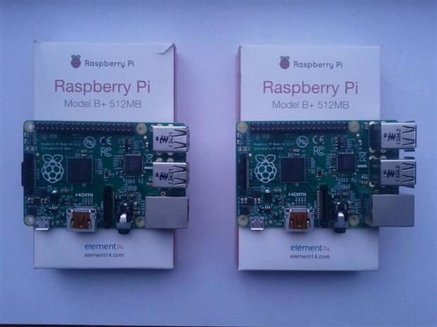

Also in the surprise front. I received another Raspberry Pi Model B+ in the delivery the Oscilloscope and EOP350 came with. (Off Topic Note: The box these came in proved to be an infective cat trap.)
I did contact doctorcdf via e-mail but have yet to hear back if Element14 Will want this extra back. If not I'm sure I can find it a good home. One of my friends has been expressing an interest in the Raspberry Pi so if the Pi doesn't have to be returned to Element14 I will donate it to this friend and spread some Raspberry Pi love.
<EDIT> As michaelwylie points out This extra pi isn't a mistake. So I think I'm just going to surprise my friend who has expressed an interest in the platform with the extra Pi.I might "test" him first, take it to the pub with me, get a few beers down his neck, ask him some questions about what he will use it for and then just hand it over and say "Go Build". I'll try and poke him towards Element14 too and say post what you build here as a thank you. </EDIT>
