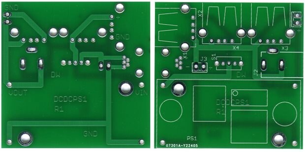

Here is a picture of the PCB back from manufacturing:
Note how well my scanner can see through the cards - the traces on the other side appear as dark traces.

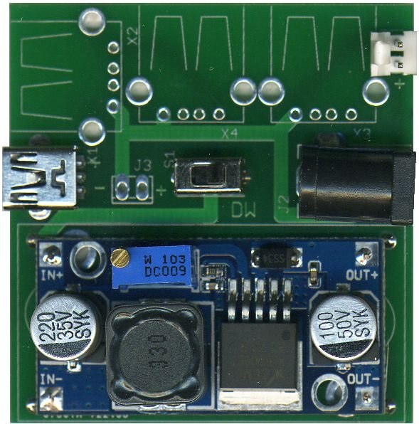

Here is the assembled module populated with the components I need for my 5V to 12V converter application - and it works well:
Although the 15 minutes I spend designing, assembling and testing this card could have been spent hand-wiring an equivalent solution, I got 10 cards at $1 per card and they can be populated with different modules and connectors to provide different power supply requirements, including a switched USB power hub, all with no re-design.
