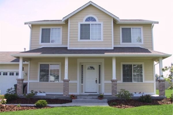

My application program simply displays a house image where the sensors status is an overlay graphic on the appropriate feature of the house. Here is an image of the house with no sensor indicators:

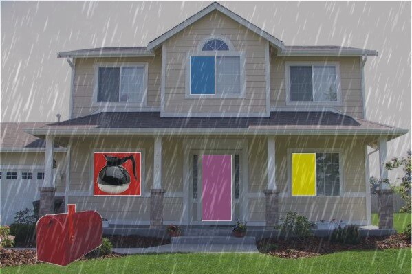

Here is a picture of the house showing all sensor indicating: rain, window open, door unlocked, coffee maker on, mail in the mailbox. This method of showing sensor status is intended to be very simple and intuitive.
The house sensor status image may also be accessed by a smart phone - shown in a couple of the videos below.
