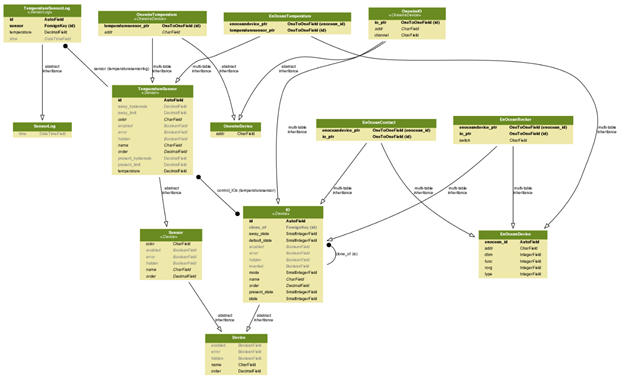

Following is the current UML of the models, created with the help of excellent django-extensions.
Image 3: UML of current software
As one can see, the whole software at the moment is Device -based. Every object is a Device. After this, it's divided into two main groups; Device is either a Sensor or an IO. After this it does get a bit complicated, but basically that's all you need to know, if designing an user interface etc. There's of course still a lot to come; I'm not even close to finished. I haven't even implemented the most basic functions of the current system, which includes cameras, AD-converters, tasks, home/away -states etc. Most of the stuff will still be derived from Device, but some additions will come; Devices will have different states depending on the system state etc.

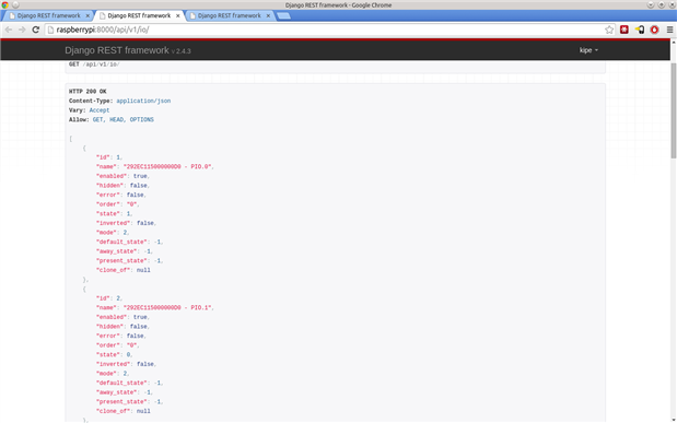

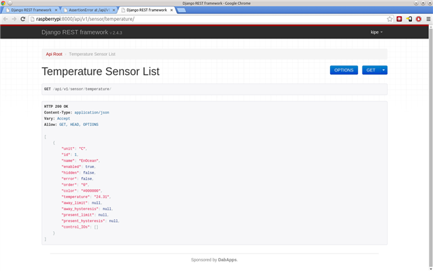

API
At the moment, only three of those models are visible outside of the program via the web API; IO, TemperatureSensor and TemperatureSensorLog. This is about to change though, as I noticed a design flaw. There's no need to expose TemperatureSensor etc, just use Sensor and SensorLog. After this, it'll be up to the UI to decide how to group them.
This is because a sensor is always one and exaclty one Device. If a sensor includes multiple measurements, they are added as different Devices.
Following is a few screenshots of the development API view, which is provided by Django REST framework.

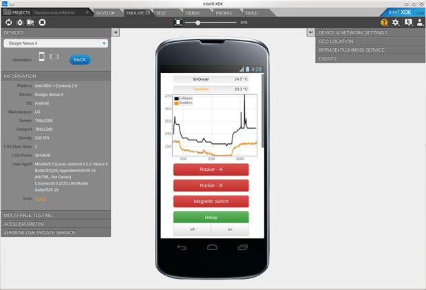

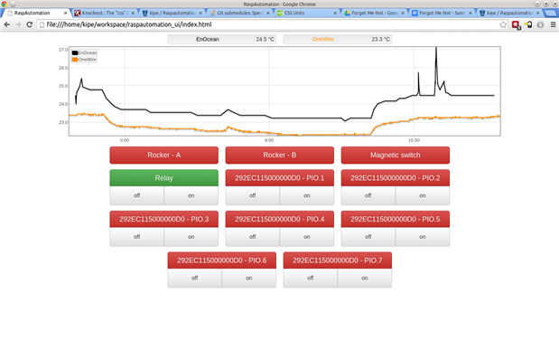

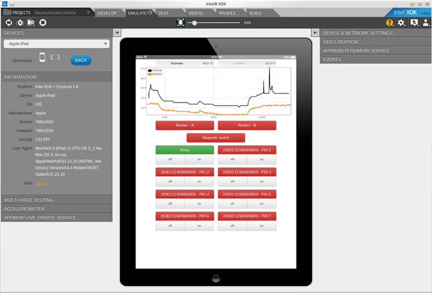

Keeping with the idea of API, the user interface is basically a separate project, which can be deployed on practically any device. This can be a PC, laptop, tablet, mobile phone or even another Raspberry Pi. Thanks to the UI being based on HTML/JSS/JavaScript, it is very easily ported and looks roughly similar on every platform.
I actually set up the UI today to run on basically every mobile device out there with the help of Intel XDK and all I needed to do was to add 6 lines of code. No removals or replacements, just add 6 lines. Following is the UI running on a desktop browser and the emulator inside the XDK (Nexus 4 and iPad). All systems are fully functional and the UI is updated simultaneously when I press a button (physical or in the UI), thanks to websockets. I have also tested the application on my phone and it works as planned.
