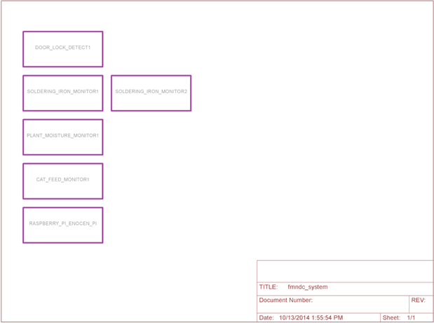

The three other monitor modules are also placed on the main page along with the module for the Raspberry Pi and EnOcean Pi. Since all the connections between the monitor modules and the RPi are wireless, I chose not to include these wireless connections as ports on the module. The Port command can be used to add signals to the Modules when they are needed.

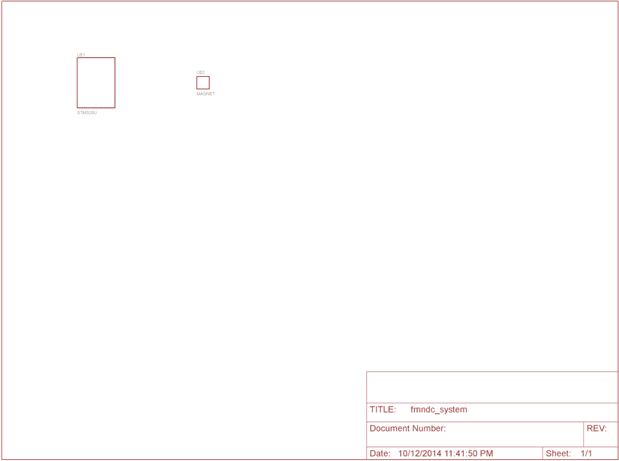

Figure 3 shows the schematic for the door lock monitor schematic page. Presently, this preliminary schematic contains only a STM320U Magnet Contact transmitter module and a magnet. As my design matures, new components can be added and new schematic pages can be added as needed.

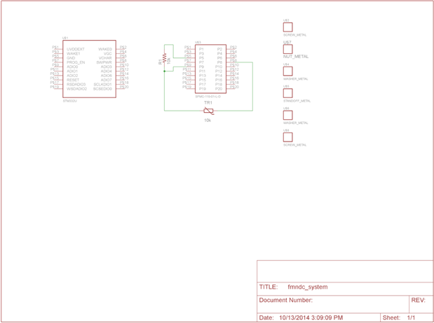

Figure 4 shows the soldering iron monitor schematic page. This schematic page contains a STM332U temperature sensor module, a Samtec connector that mates with the connector on the STM332U sensor, a resistor, thermistor, and the mounting hardware to mount the thermistor to the soldering station stand (screws, nut, washers, and standoff). The resistor and thermistor leads are to be soldered to the connector so that the STM332U can be easily removed and not hacked up.
The resistor and thermistor form a resistor divider that is connected between SWPWR (switched power) and ground. The center tap of the resistor divider is connected to ADIO0. This analog input will be used to transmit the resistor divider voltage to the RPi so that the temperature of the soldering iron can be determined. If the temperature is above a certain value then an alert message can be issued by either the FHEM server or OpenHAB server.
Figure 4
According to EnOcean technical support, the Samtec mating connector part number for the connector on the STM332U is FLE-110-01-G-DV. This is a surface mount connector. On the Samtec website, I found a through hole equivalent mating connector (SFMC-110-01-L-D) so that I can hand solder the resistor and thermistor to it. I also found the equivalent connector on the STM332U so that I could add the same connector to a STM320U, if needed. This connector number is FTSH-110-01-L-DV.

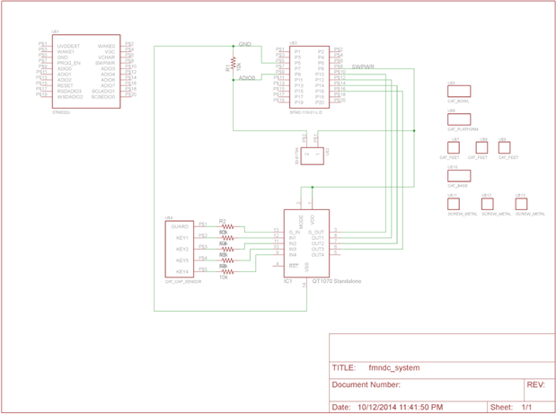

Cat Feed Monitor
Figure 5 shows the cat feed monitor schematic page. This page contains a STM332U, connector, Force Sensing Resistor (FSR), capacitive touch sensor, bowl, and the hardware for the base, platform, screws, and feet. The connector is the SFMC-110-01-L-D (same as above), and the capacitive touch sensor board comes from Adafruit. It connects to SWPWR and ground for power and provides an indication that the cat touched the metal bowl. The outputs from the capacitive touch sensor connect to the digital inputs of the STM332U. The FSR and resistor form a resistor divider between SWPWR and ground. The center tap of the divider is connected to ADIO0 and provides an analog voltage proportional to the force on one of the platform's feet. As the cat food is consumed the force should be reduced, resulting in a change in divider voltage that indicates that the cat has fed.
Figure 5

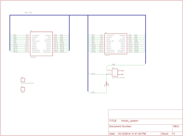

Plant Moisture Monitor
Figure 6 shows the plant moisture monitor schematic page. This schematic page contains a STM332U, a HSM 100 moisture sensor, resistor, moisture probe, housing, and a tube. The moisture probe will be made from two galvanized nails and will form a resistor divider with the fixed resistor R1. This divider is connected between SWPWR and ground. The center tap of the divider is connected to ADIO0. The voltage from this divider will provide a secondary means of determining the soil moisture content. The HSM 100 moisture sensor reports the measured humidity as an analog voltage on ADIO3.
Figure 6

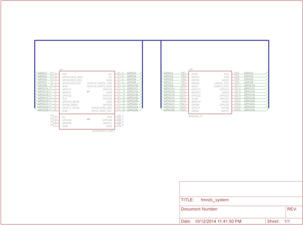

Figure 7 shows brains and transceiver of the sensor network. This schematic contains a RPi and EnOcean Pi.

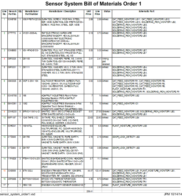

Bill of Materials

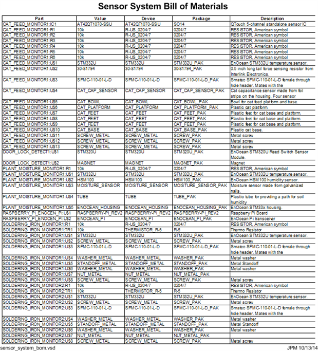

Figure 8 shows the Bill of Materials for this design from all schematic pages and modules. Each component is associated with a Module name and a schematic name. The value of the component is shown along with the device, package, and associated library.
Figure 8

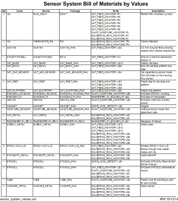

Figure 9 shows the BOM by the Value of the device. This BOM is a handy way to determine the total number of each component required. I still need to order components for the tube or the moisture monitor, cat base, cat platform, feet, and make the touch sensor out of copper foil once the cat platform is constructed. The STM332U, STM 320U, and SFMC connectors have not arrived yet.
Figure 9
I tried using Designlink to create a BOM that I could order from Newark.com, but it would not generate a list of components from the schematic. I suspect an incompatibility with the hierarchical schematic. Eagle technical support indicated that this and many other User Language Programs (ULPs) must be updated to handle a hierarchical schematic. I created a copy of the schematic and manually flattened it. I tried to use Designlink again but it was offline. So, I created my BOM manually on the Newark.com website. Figure 10 shows my Newark.com order for most of the items in the BOM.

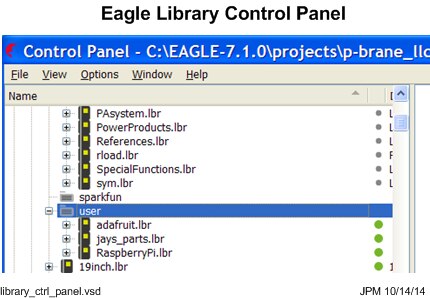

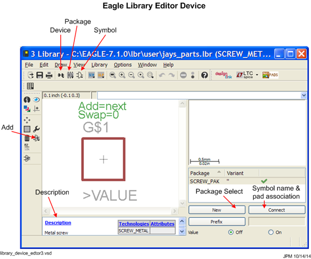

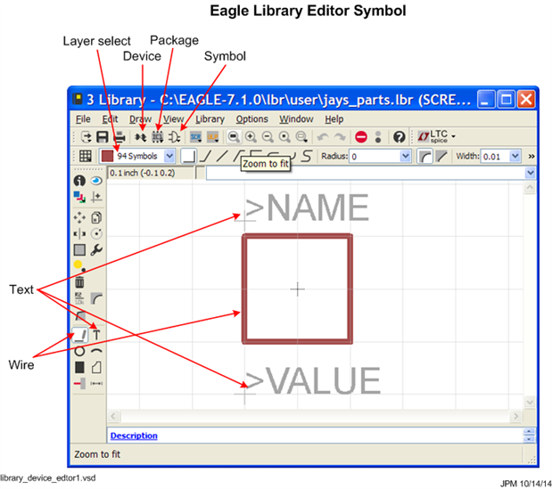

I started by creating a project library using the Eagle Control panel (see Figure 11). I selected the user directory, and then selected File -> New -> Library and typed in jays_parts.lbr.
Figure 11
Once the library was created, I opened it by double clicking on the filename. I made a component for a screw, for example, by clicking on the Symbol button and gave the new symbol the name SCREW_SYM. I used the Wire command to draw a rectangle around the center of the symbol identified by the + sign (see Figure 12). The wire line should be drawn on layer 94. Next, I used the Text command to add the name variable >NAME and placed it on layer 95. The value variable >VALUE was then added at the bottom of the symbol on layer 96. I would forget to change to the proper layer frequently and this can be fixed any time by clicking the symbol button, selecting the name of the symbol to be fixed, and the using the Change -> Layers command to put the variables on the correct layers (most common error for me).
Figure 12

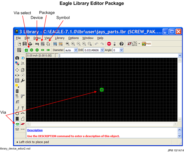

Next, I clicked on the Package button, and entered the package name as SCREW_PAK. I adopted the _SYM and _PAK filename postscripts to easily identify symbol and package files when building the device later on. Figure 13 shows the package editor. If a via or pad is needed for the package, then the Via button is clicked, the Via selected along with the required size. The manufacturer's datasheet should have a recommended via diameter and drill size. If not, then IPC-2221 [8] or MIL-PRF-55110 [9] can be consulted for the recommended via pad diameter and drill size for the diameter of the lead of the package. If pads are required, then pin 1 is usually placed as a square pad that is placed starting at the origin, and the remaining pads are placed as round pads with the appropriate spacing. Starting at the origin makes it easy to place the pads on the correct centers. Once all the pads are placed, then they can all be moved as group so that the origin is in the center of the pad field. This seems to be the common configuration for packages in the Eagle connector library. In this case, I just did not include any vias and saved the file.
Figure 13
Next I clicked on the Device button and created a new device called SCREW_METAL. I added the SCREW_SYM by clicking the Add button and selected the symbol from my library (jays_parts.lbr). The Package was added by clicking on the New package button on the right side of the window and selecting SCREW_PAK. Since my package does not contain any vias or pad, there is no need to associate the pads with the pin symbol names (which don’t exist in this case either) using the Connect button. I found that adding a description to the devices was very helpful, as it shows up in the description column of the library when adding components and helps with searching for components. See Figure 14.
Figure 14

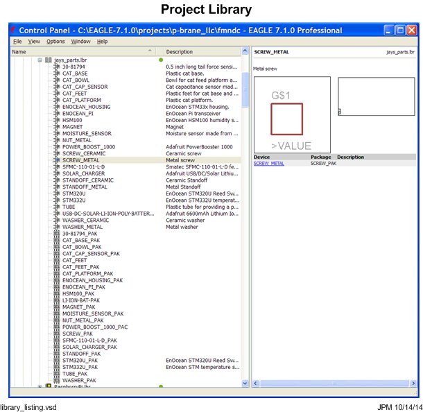

Figure 15 shows all the components (Devices) I created to make the schematic.
Figure 15

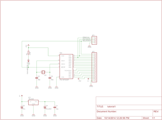

Figure 16 shows my Eagle V7 tutorial schematic, and I used this schematic and layout to demonstrate the eagleUp plugin.

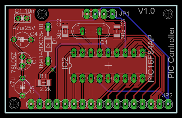

Figure 17 shows the resulting layout generated from the schematic and tutorial directions. I chose to lay out the board a little differently that what is shown in the tutorial.
Figure 17

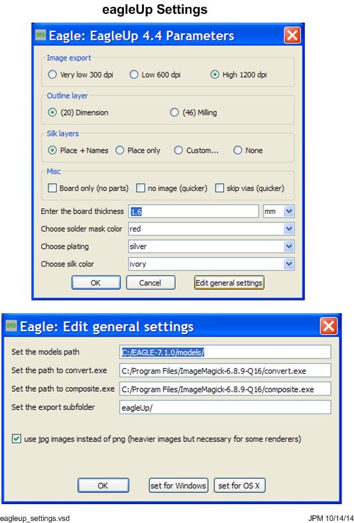

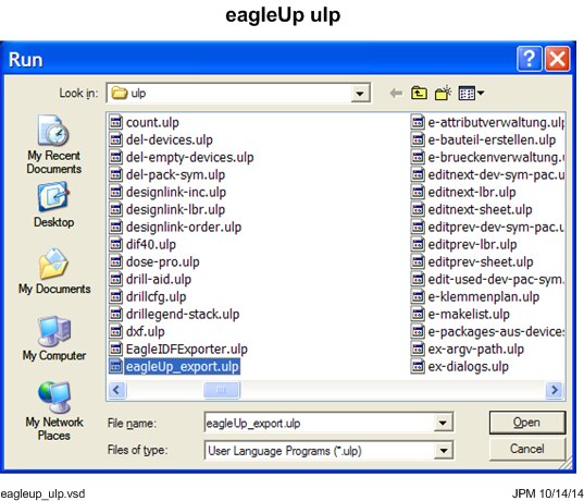

To eagleUp the layout, I ran File -> Run ULP and select eagleUp_export.ulp (see Figure 18).
Figure 18
I selected the default settings on in the EagleUp Parameters panel that pops up and made sure that all the paths were set correctly in the general settings panel.
Figure 19
The eagleup ulp generates the file \eagleUp\tutorial1.eup when complete.

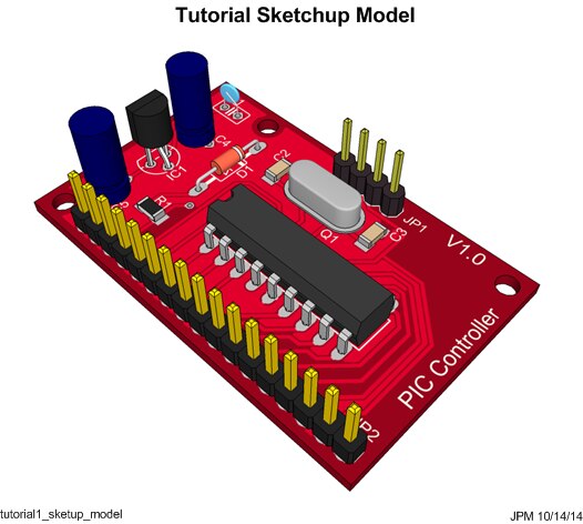

Next, I ran Sketchup and deleted the default figure, set the length units to millimeters by going to Window -> Model Info -> Units and selecting Millimeters from the pull-down menu. I imported the eagleUp file generated from the eagleup exporter using Plugins -> Import eagleUp V4.4 using the file C:\EAGLE-7.1.0\projects\examples\tutorial\myproject\eagleUp/tutorial1.eup. A lot of windows pop up one after another from the ImageMagick converter. A dialog box then pops up and indicates that all my packages are quite large and asks: Do you want to resize it?. I indicate Yes to all packages. Sketchup builds of each component one at a time and places it on the PCB. The result can be seen in Figure 20.
Figure 20
This is the coolest thing ever! I did have trouble with missing components (Sketchup models). I found most of them at the 3D warehouse [14], and placed them in the model directory in their own directory. I had to change the name of the models to match the package name used by in the Eagle library. The electrolytic capacitors used the TAP5-45 package, and this turns out to be a Panasonic 470 uF electrolytic capacitor measuring 5mm x11mm. tknelms posted a 5mm x 11mm electrolytic capacitor on the 3D Warehouse and called it “Electrolytic Capacitor 5x11.skp”. After downloading this model to C:\EAGLE-7.1.0\models\eagle_tutorial_parts, I renamed it TAP5-45.skp. The eagleUp Sketchup importer then found the component. I did this for the 1x04.skp, 1x17.skp, and the TO92.skp models as well. When the import was complete, I just had to move the 1x04 header over into the correct position to match the via locations. There is a mismatch between the centers of the Sketchup model and the Eagle package location on the board that I have yet to identify.
