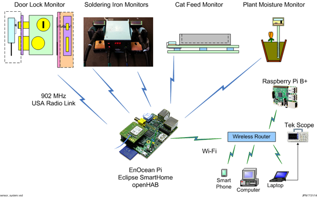

My original proposed sensor system is shown in Figure 1. The system consists of a door lock monitor, soldering iron monitors, cat feed monitor, and a plant moisture monitor. The door lock monitor is based on the STM-320U Magnet Contact Transmitter Module, and the soldering iron, cat feed, and plant moisture monitors are based on the STM-332U Temperature Sensor Module.
Each of the monitors and transmits data to a Raspberry Pi Model B+ with a EnOcean Pi Transceiver Module that is captured and processed by the Friend Home automation and Energy Management System (FHEM) server or by the OpenHAB server. These servers are core tools to upgrade my 100+ year old Victorian home into an Internet-of-things Smarthome. My long term goal is to make our home more energy efficient.
Figure 1
