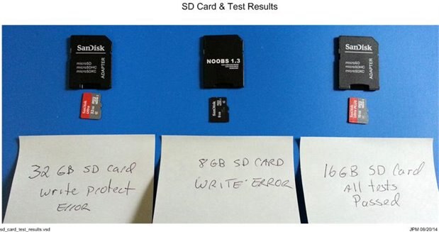

Right off the bat, I ran into problems with my SD cards. Awhile back, I purchased an 8 GB SD card with NOOBS 1.3.0, and a couple of SanDisk Ultra 32 GB Micro SD Card (class 10) with an SD card adapter to work with my existing card reader/writer and my Raspberry Pi Model B (not associated with this design challenge). I figured that 32 GB would give plenty of room for my files and OS growth over time. These class 10 devices write at 10 MB/s so they should be fast, too. I purchased the specific 32 GB SanDisk SD cards based on the recommendations on the elinux.org RPi SD Cards web page [3]. Apparently, not all SD cards work well with the RPi, so check it to make sure your SD card is compatible.
At the same time, I also purchased a USB hub that turned out to be faulty right out of the box. It had two 2 A ports for powering high current devices like phones and the RPi because the RPi needs 0.7 to 1.5 A and the typical USB port only provides 500 mA. One port would not power the RPi but the other  port did, so I did not think much of it at the time. I think the failed USB hub damaged two of my memory cards in the process (one of the 32 GB SD cards and the 8 GB SD card with the NOOBs 1.3), but I did not realize this at the time. I returned the hub for a replacement and the new one works fine now (D-Link Hub 7). It’s been a few months and I forgot or did not realize that the SD cards were bad or damaged, so I purchased a new SanDisk 16 GB SD card. Fortunately, all the SD cards were all fully tested before trying to install the NOOBS 1.3.9 OS onto them. A bad memory card would result in an unreliable operation of Linux on the RPi. The test procedure is shown in Figure 1.
Figure 1

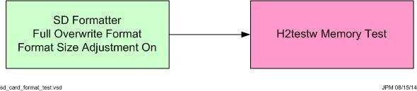

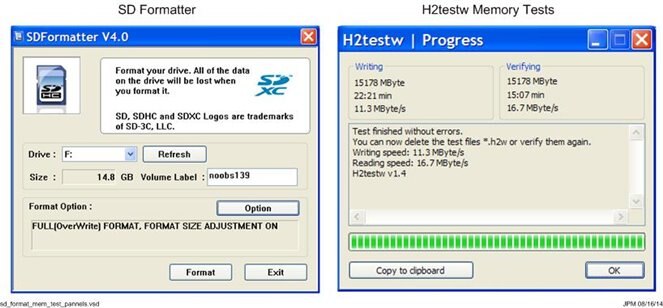

The SD Formatter was run and the drive containing the SD card was selected along with the Full Overwrite Format and Format Size Adjustment On options. The full overwrite formats every address on the entire SD card, not just the File Allocation Table (FAT), so it takes awhile to run, but this helps ensure that the SD Card really works. The H2testw writes files to fill the SD Card, and then the files are verified. This results in a write check and then a read check. Table 1 summarizes the results of the formats and tests of the three SD cards.
Table 1
Card
SD Formatter Errors
H2testw Errors
32 GB SanDisk Micro SD Card
Write Protect
Write Protect
8 GB SanDisk Micro SD Card
None
Write errors
16 GB SanDisk Micro SD Card
None
None
Figure 2 shows the three SD cards and their status, and Figure 3 shows the SD Formatter and memory test panels for a good SD card.
Figure 2
Figure 3
Once the memory test was complete and the SD card passed without any errors, all the memory test files (1.h2w to 15.h2w in this case) were deleted and all the files in the NOOBs directory where copied onto the SD card.

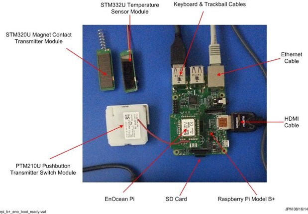

The RPi and EnOcean Pi were connected together. The SD Card was installed. The keyboard, trackball, Ethernet, and HDMI cables were all plugged into the RPi (see Figure 4).

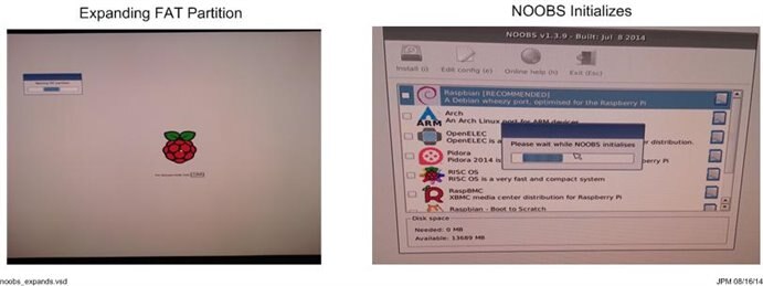

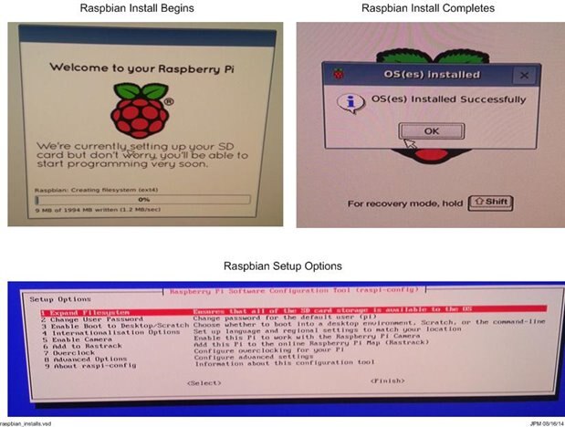

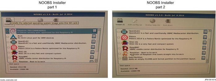

Power was applied and the input port selector on my monitor was switched to the input connected to the RPi. NOOBS started and began expanding the SD card FAT partition, and then it started to initialize (see Figure 5). The NOOBS initialization took a while, and after a long while I hit Esc. It’s not clear why this happened, but the follow-on installation worked without any further issues.
Figure 5
Figure 6 shows all the installation options in NOOBS. I selected and started the Raspian Linux instillation, as shown in Figure 6.
Figure 6
The installation completed successfully and the RPi rebooted, as shown in Figure 7. The RPi configuration tool runs on first boot and allows you to change your password, boot into the desktop, enable the camera, overclock the RPi, and configure advanced settings.
Figure 7
I selected the Expand Filesystem option and the configuration tool indicated that NOOBS had already expanded the file system. I used the advanced options to change the network name of the RPi Model B+ so it did not conflict with my RPi Model B. I finished the configuration and the RPi booted into Linux. I logged in using a monitor, key board, and trackball connected directly to the RPi using the default user name and password (pi, raspberry), and used the command

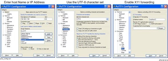

Remote Access

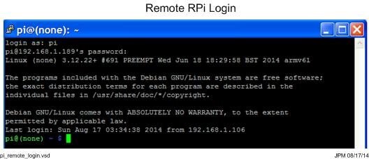

It’s really handy to remotely log into the RPi so that you don't need the monitor, keyboards, and mouse, and physical access is no longer necessary. To do this, I installed PuTTY, configured it, as shown in Figure 8, using the IP address for the RPi on my network, and open a connection to the RPi.
Figure 8
PuTTY will generate a security alert asking if this host is trusted. I selected Yes, and logged in. Figure 9 shows the remote login session and command prompt.
Figure 9

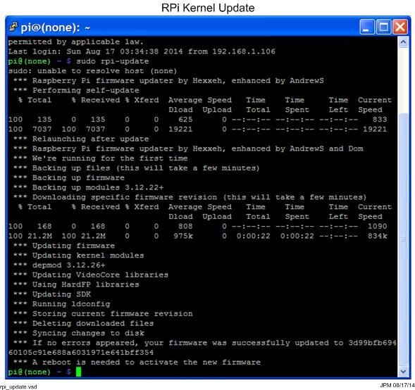

Updating the Kernel and Packages
Now the kernel and packages needed to be updated [4]. To update the kernel, I ran the command
sudo rpi-update
and the results are shown in Figure 10.
Figure 10

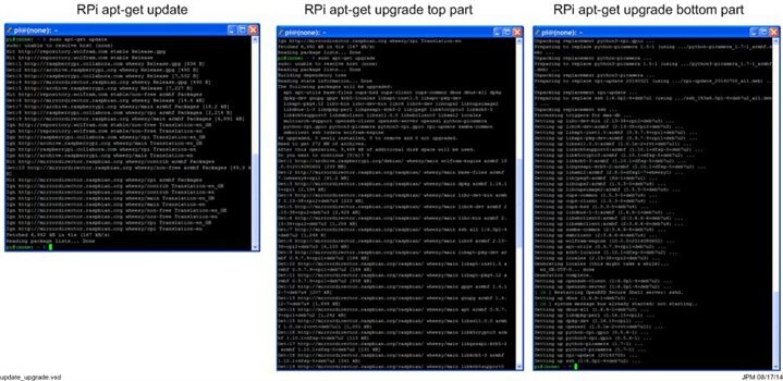

Next the packages were updated using the following commands
sudo apt-get update
sudo apt-get upgrade
Apt-get update looks for all packages that are out of date and makes a list of the packages that need to be updated. Apt-get upgrade does the actual package upgrades [5]. The results are shown in Figure 11.
Figure 11

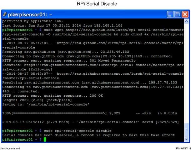

A script is needed to turn off the RPi serial connection as it interferes with the EnOcean Pi operation. The following commands [7] download and make the script executable. The script is downloaded using the wget command as shown below
sudo wget https://raw.github.com/lurch/rpi-serial-console/master/rpi-serial-console -O /usr/bin/rpi-serial-console && sudo chmod +x /usr/bin/rpi-serial-console
Then the command is executed the command and the results of this process can be seen in Figure 12.
sudo rpi-serial-console disable
Figure 12

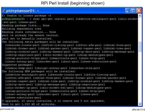

Next the Perl interpreter was installed and any broken links were repaired. The Perl install process can be seen in Figure 13.
sudo apt-get install perl libdevice-serialport-perl libio-socket-ssl-perl libwww-perl
sudo apt-get install -f
Figure 13

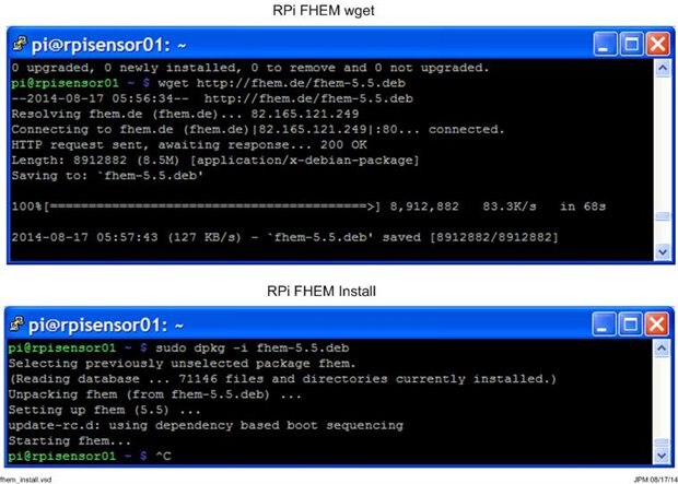

The FHEM package was downloaded using wget and installed. The wget and install process can be seen in Figure 14. BTW, FHEM is an acronym for Freundliche Hausautomatisierung und Energie Messung in German and it translates to: Friendly Home automation and Energy Measurement.
wget http://fhem.de/fhem-5.5.deb
sudo dpkg -i fhem-5.5.deb
Figure 14

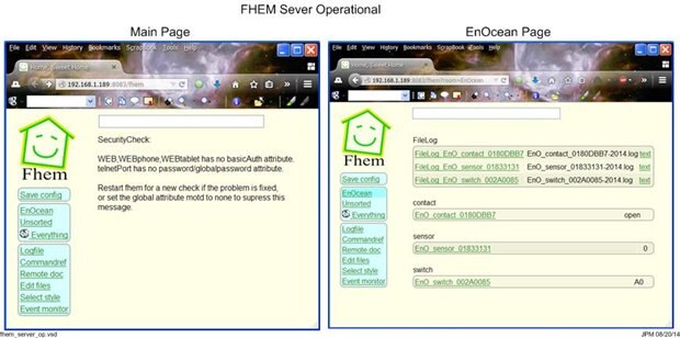

The FHEM server can be accessed using a browser using the following URL [8]. The FHEM server main and EnOcean page can be seen in Figure 15.
http://<Raspberry_Pi_IP>:8083/fhem (general case)
Figure 15

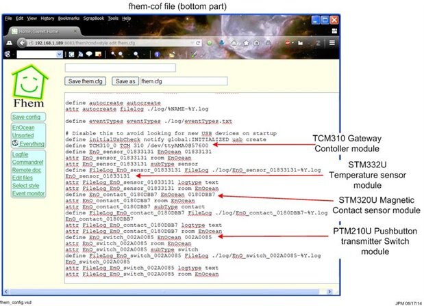

The FHEM server creates a configuration file automatically. The file can be inspected by going to the Edit files link and clicking the config file fhem.cfg. If it installed correctly, the following line should be in the configuration file near the bottom of the file
define TCM310_0 TCM 310 /dev/ttyAMA0@57600
Figure 16 shows more of the automatically generated module definitions and some pointers to lines defining the sensors it detected.
Figure 16

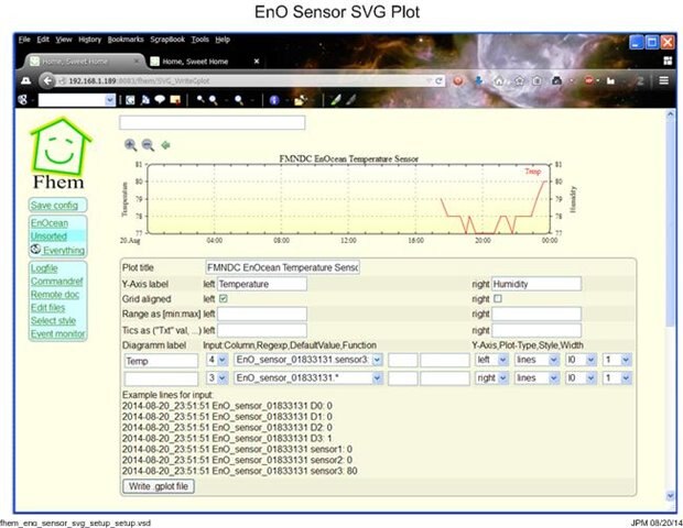

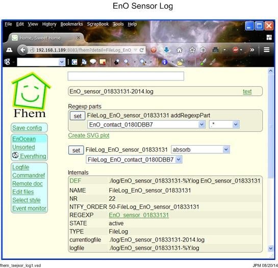

A temperature plot can be easily created by going to the Everything page (link on the left menu bar) and clicking on the FileLog_EnO_sensor_01833131 link for the temperature sensor. (This link is unique for each sensor.) The EnO_sensor_01833131-2014.log page opens (see Figure 17). Clinking on the Create SVG Plot link goes to a page that configures a plot (see Figure 18).
Figure 17
Figure 18 shows the plot created by adding FMNDC EnOcean Temperature Sensor to the Plot title, Temperature to the left Y-Axis label, Humidity to the right Y-Axis label, selecting the left Grid Alignment, Temp to the Diagram label, selected the EnO_sensor_01833131:sensor 3 for the plot function, and selected left for the Y-Axis.
Figure 18
Clicking the Save Configuration link writes the following lines to the fhem.cfg file
define SVG_FileLog_EnO_sensor_01833131_1 SVG FileLog_EnO_sensor_01833131:SVG_FileLog_EnO_sensor_01833131_1:CURRENT
My plot data disappeared as the date on the plot was Aug 21, so I used rasp-config and the International options to set my time zone to the Eastern US. My data re-appeared with the correct time and date.

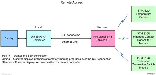

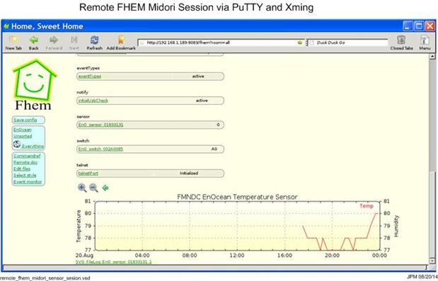

Xming Remote Access
Xming is a X server for Window that allows the graphics of a remote computer to be displayed on your local computer over a secure link established with PuTTY [9], [10], [11], [12]. In Figure 19, my Windows XP computer is the local computer and the RPi with the EnOcean Pi is the remote computer. PuTTY establishes a secure connection between my local computer and the remote RPi using Secure Shell (SSH). The X servers handle the task of generating all the graphics of the remote computer and displaying them on my local computer. Xming displays individual programs in individual windows and Xlaunch displays the entire remote desktop in a single window. Sometimes it's easy to forget which programs are running local or remote.
Figure 19
I installed Xming and selected to have Xming and Xlaunch icons placed on my desktop during this install.
Now with Xming running, I can run a browser on the RPi and see it on my local machine by entering the following command in the PuTTY session window
midori&
It takes a minute or two but it eventually pops up in a window on my local machine. The “&” causes midori to run in the background so you can still use the session window for other commands while the browser is running (a handy Linux feature). The RPi using its own browser can access the FHEM server using IP address as before

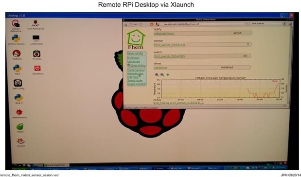

The RPi midori browser window on my local desktop shows the plot at the bottom of the Everything link (see Figure 20).
Figure 20
Xlaunch can be configured to display the entire remote RPi desktop on my local machine as well [13]. Follow the whaleygeek blog for instruction on setting up Xlaunch. Figure 21 shows the remote desktop on my local computer with midori open on the FHEM server Everything page showing the temperature plot.
Figure 21

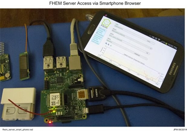

The power of such a small device still amazes me. Distributed and remote access to what is essentially a sensor server from anywhere in my network is just awesome (see Figure 22 for access from my smartphone).
Figure 22
