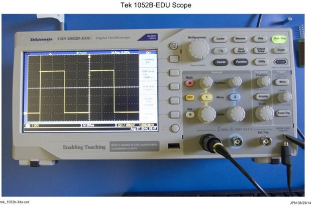

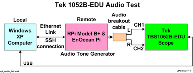

My new Tek TBS1052B-EDU scope arrived recently. To demonstrate some of the features of the new scope, I’ll measure audio signals generated by the Raspberry Pi (RPi). Figure 1 shows the test set. A Windows XP computer running PuTTY and Xming will be used to communicate and control the RPi. The audio output ports of the RPi will be connected to the scope using a breakout cable. A speaker test program running on the RPi will generate test tones that will be measured on the scope.
Figure 1
The Tek 1052B-EDU Oscilloscope is part of the education series of scopes comes from Tektronix and provides extra features for setting up and managing electronics labs for instructors. Several software packages are provided with the scope and include:

The TBS1052B-EDU is a dual channel 50 MHz oscilloscope with a 1.0 GS/Ss sample rate per channel. This input sensitivity ranges between 2 mV to 5/div and comes with two 50 MHz 10 MW 10x scope probes. It also has a nice large 7 inch color LCD display, and provides a lot of functions like time and amplitude cursors, math functions, and will show the FFT of the a signal [1] [2] [3]. Figure 2 shows the scope with channel 1 connected to the scope probe compensation signal.

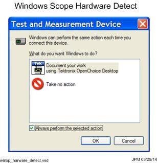

I did a full backup on my computer. I’ve had a VISA driver for a cheap serial port device crash my operating system in the past, so I’ve been cautious with VISA software ever since, even though this application was not involved. I installed OCD_2.4.0.1, which installed TekVISA, C++ and OpenChoice [5]. The install program asked me to install Adobe Acrobat Reader 10.0.1 and I said no because I use Acrobat Pro V9. I had some old NI VISA driver on my computer and let the install program replace these with the TekVISA drivers. The install program asked me if I want to read the ReadMe file and I said yes even with the warning that Acrobat was required. The read me file opened just fine with Acrobat Pro 9. I finished the TekVISA install without rebooting as instructed and allowed the install program it install tool bars into Word and Excel.
The OpenChoice Desktop icon appeared on my desktop, so I ran it and then plugged in the USB cable to the scope. The Windows new hardware program detected the scope by the correct model number, so I selected the Document your work using Tektronix OpenChoice Desktop option and checked the Always perform the selected action.
Figure 3

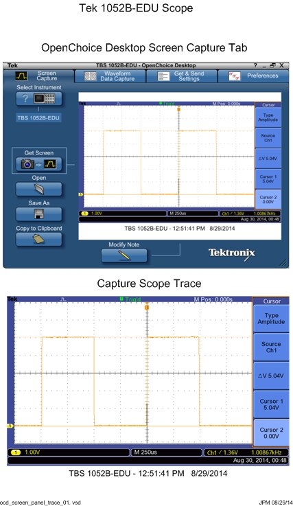

The top Figure 4 shows the Screen Capture tab and the bottom shows the captured trace of the scope compensation signal. The OCD software captures and saves the screen capture as a bit map image. The captured image is of good quality and resolution. I combined the images together and added the text using Visio and saved it as a JPEG (jpg) for this posting. The JPEG compression degrades the image too much so I saved it as a TIFF file format without compression. It’s still not as sharp as the original image, however.
Figure 4

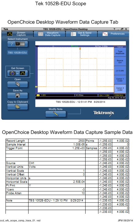

The top part of Figure 5 shows the Waveform Data Capture tab and the bottom part shows the beginning of the CSV file generated by the program.
Figure 5

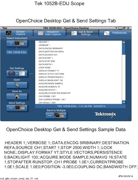

The top part of Figure 6 shows the Get & Send Tab and the bottom part shows beginning of the file saved by the program. The setting of the scope for different tests can easily be saved and restored as needed.

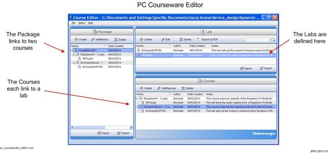

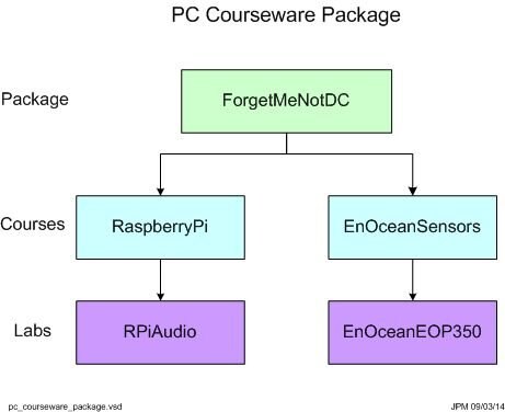

The PC Courseware software lets an instructor create and manage courses very easily. The package links the courses together along with their associated labs. Figure 8 shows an example package I would like to create. The package will have two courses on the RaspberryPi and the EnOceanSensors. The titles of the courses are based on the requirements of the software (no special characters and the length is limited). The RaspberryPi course has one lab called the RPIAudio, and the EnOceanSensors course has one lab called the EnOceanEOP350. New labs and courses may be added to the package as they are developed.
Figure 8
Figure 9 shows the Package, Course, and Lab setup.
Figure 9

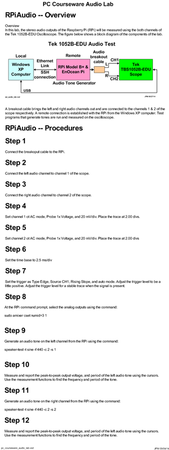

So then I created the RPiAudio Lab using the editing features of the software. Figure 10 shows the lab that was generated from the export PDF. The lab editor converts all images to display them as they would be seen on the scope. If the image, such the block diagram in this case, does not display well when pasted in the editor, then they will not display well on the scope either. It took me two or three tries to get a good looking block diagram. Converting block diagrams to JPEGs does not work well as the compression removes too much information. I used PNG files that do not compress the image. Lines need to be thickened and text needs to be 14 pt bold to display well.

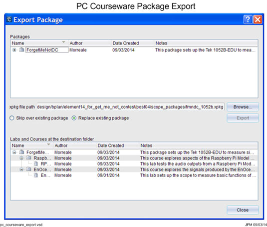

I exported the whole package even though only one lab was produced (see Figure 11).
Figure 11
The export package files were copied to a USB drive and placed in the scope. The Utlities -> more -> Update Course function was selected with the fmndc_1052b.xpkg file selected. After a short time, the course was imported into the scope. Then I selected the Course -> RaspberryPi ->RPiAudio lab. The Overview shows up on the scope (see Figure 12) along with the procedures. Every procedure step allows the student to make a measurement and capture data.

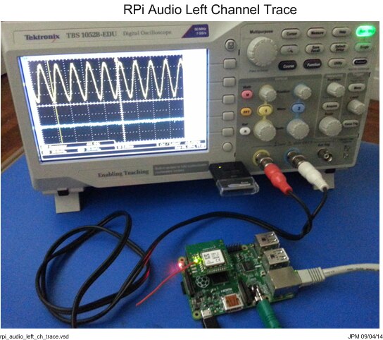

Figure 13 shows the RPi audio output connected directly to the scope, and a left channel audio tone of 440 Hz being measured on the scope. The frequency function measures the frequency at 444 Hz and the cursors show the output is 65.5 mV peak-to-peak.
