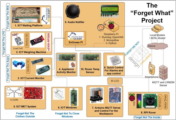

The system as of right now looks like this.
A short list of technologies used is as follows:

RPi and OpenHAB
The center piece is the RPi which has OpenHAB running on it. Additionally, I am running Mosquittoe and some bash and Python scripts running for some things. I wanted it to be compact and preferred a headless system so I used the PiFaceCAD and made startup and shutdown scripts for the OS as well as OpenHAB. I soldered the Enocean Pi via 4 wires to the RPi itself and it works just fine. The casing is a long story and well I will post pics at the end of the competition. I tested and am using the following bindings:
  1. EnOcean (Duh!)
  2. MQTT
  3. Exec
  4. NMA
  5. Serial
  6. my.OpenHAB
The system can be accessed via my tablet and phone from anywhere in the world. The system acts like a data aggregator which prevents local data to be un-necessarily be routed over the internet. This just might save the internet world if there are 50billion of theses image
In addition to the EnOcean Pi, I have the EZ430 unit connected via USB. Thats it. The rest happens elsewhere. Oh! One last thing- I have USB Powered Speakers connected. I could have bought a Class D amplifier and I also could have made the CKT myself but it seemed counter productive so I just used bought outs- the cheapest ones I could find. image
