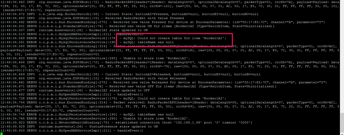

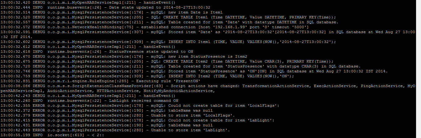

I struggled with getting persistence to work on the RPi and it simply did not work. I tried the MySQL approach but OpenHAB just did not post values as expected. I got the following on the console.
It did work some times but it seemed temperamental and I was not interested in fiddling around more than I already had. All I want is some graphs of temperatures and other things. I might try setting up MySQL elsewhere and then try connecting it from the RPi but I don't need that right now. I already have an MQTT broker, Samba and SSH running so if I can do without MySQL, I would be better off. Additionally, the MySQL database can grow with time which will needs to be maintained. If I plan this to be an independent device, I would much rather have a database else where. MySQL not now...

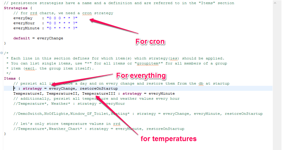

I opted for RRd4J which is a Round Robin Database for Java. The upside is that it stores everything in a file and with time, it discards intermediate samples so that the database gets compressed. I wont need temperature for every minute from 10 months ago. For that I would have a database elsewhere. The second upside is that OpenHAB uses it to create graphs anyways. There is a downside as well. It cannot be queried like a standard database. But I'm OK with that. I started by downloading the add-on for RRD4J. I then created a persist file that looked like this.
The strategies are basically names given to cron arguments. The items section tells us what to store and when. Now with time, you can add a lot of things to the database and you can use a wildcard (*) to store everything, but I would rather add individual items. For buttons, I used the 'onChange' strategy so that it gets saved only when there is a click. Honestly, I won't need em but hey, why not. The next is my temperatures. Now people would use onChange here as well but then how would you plot em if the temperature never changed through the night? Instead I choose the everyMinute and onChange strategy. The EnOcean modules by default, will send significant changes after 100 seconds which can be changed by pins or via software. I will get to that in a different blog, but right now the focus is persistence. For RRD4J, you do not need to set permissions, access control etc. At this point we are basically done. The RRD4J is setup and will save data in files as per strategy.

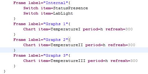

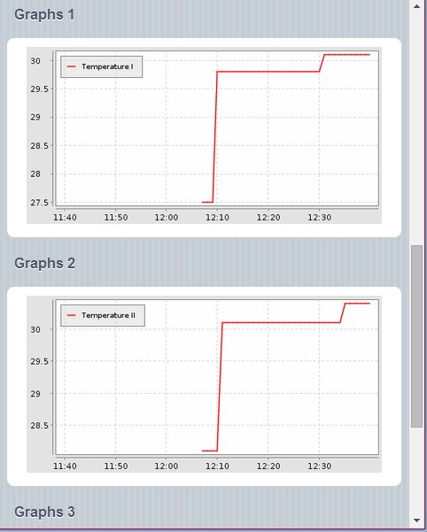

The Output
Now to display these things. The simplest thing to do would be to plot something. For that, my sitemap and output looks like....

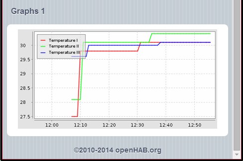

Combining Plots

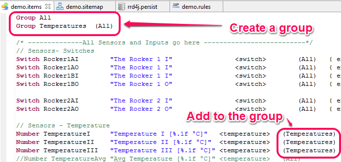

Here I have plotted the graph individually. I have three temperature sensors so I would rather plot them all together. To do that we need to change the Items file and make the temperatures part of a group. First we define a group and add the temperature variables to that group.
Items File
Modified Site Map
Next we can simple plot the entire group instead of individual items. Simple.

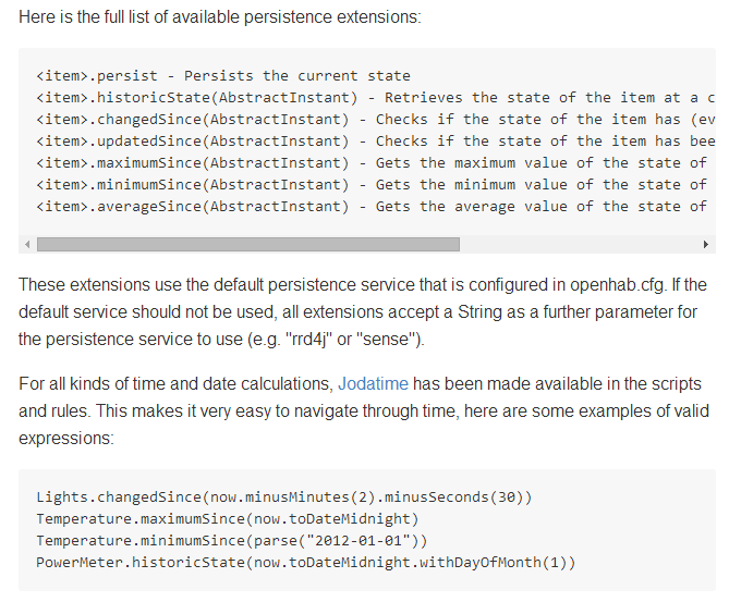

Next I would like to measure the average, maximum and minimum temperatures... For that we add another variable to the items. Below the three number items add the following...
Number TempAvg  "Avg Temperature [%.1f °C]" <temperature> (Temperatures)
This is where we can store the average temperature. Next we need to calculate the average temperature. We can simply do that using the in build functions. I found a list at the wiki.
https://github.com/openhab/openhab/wiki/Persistence
I use the following rule
rule "Calculate Average I"
when
  Item TemperatureI changed
then
  var temp = TemperatureI.averageSince(now.minusHours(4))
  postUpdate(TempAvgI, temp)
end
You can do a multitude of things using persistence and the in built functions. I will be looking at thresholds. My requirement is to use rules in thresholds to generate notifications and alarms. Here is a scenario.
